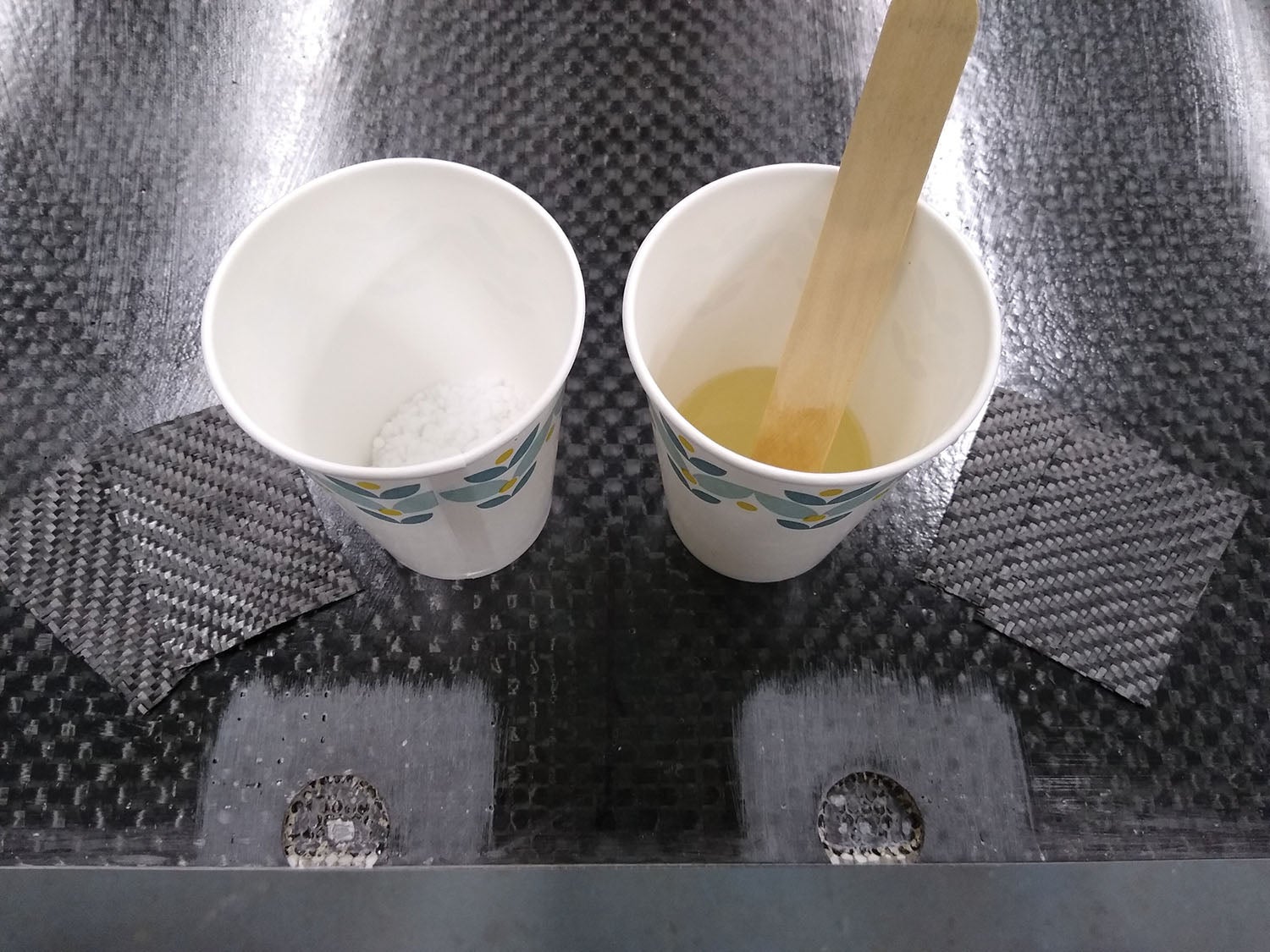

Photo 4: Scuff sand around each hardpoint, prepare the face ply patches and mix the epoxy.
Scuff sand the area around each hardpoint in preparation for bonding. Prepare new face ply patches. As a practical rule of thumb, make them three times the open hole diameter. When the area is prepped and the new plies are ready, mix a small quantity of epoxy. Pour off a little bit of it into another cup and mix it with flox to form a stiff paste (Photo 4).

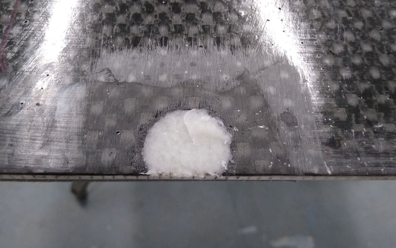

Use your mixing stick to add flox/epoxy paste to the hardpoint. Butter it full and flush with the surface (Photo 5).
hardpoints composite core 05
Photo 5: Use a mixing stick to add flox/epoxy paste to the hardpoint. Make it flush with the surface.

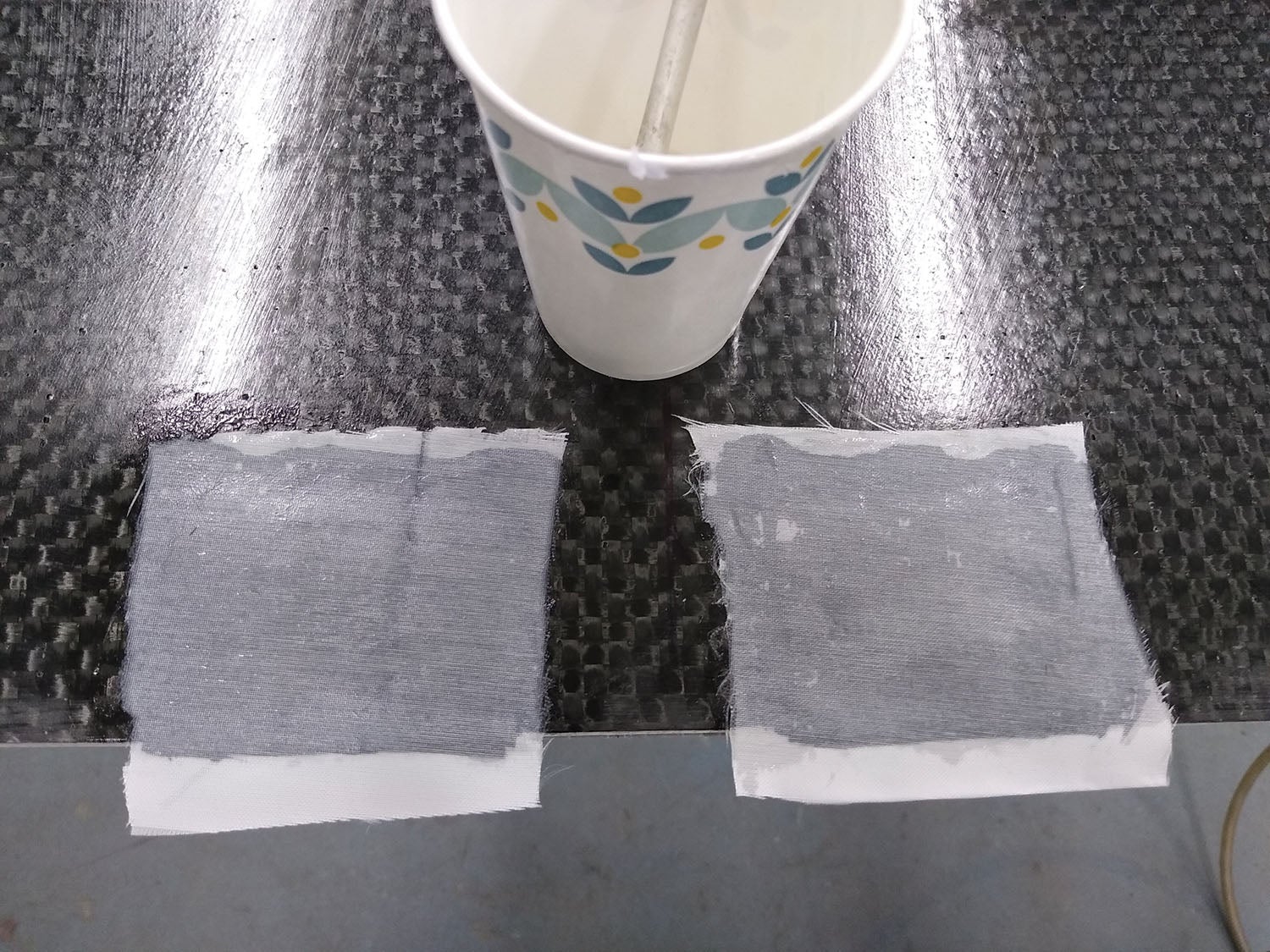

Immediately, while the flox is wet, add the fabric cover ply patches and wet them with neat epoxy as you would any other layup. Add a small peel ply patch to the top of the layup if desired (Photo 6). Peel ply (ordinary dacron aircraft fabric works fine) will soak up excess epoxy while fairing the edges of the cover plies to the underlying surface.

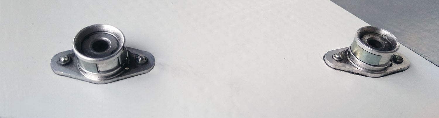

Later, after the epoxy is fully cured, rip off the peel ply (Photo 7). The fracture surface is bond ready, although you may wish to sand a bit to smooth the edges. Again jig the panel to the airframe, redrill the fastener hole(s) and add nutplates or 1/4-turn sockets where needed. If desired, sand smooth and wet the surface with a thin epoxy coat to restore clarity, allowing the underlying fabric pattern to be seen.
hardpoints composite core 06
Photo 6: While the flox is wet, add the fabric cover ply patches. Then add peel ply.
If the hardpoint will form the base for a K1000 nut plate riveted near the edge of a cored panel, hollow out the core by working in from that edge. Bend the tip of a junk screwdriver into a hook, and grind it to the same width as the core. Use it to rake the core from between the face plies, then fill the open space with flox/epoxy mix.
