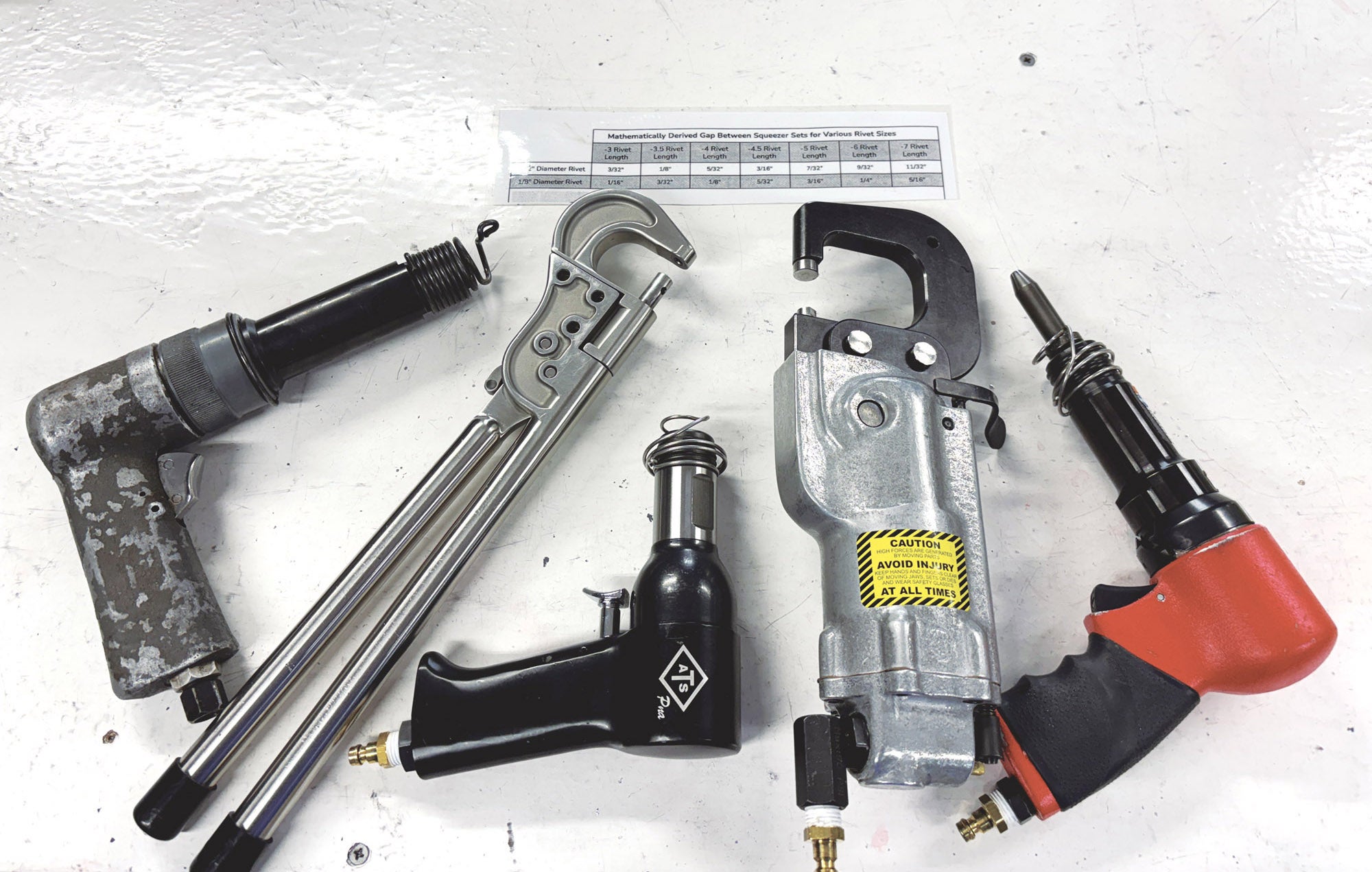

Tools required - Rivet guns and squeezers
For most kits a 2X and a 3X rivet gun are as big as you need. The hand squeezer works well for small items. You can borrow larger guns when the task requires.

Rivet guide
For those of you just starting to rivet, a rivet guide is a good tool to help you check the rivet for proper setting. After a few thousand rivets, you can usually eyeball them but I do still check them periodically myself.

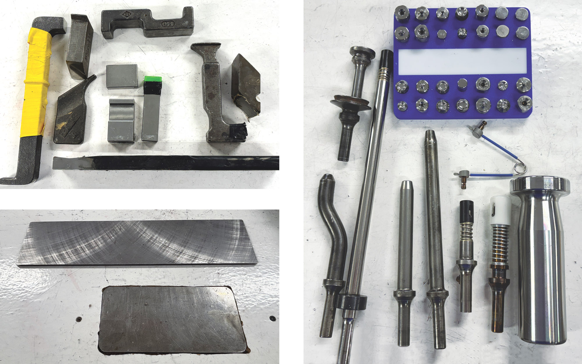

Collections of bucking bars and back plates for rievting.
You can never have enough of the right shanks or bucking bars (top left). It helps to have the blue organizer cradle for all of the various sizes of cutters and dimple dies (right). Backing plates (for back riveting) are useful (left).

deburring tools
One of the most repetitive tasks is the need to deburr all the cut edges and drilled holes. Just like the bucking bars, you will need various sizes and shapes to effectively deburr everything. Emery cloth works well, too.

Over the course of building the various aircraft, it is my opinion that the metal ones require the most tools, especially regarding sheet metal working. Sure, it’s easy to understand that you are going to need a good selection of countersink cutters, dimple dies and drill bits for all the various sizes of holes. But I think I have yet to build one where I didn’t need a bucking bar or rivet shank different from what I have!
There’s always that one rivet that looks great on the engineering drawing, but trying to set it is a whole different adventure. I’m sure modern auto mechanics could sympathize. For those types of situations, it doesn’t hurt to ask previous builders how they solved it, and you might be surprised to discover some tool that gets passed around for just that application. It sure beats struggling with it and perhaps even doing damage trying to set it yourself.
Sometimes it is OK to buy a cheap tool because for some of these one-off situations the solution is to modify a tool, often permanently destroying it. I assure you that over time you will end up with a drawer full of modified tools. I find Harbor Freight tools fit this requirement very well, as I don’t cringe as much as when I am taking a torch or a cutter to an expensive tool. I also find the creativity of some of our builders to be outstanding when it comes to modifying tools. I bet many of you have some pictures you might share with us as well!
