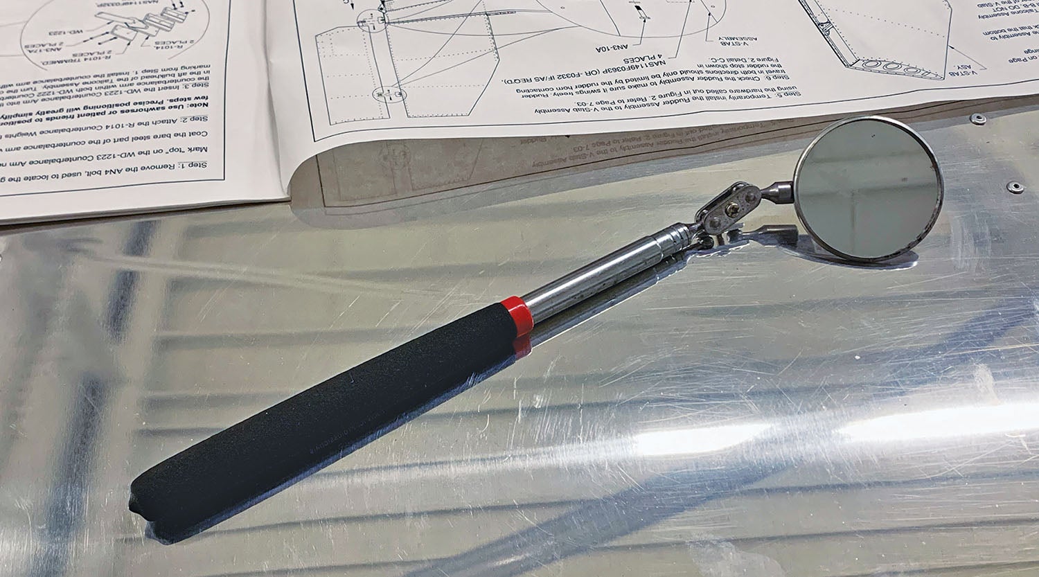

insp mirror
Eventually, you’ll make good use of an inspection mirror to get a look at contact pins and other stuff you can’t easily see.
And because at some point you’ll be lying on your back and standing on your head learning how to be both a contortionist and avionics troubleshooter, pick up a handheld telescoping lighted inspection mirror. The $15 investment will pay back big-time as you struggle to read the back of the connectors (upside down and backward) after the equipment is mounted in the aircraft. Oh, and for times when you drop that screw or other small metal object into the bowels of the airframe, have a telescoping magnet stick to help fetch it.

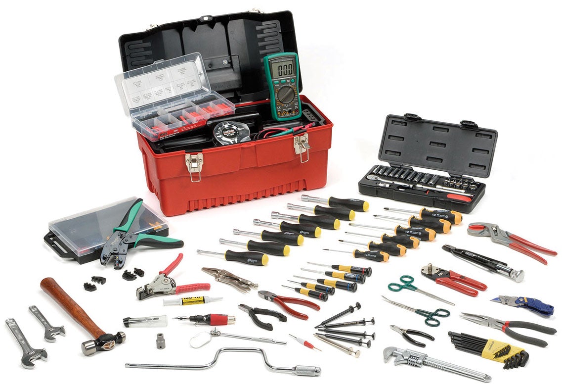

Spruce Avionics Maintenance Kit SMALL
At just under $1000, the Avionics Maintenance Kit is good for starters, but you’ll still need more stuff, including crimpers. Pro tip: Pay more for good tools you use every day.
Prefab Avionics Kits
To take stock of the wide variety of hand tools and accessories that will come in handy for avionics work, check out some prepackaged kits aimed at avionics installers. For example, I found a couple at Aircraft Spruce, including the $914 Avionics Maintenance Kit. It’s loaded with all kinds of useful stuff that could reduce the overwhelming chore of sourcing some tools individually. Even if you prefer to buy the tools separately, prepackaged kits can be a good backstop for remembering stuff that you’ll likely make good use of. Yes, Snap-on Tools still sets a high standard for quality and replacement support, and you’ll pay dearly, but there are other high-quality choices. You likely have formed your own opinion on a brand line, and it’s tough to argue that when it comes to hand tools, you generally get what you pay for.

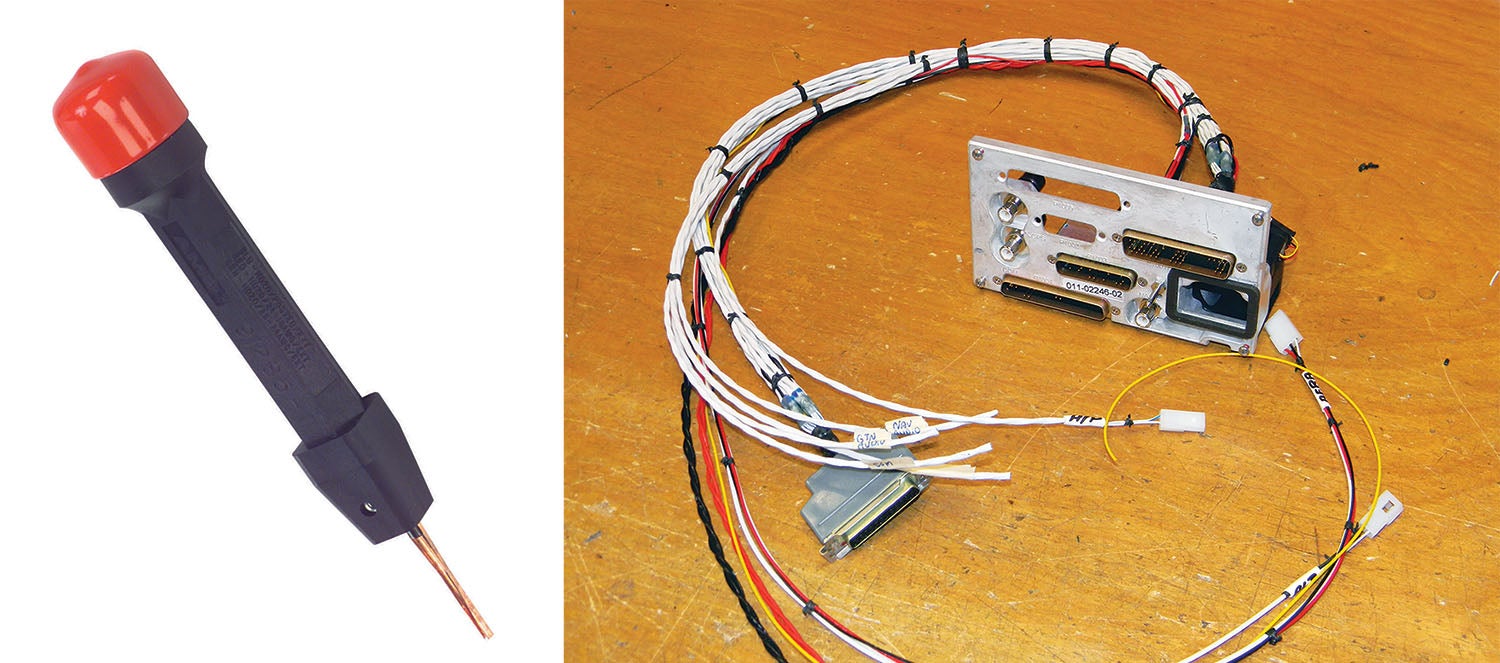

Extraction tool
Even basic wiring jobs will have you reaching for contact-pin extraction tools (above). They’re inexpensive and come in various types (color designations) depending on the pins you’re working on. These D-sub connectors (right) require a tool for pin extraction.
The moderately priced Spruce kit includes a 19-inch toolbox, a 13-piece Allen wrench set, 8-inch needlenose pliers, diagonal cutters (extremely important), six-piece screwdriver kit, Vise-Grip pliers, safety wire pliers (don’t forget the safety wire), a five-piece mini screwdriver kit (which you’ll definitely use at some point), a butane soldering iron and soldering paste, adjustable wrench, Cannon plug pliers, Apex bit holder, an inspection mirror, five-piece pin extractor set, an automatic wire stripper, a D-sub closed-barrel crimping tool, a pin insertion/extractor tool, two 6-inch forceps (straight and curved), a 20-amp multimeter, mini Vampliers, a ball-peen hammer, a seven-piece nut driver set and a folding utility knife.
I like that the Spruce kit has various contact pin insertion/removal tools. These inexpensive tools (plastic body and metal tips) are necessary for extracting a broken pin or removing or moving a mis-installed pin in the connector. The tools are color-coded based on the gauge of the pins they work with, either high-density or low-density pins.

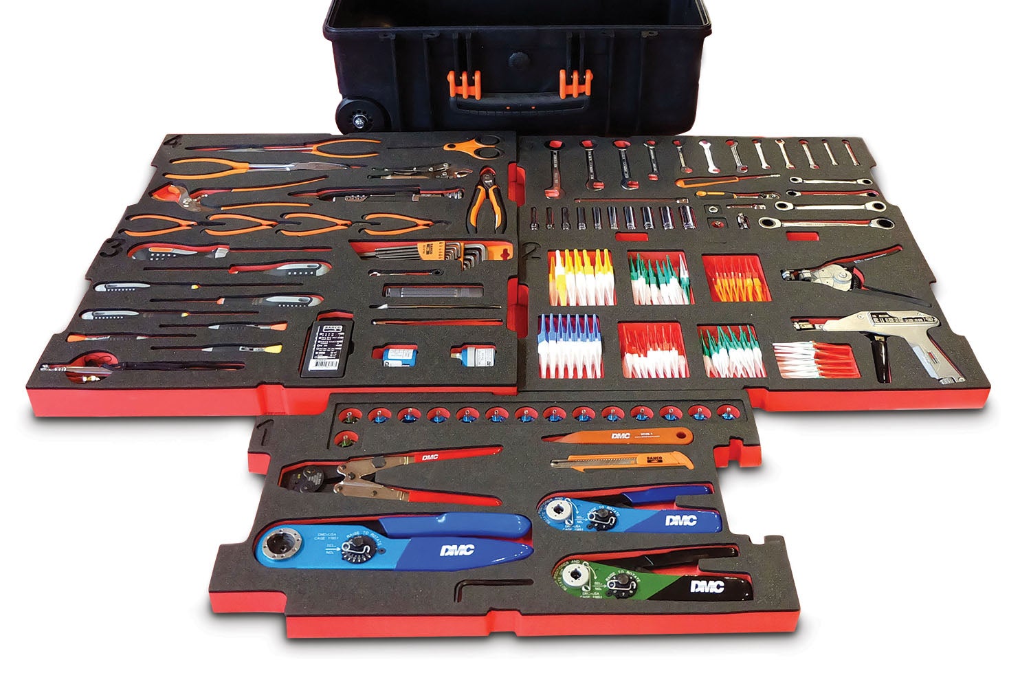

When it comes to the nitty-gritty of building those harnesses, you’ll need a good crimping tool, and the longtime go-to is the eight-impression Daniels AF8, or “Big Blue Crimper.” It’s not cheap at around $400 plus turret heads, but there are over 1000 heads available to make it work with a variety of crimps and closed-barrel contacts. Used properly, this ratcheting crimp tool is the best way to get consistent, perfect crimps every time. Our own Paul Dye says, “Someone can have my DMC after they pry it from my cold, dead hands.” Works good, and D-sub crimps last a long time.
And while you’re stocking that drawer, get a good pair of wire strippers (Aircraft Spruce has a wide variety), plus a high-quality cutting tool. My ancient Snap-on diagonal cutter is almost my favorite tool in the box. But be careful with that precision Snap-on cutting head and resist clipping tie wraps and other tough surfaces that can damage the tip.
DMC BIG BLUE
You’ll pay a premium, but the MIL-Spec Daniels Manufacturing Big Blue Crimper tool is extremely versatile and made to high standards.

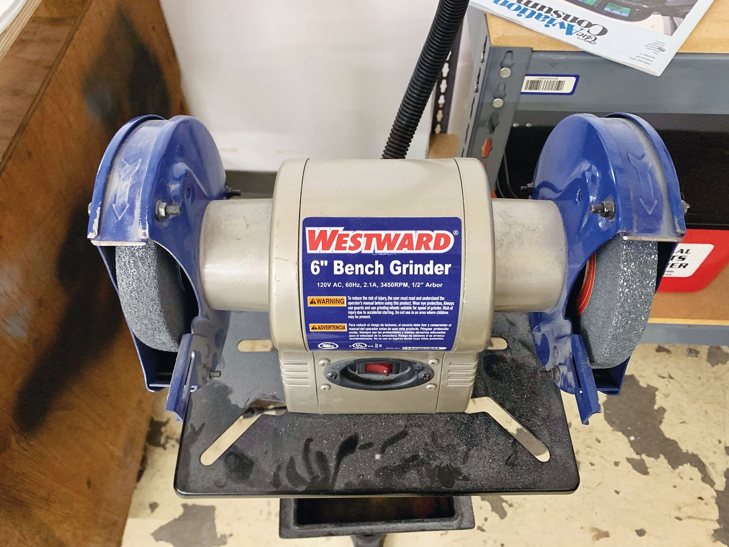

Bench grinder
Avionics work isn’t all about wiring; you’ll be doing some metal work, too. Add a bench grinder to your shop setup. This Westward is available from Grainger for around $110.
And because avionics projects inevitably include at least some metalwork, especially for antennas and work on the instrument panel, stock a variety of metal filing tools, a Dremel tool with cutoff wheels, and some “pop” rivets, Cleco tools and solid rivets. If you’re building a metal airplane, you’ll surely have plenty of the latter (and you’ll likely never want to see them ever again once you’re done). Don’t overlook bigger tools—including a bench grinder—when you need to make some crude modifications to the hardware.
