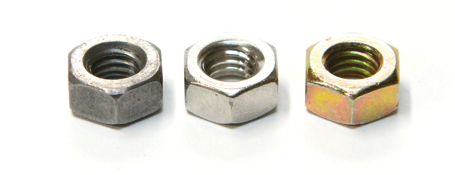

Muriatic Acid, at pool “service” concentration, can be used to “dissolve” most commercial forms of plating – Cadmium being the most widely used. Removing the plating does two things for the weld & welder. For the weld, it removes the contaminants that interfere with weld quality & integrity. For the welder it removes the toxic fumes developed when the plating is heated from the weld process. The only caveat in using the acid to remove the plating is the fume of the acid itself – a little bit upwind and a little separation will remove most of the exposure, and the acid, at that concentration, isn’t very aggressive on skin from accidental contact. Just put the washers, nuts or ? in a open container, pour the acid over (a little foaming) them until covered – when the bubbles stop (effervescing completed), return the acid to its container and rinse the parts with water to stop the process.
