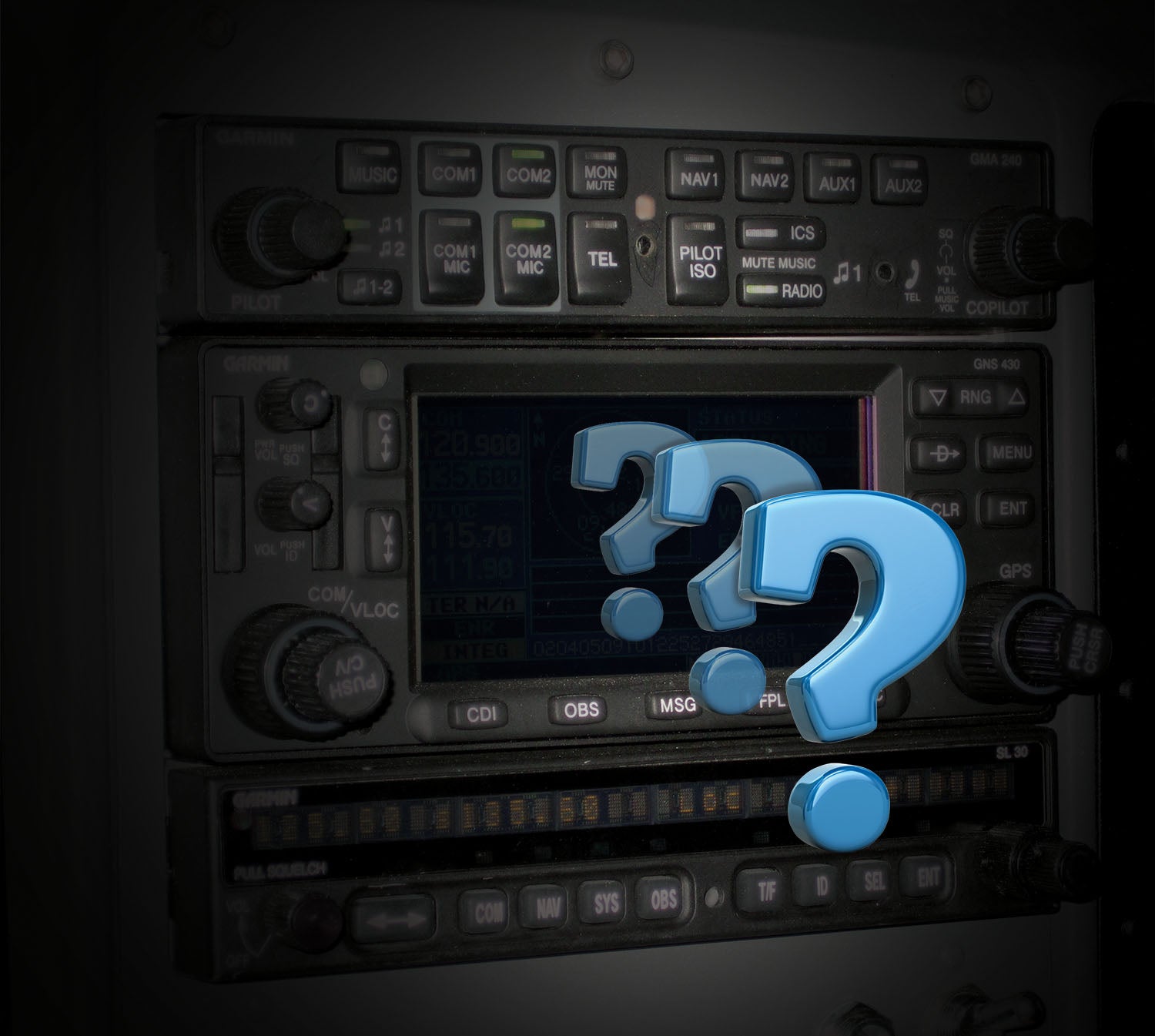

Technologies develop, sometimes slowly over time, with the kind of sloth that makes you wake up one day, see an evolved landscape, and question your strongly held beliefs. Such as: For any airplane you’d consider flying in instrument conditions, at least a modicum of redundancy is required. We used to want fully distributed systems to back up our electronics, but now we accept a certain degree of internal redundancy because the technology is so mature.
And now builders of Experimentals are grappling with this: Thanks to the proliferation of GPS approaches and the high quality (read: reliability) of GPS navigators on board, can we simply do without the VHF nav portion for IFR flying? Doing so means you can’t tune in a VOR, or fly a localizer or ILS approach natively. With an IFR-approved GPS you can, of course, fly many of the same procedures with, some would argue, better accuracy and greater smoothness in the signal. And, obviously, omitting a VHF nav receiver can save money and installation time, though you’d be wise to up your game on the GPS side if it’s your main navigation source. Truth is, though, you probably have multiple GPS sources on the airplane, some serving as part of your ADS-B In data path.
But does it make sense? We asked around “the office” for opinions. Not surprisingly, our staffers and correspondents were only too eager to oblige.
