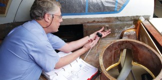

And a good thing, too. I’d been in contact with some other Jabiru builders and was cautioned that where the directions say to drill for a gas cap is too far forward; you’ll take a nice notch out of the wingspar. So I carefully measured the position for the hole and then did as Don French suggested, “Darken the workshop, and put a really bright light under the wing; you’ll see everything.” He was right. I saw that my layout would have cut right into the mainspar!
I moved the hole about a half-inch aft and met with only partial success; the fuel tank has a curved upper edge, so I was not fully onto the flat as I should have been. A judicious packing of flox was sufficient to rectify the problem.

The ring into which the cap fits has to be grounded as well. The wings are non-conductive, so you have to add a ground by running a 6-foot-long vent tube from the wingroot, through the wing/tank, out to the cap ring, and then attach that tube to the cap ring. That stub of tube at the wingroot is then connected to tubing that you run down to the header tank under the right seat. While you’re at it, run a ground wire from the tube stub on a parallel path, but take it all the way to the engine. Reaching through the gas cap to start a screw is a little tough, but it seems to be a good system. It’s easier than it sounds. You now have a vented and grounded fuel tank—on one wing. Do it to the other wing, too.
