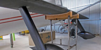

The gear legs are easy to install with the holes in the fuselage already drilled. The wheels and brakes went on readily through match-drilled holes. This is fun! Oddly, the nosegear is not on it and the instructions say to turn it over, wheels down. Well, that’s simple! This plastic tadpole almost rolls over as it is.
Put a brace under the nose, and it looks pretty good. Put a brace under the tail while you’re at it, though. Some knucklehead is sure to climb in that big back area and get a surprise…No, I am not that knucklehead.
That’s weird. The gear legs are curved too much. The last time I saw something that bowlegged under an airplane it was a bomb rack! The addition of a 5/8-inch spacer under the centerline mount point spread them a bit, but it was insufficient to put the tires perpendicular to the hangar floor. Perhaps they’ll spread with the addition of the engine, wings, systems and the pilot. We’ll see.
