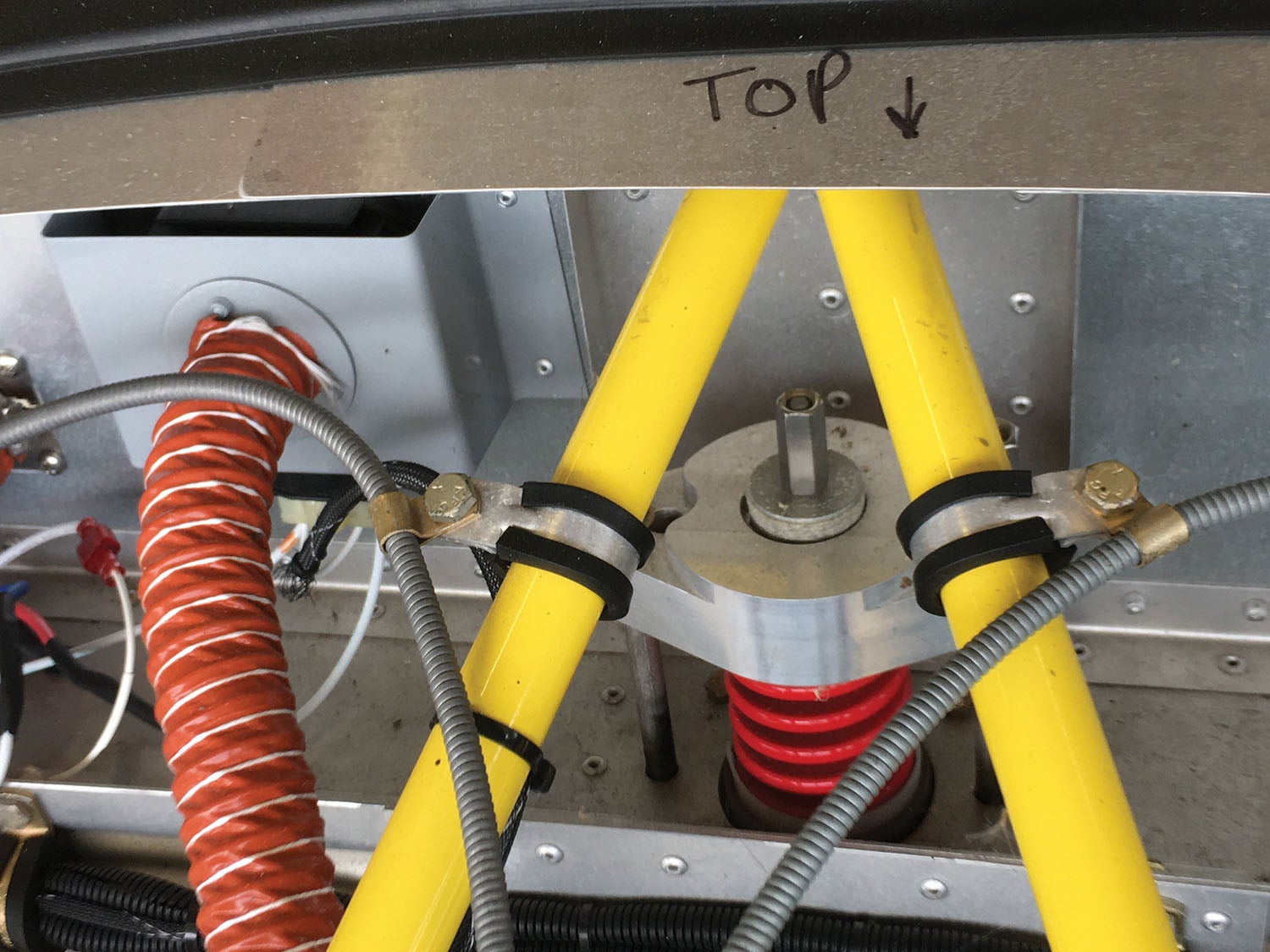

By bolting Adel clamps back to back, they provide unlimited abilities to secure a wide range of components.
There is so much to learn by simply observing the handiwork of others. Some builders are just plain creative when it comes to organizing the myriad parts and pieces we need to install in the engine compartment: wires, hoses, cables, sensors to name a few. We will look at the creative use of Adel clamps by a fellow builder that were used to organize components forward of the firewall.
Adel clamps—more properly called MS21919 aircraft clamps—are commonly used to support bundles of cables and other components. You may also hear them referred to as “cushion clamps” due to the soft material that surrounds the inner metallic strap. This soft surrounding material may be made of a rubber or silicone material. The inner band may be made of steel or aluminum.

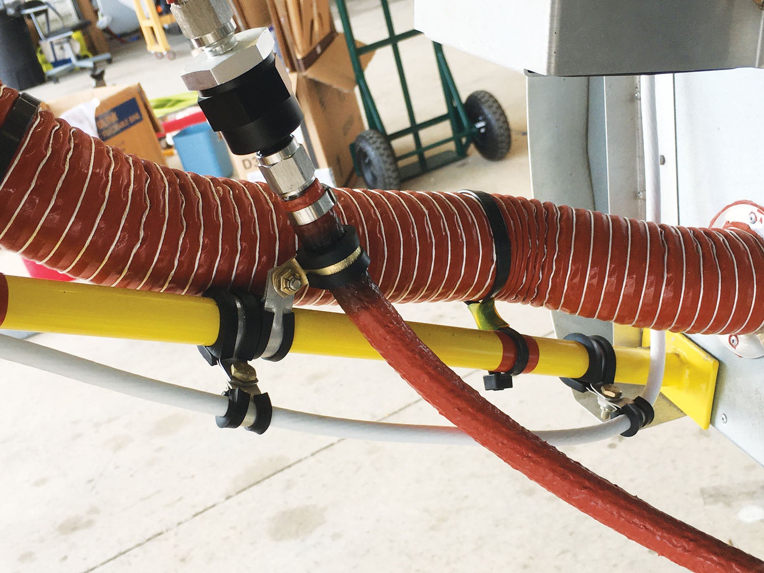

Note how this oil pressure sending unit is held securely in a remote location with an Adel clamp.

Note the technique of “doubling up” a pair of clamps, connecting end to end to produce a flexible standoff device. One clamp is sized to fit an engine mount tube, for example. The other clamp, sharing the same securing nut and screw, is sized and used to hold the wire bundle (or hose or cable). This technique can be used to robustly support the most difficult to mount items such as fuel filters, oil pressure sensors and other electronic sensors. Since the aircraft’s engine mount is generally built from rigid metal tubes, the Adel clamp is naturally suited to making a strong attachment at any location and offering a flexible mounting point for accessories.

This mounting plate is attached to the engine mount with four Adel clamps.
