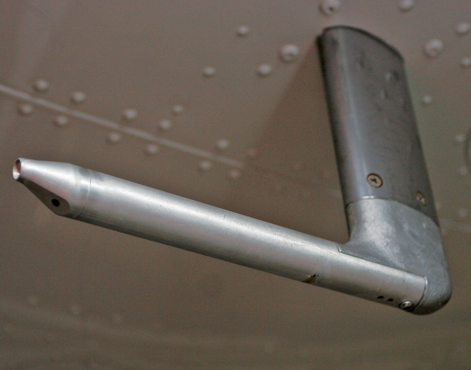

Before we start an electro-whizzie tab, I would like to make one very strong suggestion for builders. If your masterpiece has a self-generating electrical system, install a heated pitot tube, learn its operation, and get in the habit of using it correctly. Even the most fair weather of flyers can get caught in some unexpected precipitation at just the wrong temperature to portend disaster. Just the thought process of its use and addition to your checklists can help keep you seen for years to come rather than viewed for a couple of hours one evening.

ifr prep heated pitot 1
A properly used heated pitot provides a lot of value for the money. Even fair-weather flyers can get caught in unexpected precipitation at just the wrong temperature.
