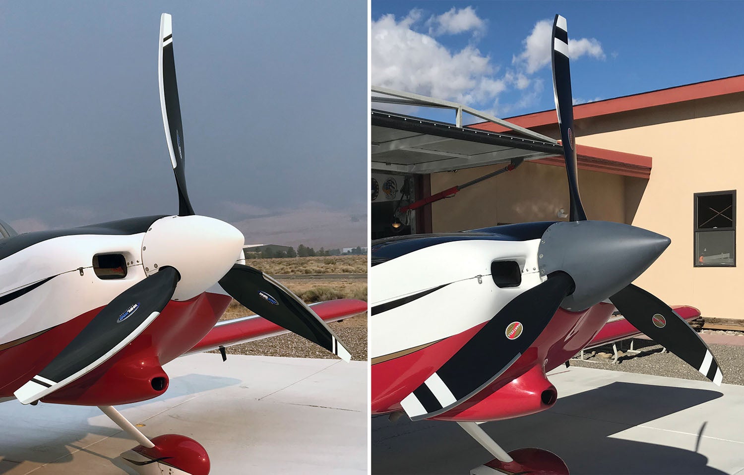

whirlwind vs hartzell 02
Editor’s Note: It’s not common we get to test similar products in closely controlled conditions, and it’s also not common that we get to test similar products from basically dissimilar companies. Here we have two modern three-blade propellers that Editor at Large Paul Dye was able to test on his RV-8 over the course of a few months, with one prop coming from industry stalwart Hartzell and the other from Whirl Wind Propellers, a company well known in the Experimental world. Whirl Wind’s Jim Rust and his company have been working for decades refining composite-blade props for Experimental aircraft (among other applications).
Paul is open to trying a lot of things, and our benefit is that he has lots of time on his RV-8, and extensive data from it using a more conventional aluminum blended-airfoil (BA) Hartzell two-blade prop. Another benefit is that his RV-8 is powered by a standard-issue O-360 Lycoming clone, meaning the comparative data we get here could stand in for a lot of engine/airframe combinations.
Last year, Whirl Wind asked if Paul would like to test the latest three-blade, and we published the results in the January issue. It offered the expected improvements in takeoff and climb, but failed to render the usual reduction in cruise speed you see when adding a third blade.Hartzell, for its part, has been developing new composite-blade props into the certified market and has created several iterations, from bush-oriented low-speed props to those intended for faster aircraft. The new Explorer prop was just out when Hartzell asked if Paul would like to test it as well. So what was never really intended to be a prop “shootout” ended up being a very interesting look at prop-performance data. I’ll let Paul pick up the story from here.

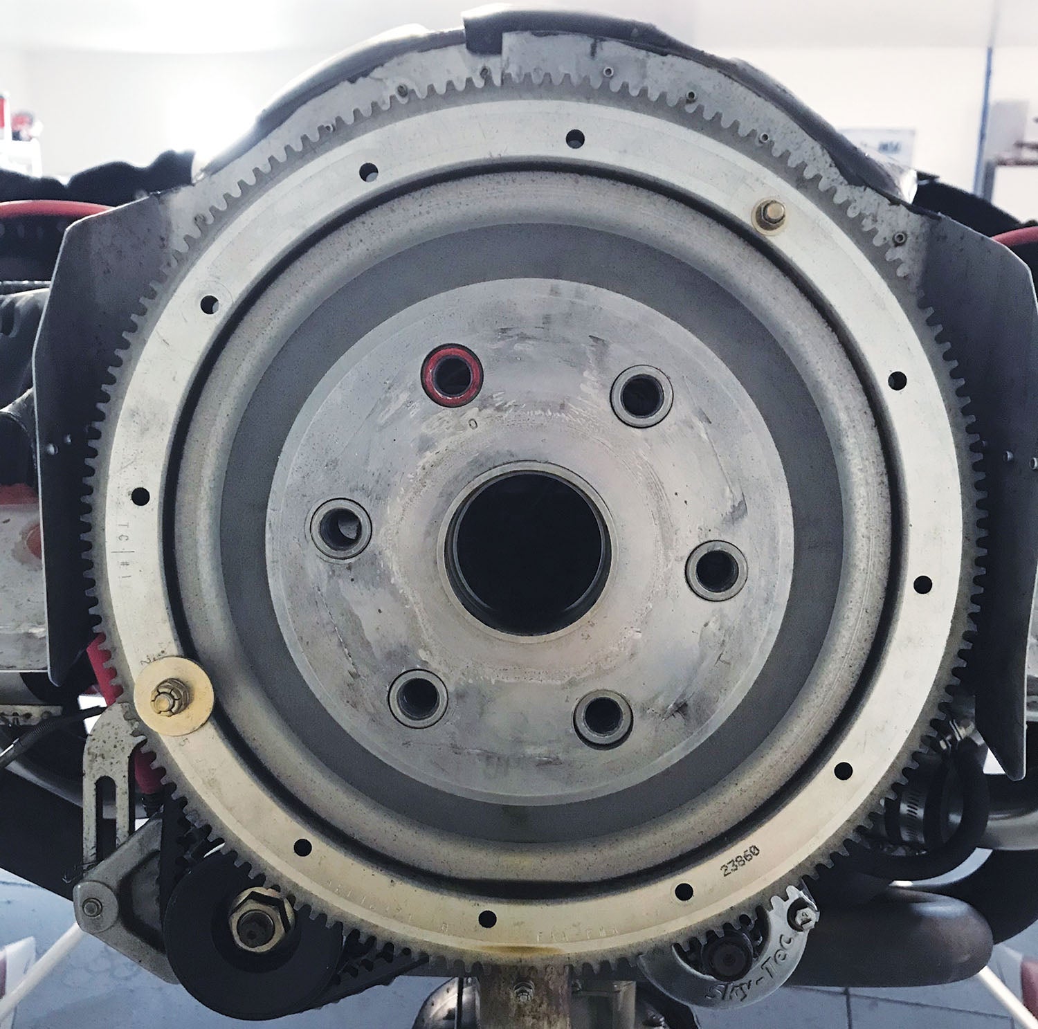

whirlwind vs hartzell 08
When installing a constant-speed prop, you need to make sure to line up the index bolt with the “O” lug on the crankshaft—we like to color that red to make it stand out.
