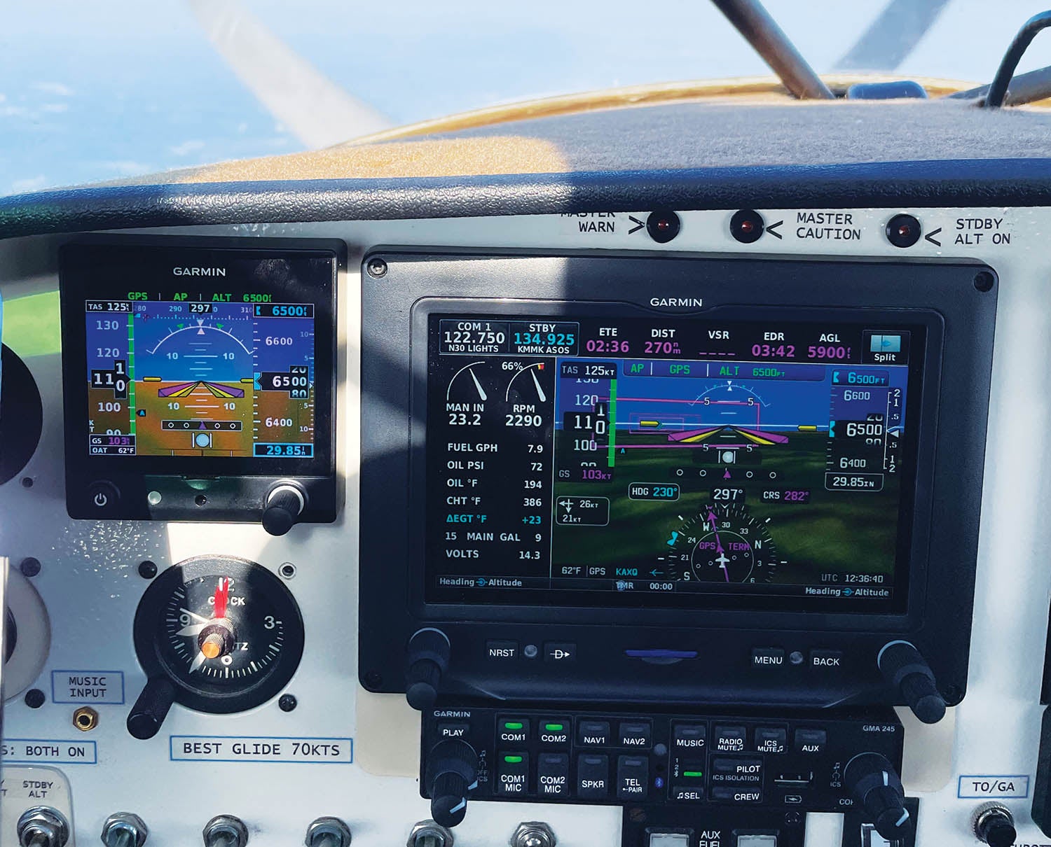

Let’s start with the good. I’m an electric fanboy. I drive electric cars and I feel much more comfortable flying with dual alternators than I ever did with a vacuum pump. After having one fail in IMC, I couldn’t wait to be rid of it. It took a while to retrain my brain, but I love the presentation on the EFIS. I think it’s much easier to scan and understand, and that big horizon with synthetic vision almost feels like cheating. I still get a thrill seeing the “runway”—complete with numbers and centerline—roll under the plane on the screen.
I’ve flown with some sort of handheld GPS for 20 years or so. My current product of choice is an Apple iPad mini running ForeFlight. I love that the G3X has a built-in Bluetooth connection that lets me create or update flight plans on the iPad and push them to the GTN 750. Or if I change the flight plan on the 750, it updates ForeFlight. My previous plane had a Garmin GNS 430 and while it was a great unit, I don’t miss all the knob turning and button pushing.
Garmin G3X upgrade 11
The new IFR-capable panel features a 7-inch Garmin G3X Touch, a G5 EFIS for backup and a GTN 750 GPS/nav/com.
I also like that both the G3X and the GTN use standard SD cards for data updates. Good riddance to proprietary and expensive data cards.

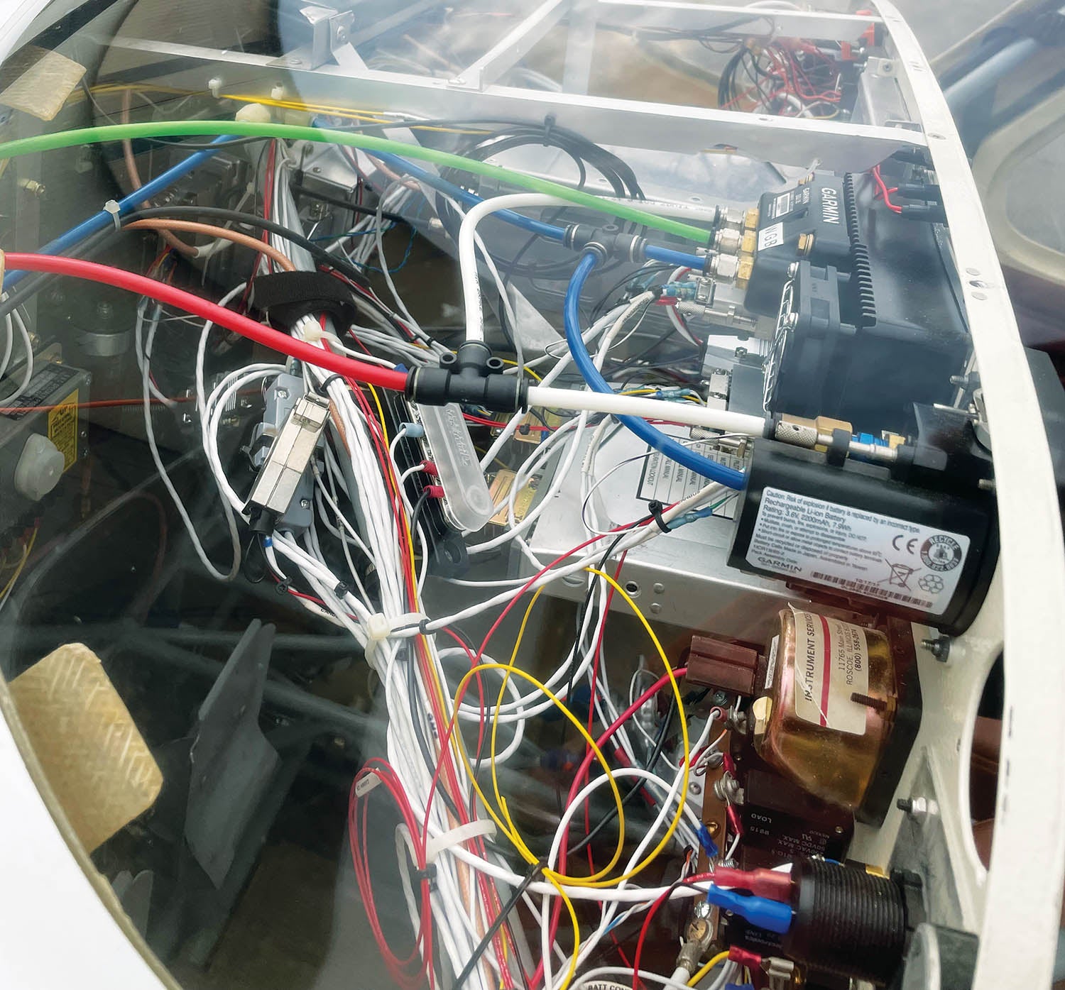

I built as much of the wiring harness as I could on the bench.
Garmin G3X upgrade 13
Even so, I still had to spend a lot of time trying to tame the rat’s nest of wires behind the panel. Next time I’ll do all the wiring on the bench before installing the panel.

I wish the G3X had a little more knob flexibility. The left-hand knob is always heading and altitude set. By default, the right-hand knob is barometer setting and flight director bug. They change a bit if you’re using split screen, but I rarely do that on this small screen. I prefer altitude and heading on the right, which leaves me with both knobs doing the same thing. I use the knob on the G5 to change the baro setting, so mostly I’m happy. But I really wish that left knob could be used to change the volume on the GTR 200 remote com. Instead, I must touch the radio icon and tap the plus and minus volume icons.

I wanted the 10-inch G3X Touch, but it wouldn’t fit because of the row of toggle switches and my transfer pump panel at the bottom of the panel. The 7-inch G3X fit nicely in the space of the top four instrument holes so I bought that instead.
I wanted my audio panel to be in the traditional spot on top of the radio stack, but I would have had to relocate the throttle/prop/mixture cables to a subpanel below, and I would have had to figure out how to attach rail extensions behind the panel. I put the audio panel right below the G3X. It’s very handy there but I had to make some thin metal covers because it doesn’t quite take up the space of the previous instrument holes.

Although I spent a lot of time reaching over and under that panel trying to tame the rat’s nest of wires, it’s really not up to my standards. I had built as much of the wiring harness as I could at the bench, but a lot of it still had to be put in place and threaded through rings and zip ties. I try not to show the pros the back of the panel.
Don’t get me wrong, I’m quite proud of how it all came out (at least from the front), but I’m still lusting after that 10-inch screen. The 7-inch one makes a great PFD, and I use a combination of my iPad and the GTN 750 for moving maps, but the convenience of the map and/or charts right on the screen in front of me, plus having full engine instruments visible all the time, is very appealing. I saw some gorgeous laser-cut and laser-etched and overlay printed panels at AirVenture. I do have the CAD outline of the panel, so I could have designed it and sent it off to be cut.

In the GlaStar, the bottom of the panel is attached to tabs on a round tube. I would, instead, use slightly loose Adel clamps so that I could rotate the whole panel flat to work behind it. That would require routing all the wires along the bottom of the panel, but that’s OK because I would wire it all up on the bench anyway.
I would use the opportunity with the panel out to really clean up the wiring behind it. I would build in better panel lighting too. And I would build an easily accessible avionics shelf to mount the com and transponder on. I’d also see if I could afford a full ADS-B In/Out transponder.
