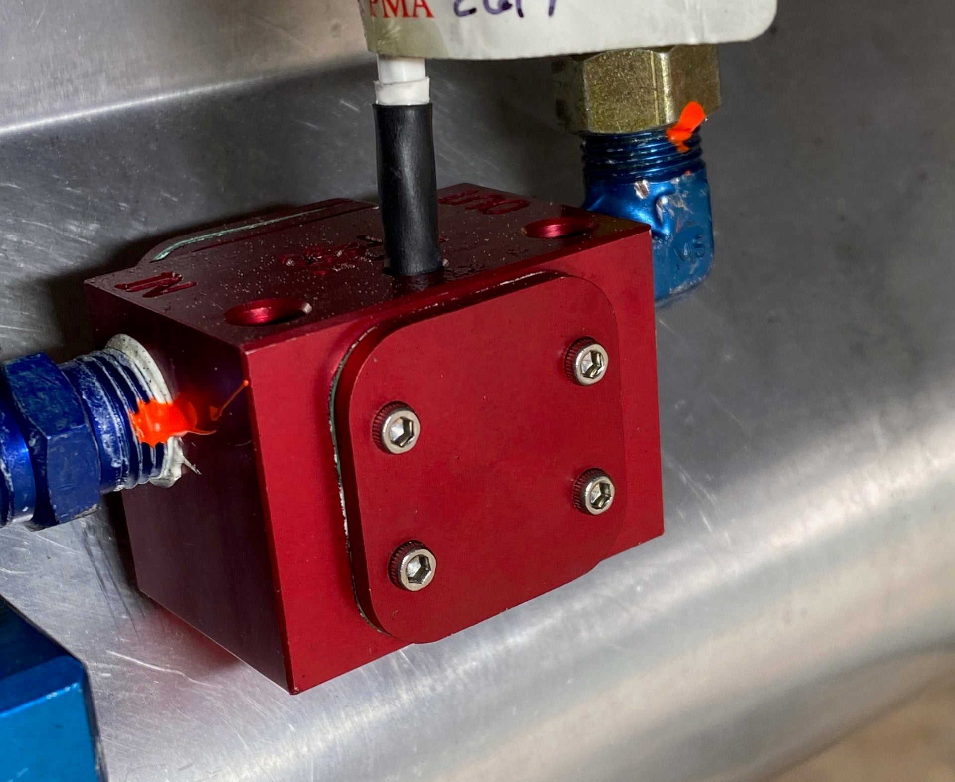

redcube 1 scaled
The initial location for the “red cube” fuel-flow transducer, just after the gascolator.

My first attempt was to intercept fuel flow at the gascolator output, which meant easily mounting the cube and substituting a few AN fittings. It was easy—too easy. It’s worth noting here that EI says the cube should be between the last fuel pump and the carburetor (in that case) and, in the case of a fuel-injected engine, between the servo and the flow divider. What I had built up wasn’t strictly what was called for, but—and here is where you can drive off the rails—other builders have tried a similar approach and reported “success.” I figured that since I had all the parts on hand, it was worth a try.
redcube 3 scaled e1592255886217
The better way to mount the red cube, between the fuel pump and the carburetor.
The Dynon EMS did register a reading that mostly made sense using the baseline K factor. If you haven’t used a fuel-flow module before, you should know how it works. Basically there’s a small wheel that is spun by the fuel flowing through the box. The wheel converts this motion into electrical pulses, which is what the engine monitor interprets. The more flow, the more pulses over time. You can calibrate the entire system by adjusting the so-called K factor, which converts pulses into volume inside the instrument. Phew.

RedCubeADD
Having fuel flow shown constantly in flight as well as the totalizer data (fuel consumed, remaining and basic endurance, seen in the right lower right corner of the EMS-D10 display) is marvelously convenient.
Now, where to put the cube. I had originally planned to build a small shelf riveted to the firewall because there wasn’t a good way to hang the transducer off the engine where it needed to go. (Also, because EI absolutely does not want this sensor bolted directly to the engine, so splicing it in right at the fuel pump outlet or the carb inlet wasn’t an option.) After noodling it a little, I realized I could fabricate a simple bracket and Adel-clamp it to the engine mount; the fewer firewall penetrations the better, I always say.
Results? You bet. After just a few trips to the gas pump and some minor adjustments to the K factor, the difference in calculated and actual consumption closed dramatically and remained consistent. My experience with this sensor, albeit on an injected engine, was that it could be made very consistent from tank to tank, typically off by no more than 1-2%.
