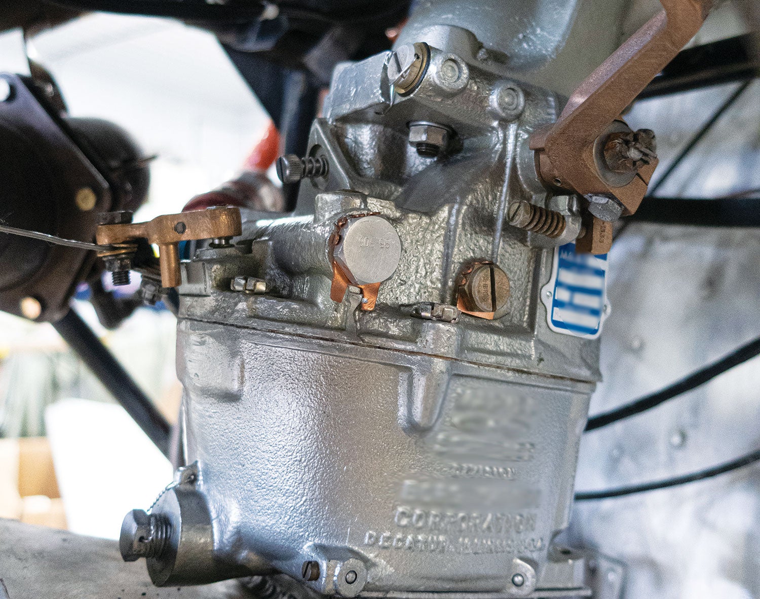

engine carb nuts bolts
The nuts and screw-jobs that hang out in the dark areas of engine compartments get fingered when an engine’s power goes missing. They are victims themselves of the fleshy hands of a screwdriver-wielding person known as “The Mechanic” or “The Owner.”

If you tuned in to Building Time Theater last month, you’ll remember we discussed how carburetors are simple machines that facilitate the mixing of fuel (supplied by the fuel system) and air (drawn in by the intake stroke of the engine) into a combustible aerosol, and they can neither cause nor correct the bad behavior of a single cylinder. When an engine performs poorly overall, however, it is difficult to keep from suspecting the carburetor and its mysterious network of passages and adjusting screws. Other causes of poor engine performance—failing fuel pump, plugged fuel vent, air leak, plugged fuel line, dirty fuel filter, dirty air cleaner, slipped mixture or throttle cable, and so forth—often frame the carburetor for the poor performance, causing an average Joe to probe the carburetor with screwdrivers. We’d all like to turn a carburetor’s screw 90-degrees to restore an engine’s compression or repair its broken magneto but, in the history of engines, that has never been accomplished. What’s more, two common carburetor failures—debris in a fuel passage and sinking/stuck floats—can’t be fixed by turning adjusting screws.
When a propulsion system receives maintenance or alterations, as Clarence’s did, and the engine’s performance is degraded in the process, the most likely cause is something that was touched on purpose or something that was touched incidentally. For instance, if intake tubes near spark plug wires are replaced, it is more likely an intake tube isn’t sealed or a spark plug wire was bumped free than it is the carburetor went out of adjustment.
My ears perked up from two of Clarence’s declarations; he replaced the prop and the engine’s bearings. If I were Cliff and Joe, after a brief run-up to check the engine’s reaction to the throttle and cockpit mixture control, I’d cast suspicion on the new prop. I’d put the old prop back on to see if the power is restored. If that failed to restore power, I’d confirm the marks on the cam timing gear were aligned correctly with the drive gear when he reassembled the engine. One tooth off and the valves will open and close out of time with the pistons. The engine may run and sound fine but it will lack power.
Carburetor adjustments should only be made for good cause. There is no need to touch the idle screw unless the idle is too high or too low. If the engine doesn’t exhibit signs of being too rich or lean, no mixture adjustment is needed. When you do confront a carburetor with a screwdriver, note the original settings so you can restore them if your efforts fail or make things worse. Make small adjustments, one at a time. Common sense dictates a carburetor should not require significant adjustments if it had been functioning fine.
Carburetors become less mysterious when you understand what they can and can’t do. Before casting an accusatory glance at a carburetor, remember it cannot cause individual cylinders to misbehave and adjustments impact all of the cylinders, not only one that may be misfiring, running hot, or fouling its plug. That knowledge will speed you toward a correct diagnosis and repair and get you back in the air, building time.
