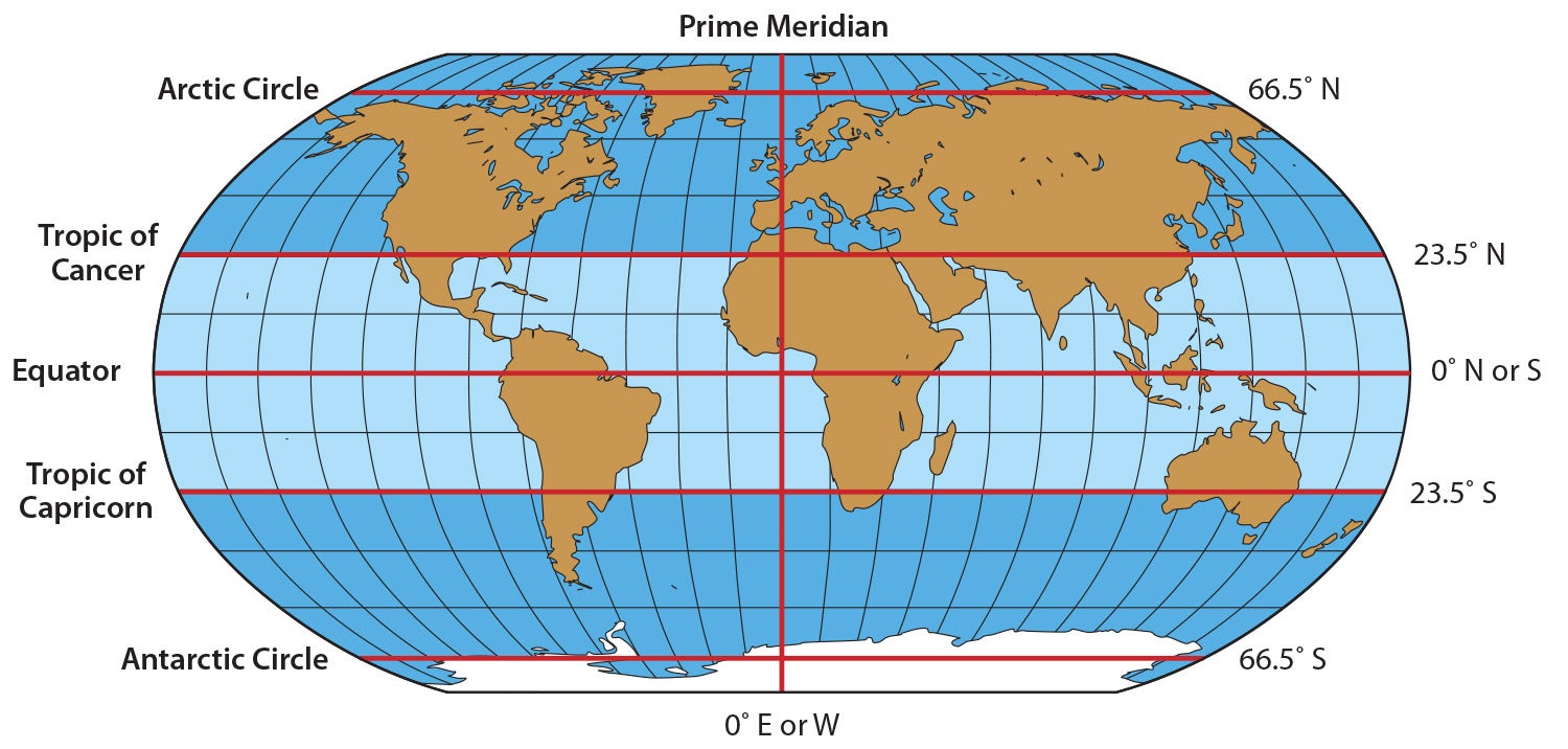

WorldMap
The sun traces out a sine wave between the Tropic of Cancer and the Tropic of Capricorn. It just touches Cancer on June 21 and swings south to Capricorn on December 21, thus defining the first day of winter and the first day of summer.

The sun traces out a sine wave between the Tropic of Cancer (a line of latitude 23.5° north of the equator just ticking the Florida Keys) and the Tropic of Capricorn (a similar line south of the Equator slicing Australia in almost perfect half. It just touches Cancer on June 21 and swings south to Capricorn on December 21, thus defining the first day of winter and the first day of summer, also called by scientists the winter and summer solstice. (Solstice means “the sun stands still,” which it does for that one day directly over Cancer and Capricorn.)
