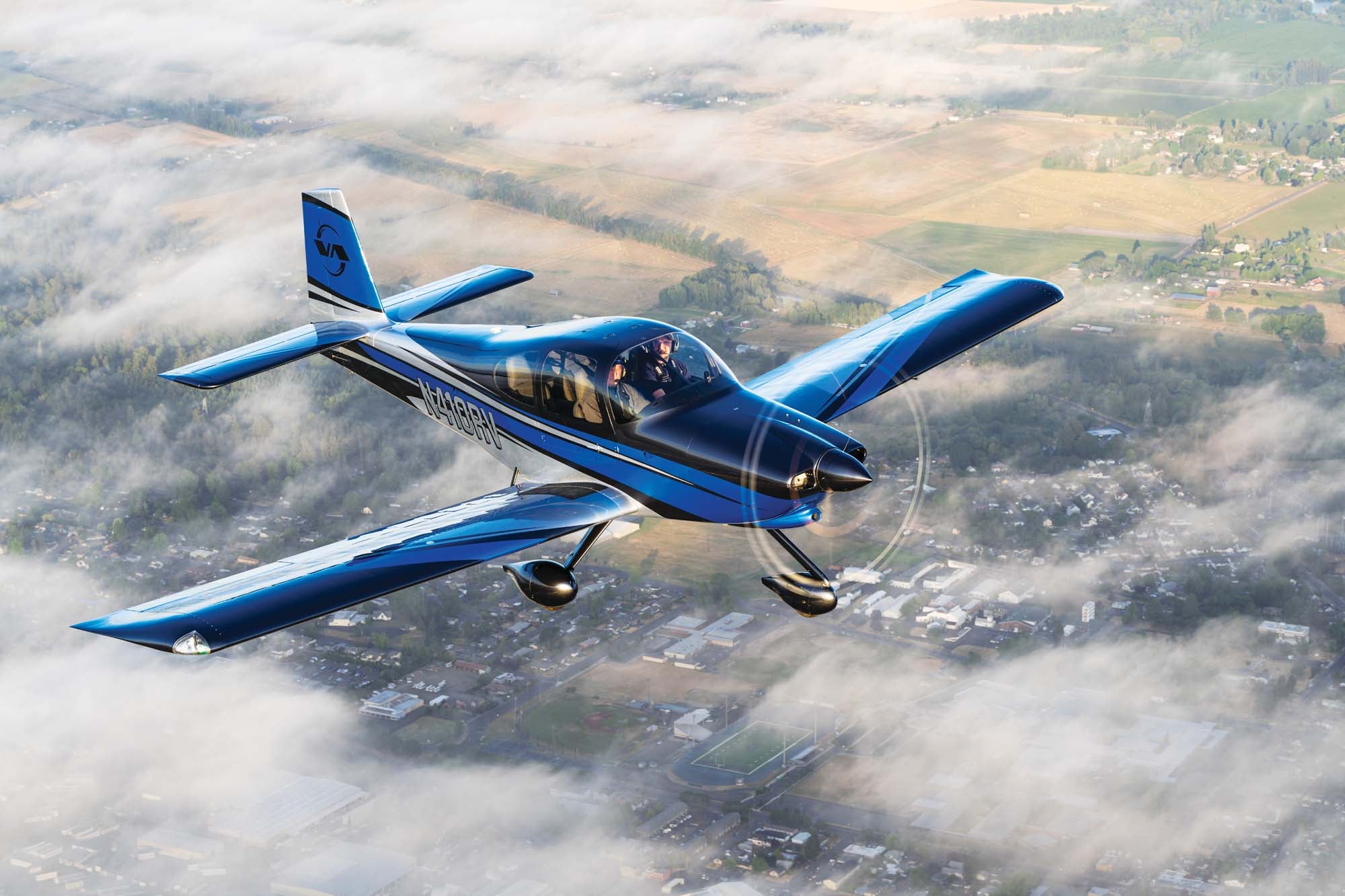

Which puts N410RV in a tough spot. As the prototype and familiar factory demonstrator aircraft, the formerly yellow-and-white RV-10 was modestly equipped. It was upgraded in 2016 with a full Garmin G3X Touch suite but the interior reflected its earnest (but vitally important) roots as both a prototype and factory demonstrator. When we brought our columnist Myron Nelson to fly with Mark Easton, whose “fully modern” RV-10 was on our November 2021 cover, he noted, “I would be lying if I didn’t say some aspects of the demonstrator struck me as less than impressive, especially the Spartan interior dressing and rather simple instrument panel.” But he and the other thousand or so RV-10 builders were able to see past that and recognize the goodness of the airplane itself. And by the time Easton had begun building in 2016, the aftermarket for the RV-10 was really gaining momentum.revived rv 10 02
So it’s definitely time for Van’s Aircraft to get aligned with builder sentiment. There are, however, good reasons they haven’t until now, partly that builders were already doing some of the demo work with their own highly spec’d 10s but also that there were more important items on the agenda, first with trying to catch up with the surge of sales around COVID, developing the RV-15 and then focusing on the recovery from Chapter 11 bankruptcy protection that mercifully ended this year.
In the weeks leading up to AirVenture, Van’s new management team, headed by Mikael Via as the no-longer-interim CEO, was still focused on recovering the business (and has significant work yet to do) but also realized it needed something more than the same-old to show at Oshkosh. The decision had already been made to leave the engineering prototype RV-15 at home, so the task of refurbishing one of the factory RV-10s came to the top of the list. The project fell to Operational Excellence Manager Sam Ozenbaugh.revived rv 10 04
The Priorities
As mentioned, a key goal was, as Sam says, “to show the type of airplanes that a customer can build. Another goal is to show our customers that we are focusing on improving our quality, both with our products and with our customer service.” So work began on N410RV, gutting the interior and performing a considerable tidying up of the bodywork and systems. However, the Lycoming IO-540 and the entire firewall-forward configuration was left unchanged, in part for reasons of time and in part because it already worked really well as the engine cooling is good and few have serious complaints about the RV-10’s baseline performance.

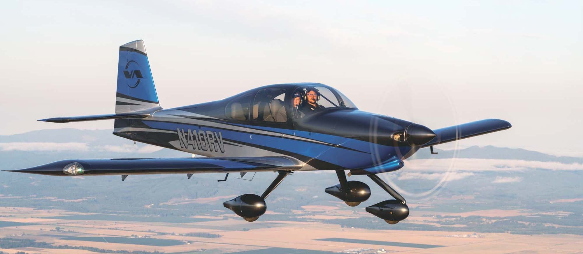

Two of the most visible changes are right up front. (Past the modern paint scheme, which was penned by Evoke Aviation and rendered by in-house painters at Van’s.) Hartzell’s latest three-blade Raptor composite prop replaces the aluminum blended-airfoil two-blade prop that was a stalwart of mid-2000s builds. Adding another blade does not seem to have affected cruise performance, according to the Van’s team, but is smoother and might have some takeoff and climb benefits. Testing has really just begun as this is written so better comparisons will have to wait, but the initial impressions are positive, as you might expect from a much more modern propeller.
revived rv 10 09
Hartzell’s Raptor prop is a weight-saving addition. The cowling itself is largely unchanged.
What the Hartzell Raptor does really well is save weight, roughly 20 pounds right on the nose. Fortunately, the RV-10 has a generous CG range, but builders intending to use this prop from the start will want to take that into consideration when figuring out where the other heavy stuff goes. Van’s intends to replace the existing Odyssey battery behind the baggage bay in the 10 with an EarthX, which will help move the CG a bit forward and further reduce weight. While that hasn’t been done yet, Van’s estimates that the total weight gain of N410RV after all the modifications—and make no mistake that the interior is a radical upgrade—will be in the neighborhood of 11 pounds. Credit the new prop and other lightweight components for that very reasonable figure.

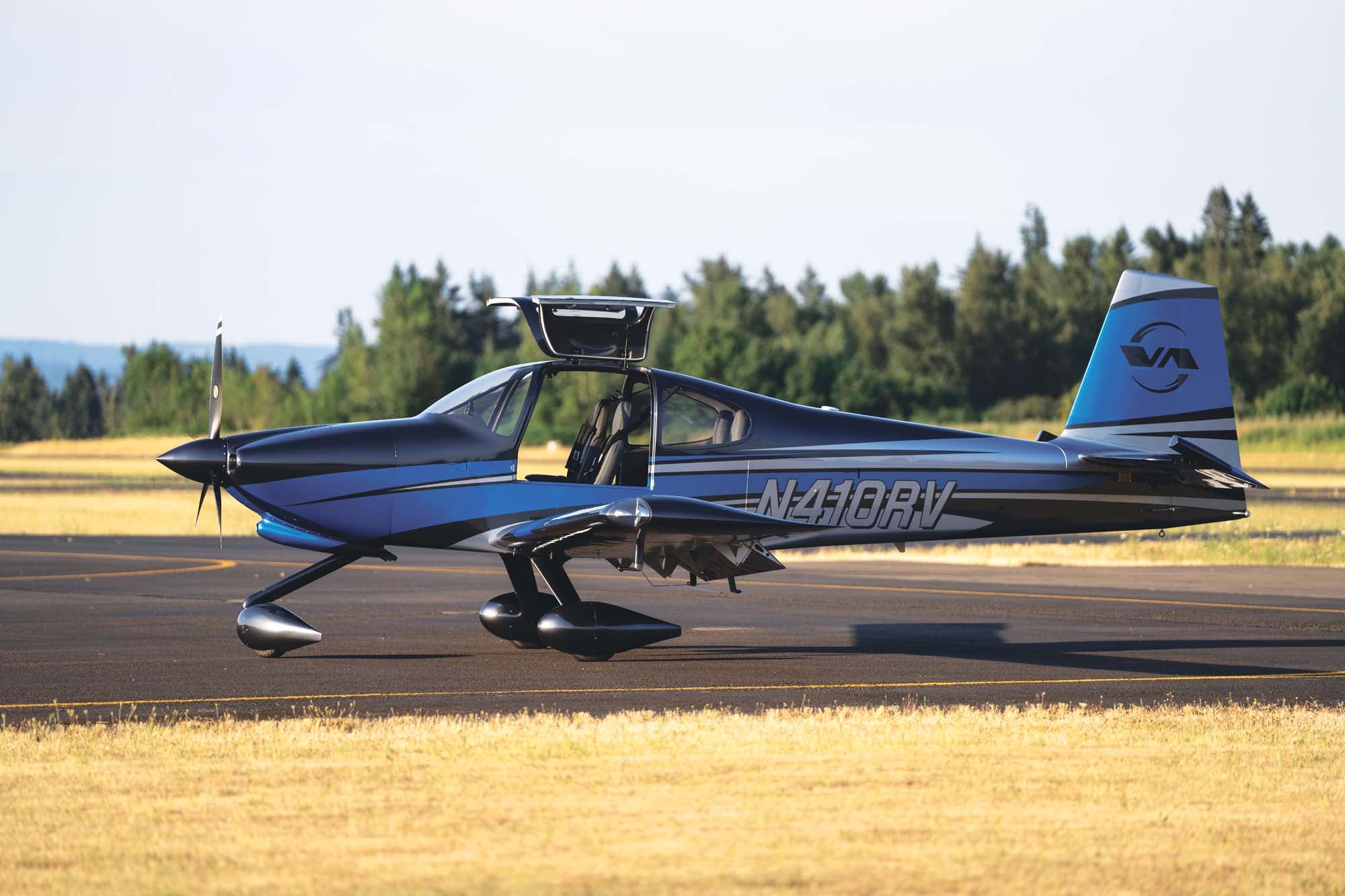

Once your eyes adjust to the wicked paint scheme, you might notice something different about the windows. In the normal RV-10, the windows are bonded into the fiberglass cabin top and then the edges glassed over to create a seamless transition to the rest of the structure. In use, that can lead to cracking as the fiberglass and plexiglass expand and contract at different rates. The revised 10 has those exterior seams milled out and a flexible adhesive applied in between. Van’s is looking at other ways to mount the windows that allows some float for expansion and contraction. On N410RV, this adhesive is dark and none too noticeable unless you know what you’re looking for. (Sorry, did I ruin it for you?)
revived rv 10 10
My what a new paint scheme can do. Right: this groove around the windows is intended to reduce cracking at the plex/fiberglass joint.
