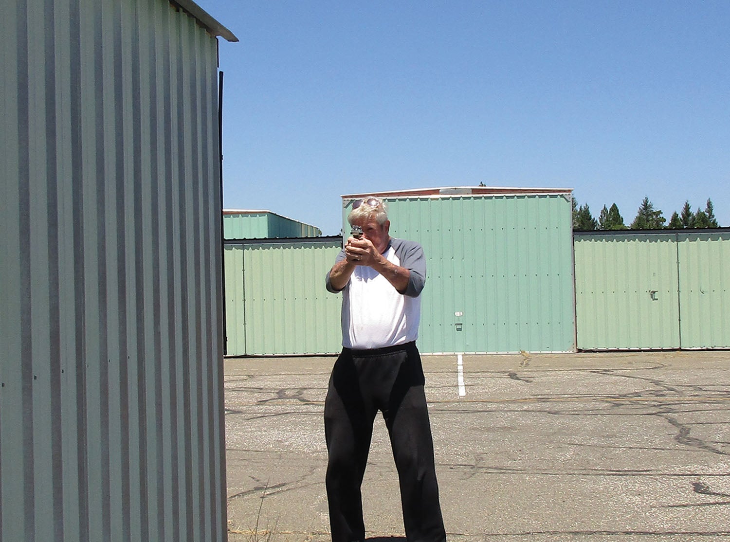

“Putting” it on the hangar involved just a bit of compass work. As we said previously, true south is not necessarily magnetic south. In this case 180° true = 167° magnetic. And once again, serendipity fell into my lap. For whatever reason (since our runways and taxiways are 25/07 magnetic) the hangars were installed due north/south. Within 1°. Every now and again the blind pig picks up an acorn.

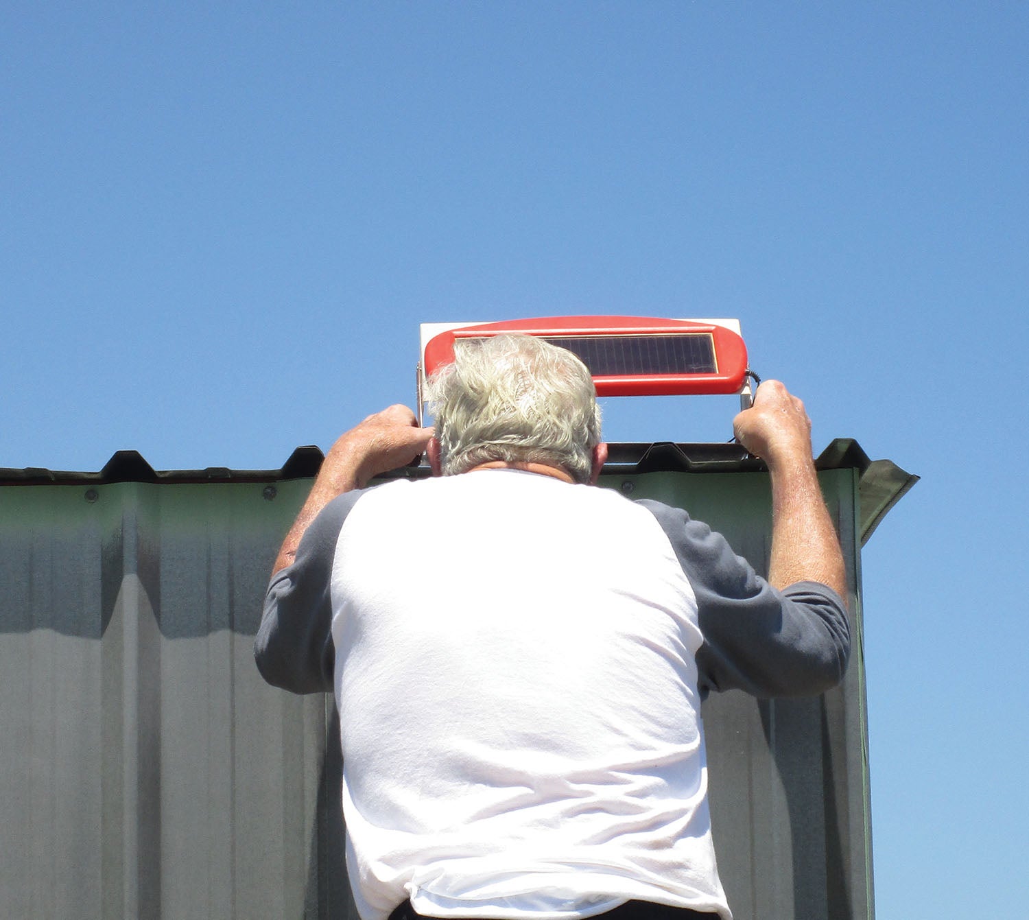

The solar cell was then positioned on top of the hangar (bottom). The OAT at this time of the day (noon straight up) was 98° F. The thermometer in the hangar was pegged at 120° F.
On the other hand, the manufacturer’s data sheet says (in two places) that to use this solar panel for battery charging, you need to have a voltage regulator. This may be the legal department putting in a belt-and-suspenders clause or it may be the engineering department that thinks a regulator is necessary to keep from overcharging the battery.
My opinion? A tractor battery for $25 is one thing, but an aircraft battery for $250 is quite another. The charger regulator circuit shown in the images can be assembled for about $10–$15 in parts including a PC board made by one of several companies that specialize in one-off prototypes.
The regulator design is a modification of the circuit I showed you in the May issue, only this time with a smaller half-amp (500 mA) IC that doesn’t need any heat sinking. My measurements shows that the unit is roughly 95% efficient as it should be with only a watt and a half of energy to start with. We were getting just shy of 100 mA into the battery, and that is about exactly what we said we were going to do.
