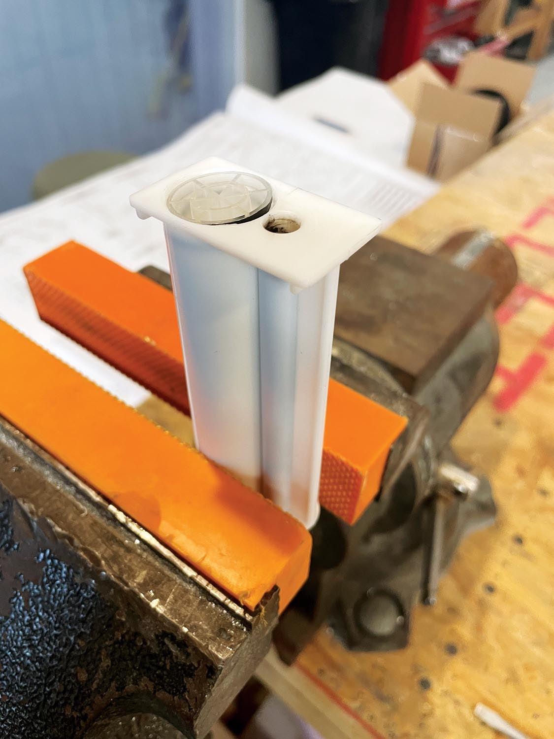

Empty cartridges come with pistons (with O-rings) and caps and can be obtained from McMaster-Carr.

Fill the cartridges by holding them in a vise. Here, we have filled the big side and installed the piston (right). This needs to be taped over before filling the catalyst side.

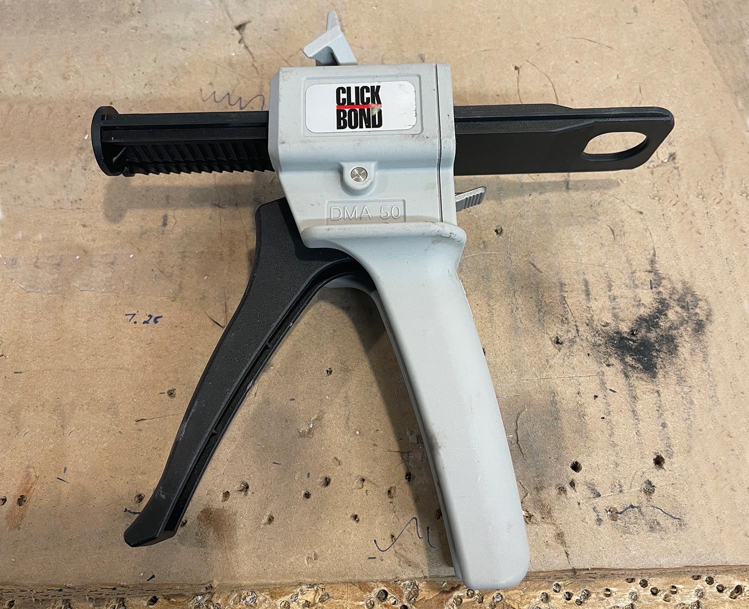

For our experiment, we used a gun from Click Bond (they actually prefer that we call it an “applicator”) that we have in our shop for using Click Bond products. It is manufactured by MIXPAC and is labeled a DMA50. But be careful—these come in different mixing ratios, so don’t buy one for 1:1 or 2:1 when you need a 10:1 for polysulfide! The cartridges also have to be the right size—we went with the 1.69-ounce units because that was what the Click Bond (MIXPAC DMA50) applicator was designed to use.

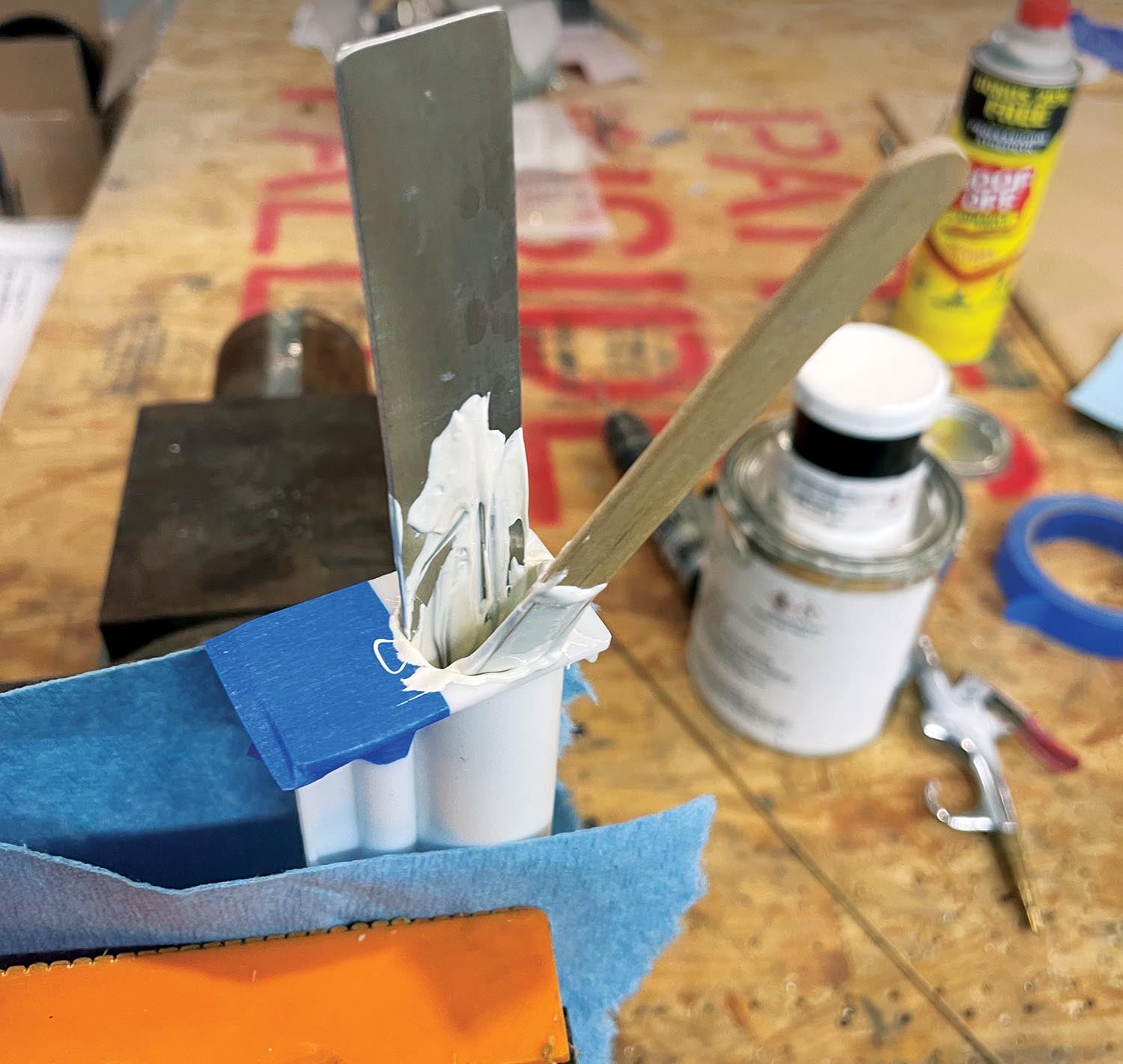

Remember, the goal of this experiment was to try and minimize the mess and waste of using Pro-Seal. As such, we wanted to avoid mixing any Part A and Part B while filling and to keep as much of the gooey stuff off our workbench, our tools and us as possible. To do this, you’re going to need lots of latex gloves, paper towels, popsicle sticks and acetone. Also, grab some scrap aluminum and make a couple of aluminum popsicle sticks narrow enough to fit down inside the tiny diameter chamber for the polysulfide catalyst—something a little less than 1/4 inch with a rounded-off end will work.

This DMA50 gun works with our Click Bond adhesives and also with the cartridges we got for our Pro-Seal experiment.
I also found I needed a solid “needle” to vent air out during filling—a piece of piano hinge wire with a point sharpened on the end worked fine, along with some straightened pieces of safety wire. These could be poked down in the chambers to get rid of trapped air.
Wear your gloves and have some paper towels handy. Keep the acetone can open so that it is easy to put a little on a paper towel and wipe up a mess. Always wear gloves! If you notice a spilled bit of polysulfide, immediately wipe it up with acetone—if the can isn’t open already and you have the sealant on your gloves, then you’ll transfer it to the cap and then set the cap down, making a mess on the bench and so on and so forth. In other words, plan ahead!
The actual filling process is simple. Support the cartridge, back end up, in a vise. Remove the cap where the nozzle will go—this will allow air to escape the bottom as you fill from the top. Put a paper towel underneath it so that if (when) some polysulfide drips out, you don’t get it on the vise or the floor. Put a piece of tape over the small chamber hole to keep the white stuff from contaminating it. Now use a popsicle stick to scoop material into the large chamber. This gets ugly and takes time because you have to scrape it off with another popsicle stick and poke it down into the chamber with the sticks, needles and safety wire. Keep going until you see it bulging out the bottom. Fill to maybe a half an inch below the top—you’ll need room for the piston.
pro seal no mess application 10

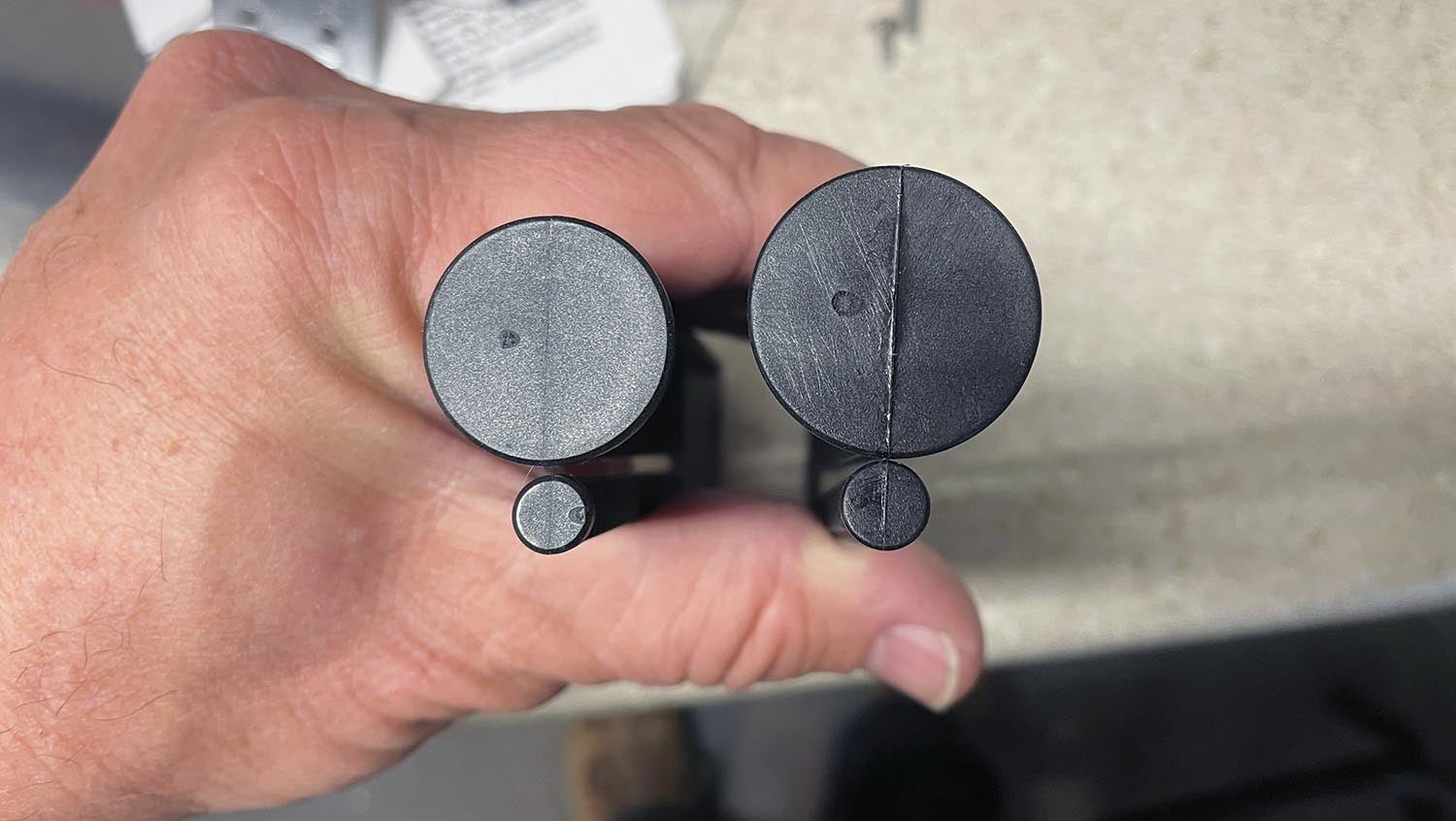

Note that not all guns or cartridges that say “10:1” are the same size—these two pistons work in different brand guns with different cartridges.
When the big chamber is full, clean off any and all spilled gunk from the outside of the cartridge, your tools, yourself—and close the can! Take the large plastic piston (with the O-ring down) and push it into the chamber, tipping it slightly to let air out. Push it down until you squeeze a little material out the dispensing end. Now clean things up again. Make sure the area is surgically clean, then remove the tape from the small chamber and put a fresh piece of tape over the large chamber. Repeat the filling process for the catalyst. You’ll find the safety wire works better than the piano hinge in this small chamber. Fill to the same height as the other side. This is important because the plunger on the applicator gun has two pistons that are the same length—they will push on the pistons and if there is air or less material on one side or the other, you will get an uneven mix until the levels even out.

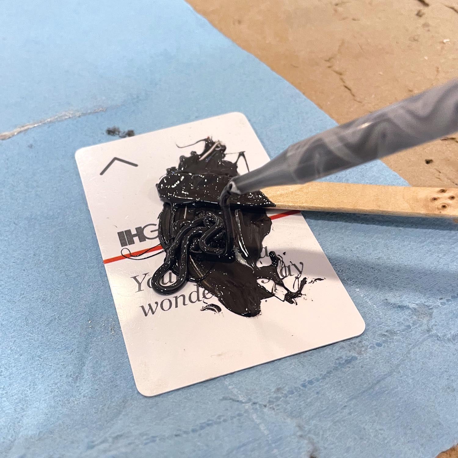

Now that you have a filled Pro-Seal cartridge (you might as well label it with an indelible marker with the contents and expiration date because it will not be reusable for anything else) you’re ready to apply some Pro-Seal! Put the cartridge in the gun, attach a mixing tip and squeeze the trigger until goo starts getting to the nozzle. Enjoy the sight of the mixing process as it travels down the nozzle. Then discard the first bit of stuff—it isn’t going to be properly mixed because you didn’t get all the air out in the filling process. It will take a little pumping until you get a nice dark gray mixture coming out of the nozzle.
pro seal no mess application 07
You can always squeeze the material from the gun onto a card to do a final mix if it doesn’t look well mixed, which sort of defeats the purpose of using the gun!
Before then, you might have some streaks where the mixture ratio was right, but the mixing wasn’t complete. If you want to eliminate waste, squeeze this onto a mixing surface and stir with the stick until it is nicely mixed. Yeah, this is exactly what you would have done if you had done the mix manually but you still would have had to measure accurately. At least that part is now done for you!
Eventually, you will have a perfectly mixed bit of Pro-Seal coming out of the dispensing nozzle and you can apply it directly where you want it. You might still end up using a stick or spatula to make a nice fillet, of course.
