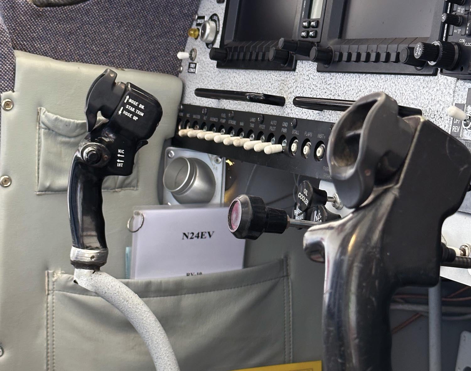

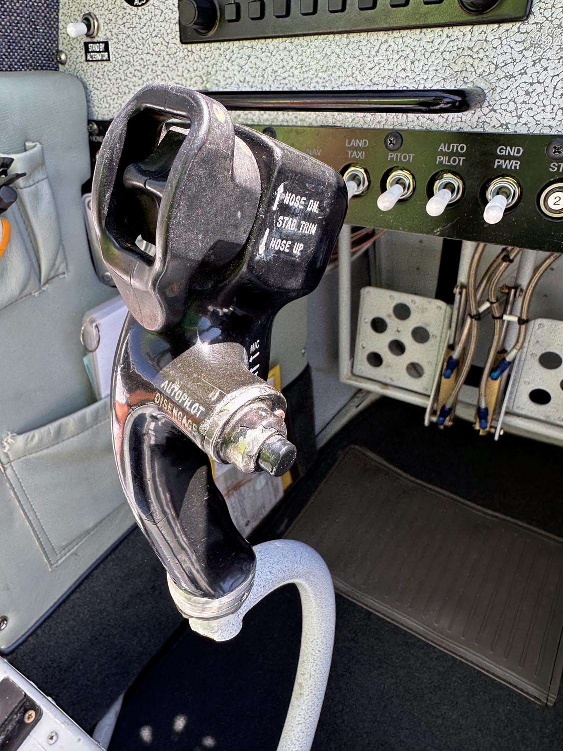

The left grip showing the trim module and autopilot disconnect. Decades of airline service have left their scars.

Two individual RV stick grips derived from a single Boeing 737 captain’s yoke. Pitch trim, AP disconnect and push-to-talk are fully functional.

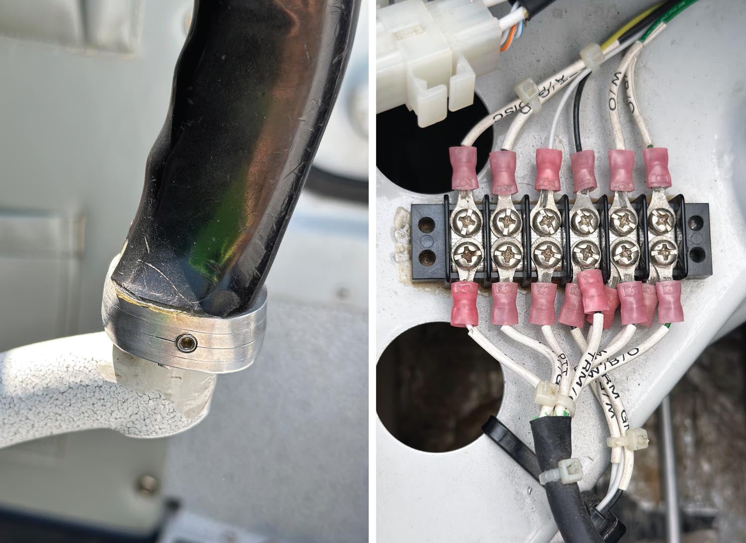

A handmade adapter joins the Boeing half-a-yoke to the RV’s stick (left). Wires for grip functions pass through the stick and to a terminal strip under each seat (right).

My plan was to sever the uprights of the yoke from the base and then use the two uprights as my left and right stick grips. I removed the trim module, PTT and AP-disconnect switches along with their wiring harnesses from the hollow cast-aluminum yoke and then severed the uprights fairly easily with a band saw. I then resurfaced the cut face perfectly flat and smooth with a belt sander. From scrap aluminum material, I fabricated about a 1-inch coupling to mount to the bottom of the grips with tank sealant and #4-40 machine screws. I then machined a hole through the coupling into the grip cavity to allow attachment to the (shortened) top of the factory control stick and also allow internal passage of the wires. I initially used set screws to secure the grip and coupling to the top of the stick but after a couple of hundred hours, I resecured the joint semi-permanently with tank sealant in addition to the set screws.

Before coupling the stick to the grip, I ran the needed wires plus a couple of spares through the stick, making sure that there were no sharp edges to abrade the wires. Starting with the captain’s (left) grip, the first and easiest was the AP disconnect. It is simply a switch to ground. Works great. The PTT was next. The original rocker switch had several leads for the PTT and intercom features. I only needed two for the PTT, which easily connected to the respective leads from the audio panel. Works great.
Pitch-Trim Pain
The last part to finish the captain’s grip was the pitch-trim module that inserts into an aft-facing hole cast into the grip and is secured by two machine screws from behind. The module itself is pretty complicated and consists of two narrow side-by-side rocker switches that while capable of independent operation are intended to be only functional when thumbed simultaneously. This is to prevent runaway or reverse trim and—in concert with sensors in the base of the control post coming out of the floor—to prevent cross-trimming. That is, erroneously trimming counter to pressure fore or aft on the yoke. The bottom line is a lot of complications and wiring not needed for my application. I used a Safety-Trim ST-1-12V-2SP module by TCW Technologies to provide cross-trim relay and runaway trim protection. It also provides two-speed pitch trim speed, which is nice. This meant that I reduced the number of requisite wires down considerably as all I did was wire up one of the two rocker switches, leaving the other as a eunuch. Works great.
That completed the left side. All the wires coming out of the bottom of the stick lead to a terminal strip under each respective seat to allow for inspection, replacement and removal of the stick assembly if ever required.

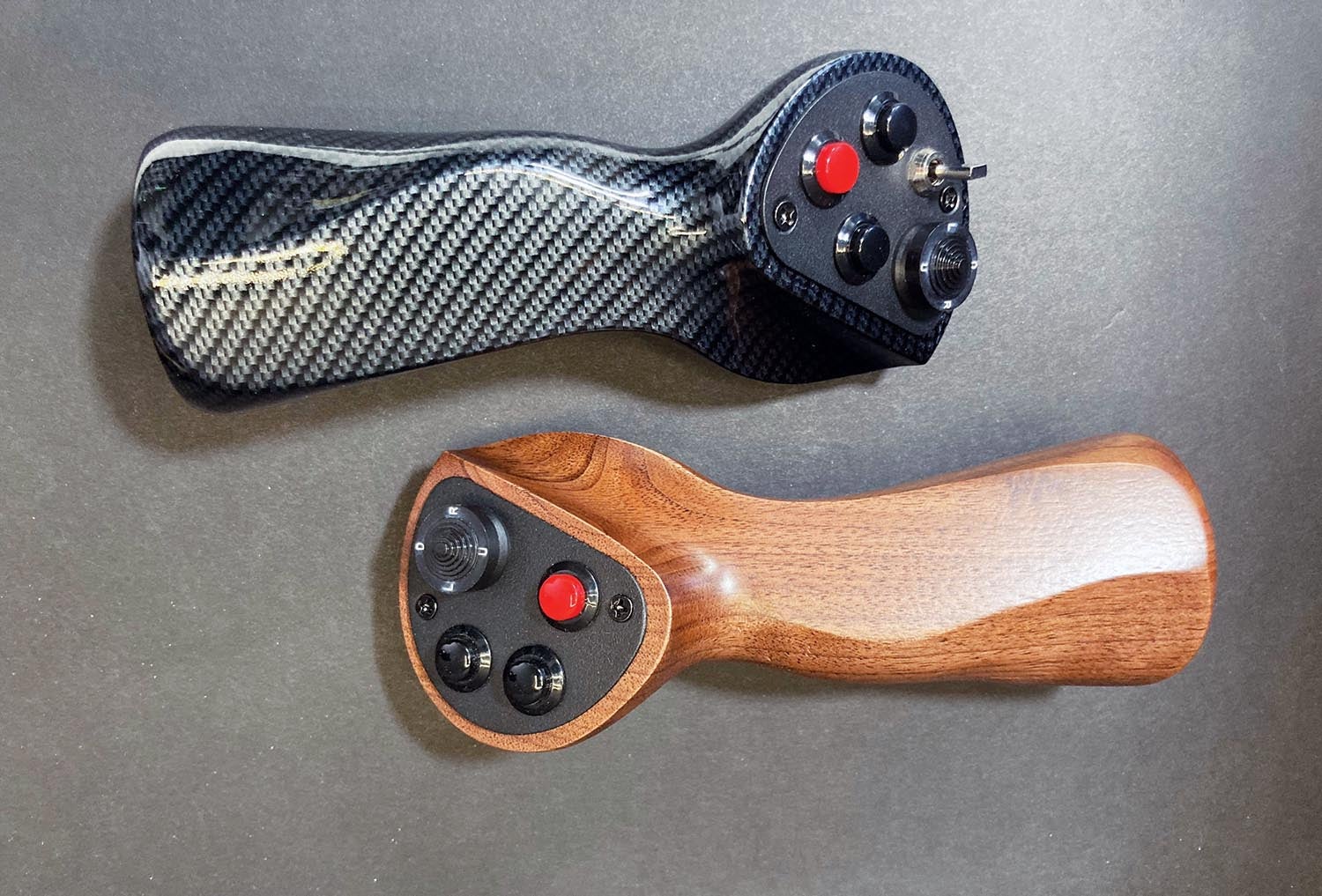

Custom stick grips, like these from Pioneer Control Grips, might be more your style.
