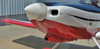

The reality is that you, the builder, want your aircraft to shine amongst all others after investing years of sweat equity. Several of the aircraft pictured here offer points to ponder when evaluating the quality of a paint job. Take the time to research paint shops, and be sure you have a realistic idea of how long your aircraft will be out of service for the paint process. Get a written estimate of the total cost, and ask for an itemized list of the work to be done. Check it against the final result. Do your part to ensure that communication is the best it can be and that everyone concerned understands not only what you are trying to achieve, but also what you will get for the money you’re spending. Inspect the work thoroughly before flying. Lastly, give your airplane the best coat of paint you can afford. It deserves it!
