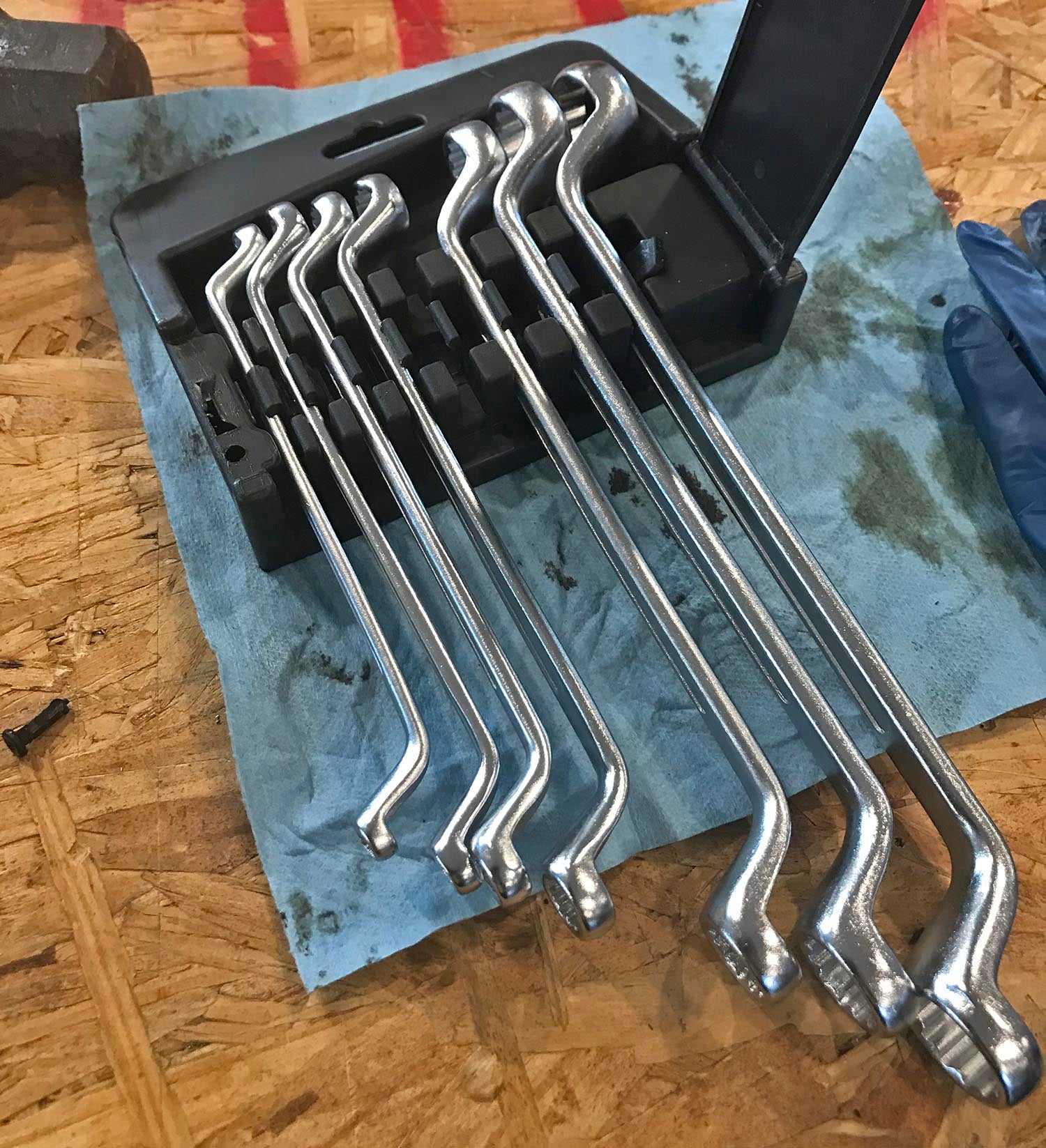

wrench set IMG 7455
Now…what do I do with the rest of the set?
OK, its 5:00 pm, and Harbor Freight is a twenty five minute drive and closes at six! Off we go, and sure enough, they have a set of offset wrenches on sale—perfect as more torture victims. It’s always a shame when I have to buy a set to get one wrench, but this is aviation, and sacrifices have to be made. Home again, I saw that the shape was very promising – but why do they have to put so much metal on these things? Back to the bench grinder to produce a custom wrench that fits exactly in the spot – and allows a generous twelfth of a turn. With a satisfying pop I break the (undoubtedly now retired) young wrestler’s torque, and the rest was history. And the custom wrench goes into a special drawer for when it is needed again.
