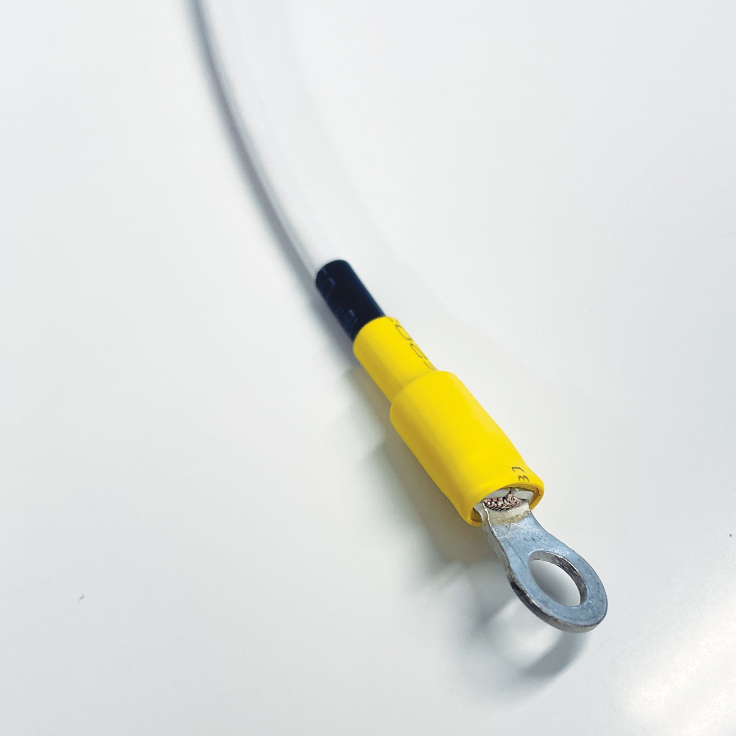

You can make nice crimp connections using standard crimps and a little heat shrink to seal them up afterward. In this case, we used two sizes of heat shrink to match the wire size.

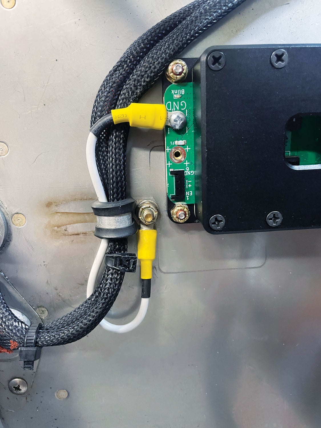

Good grounds are always essential—in our installation, we went straight to the firewall via an Adel mounting screw.

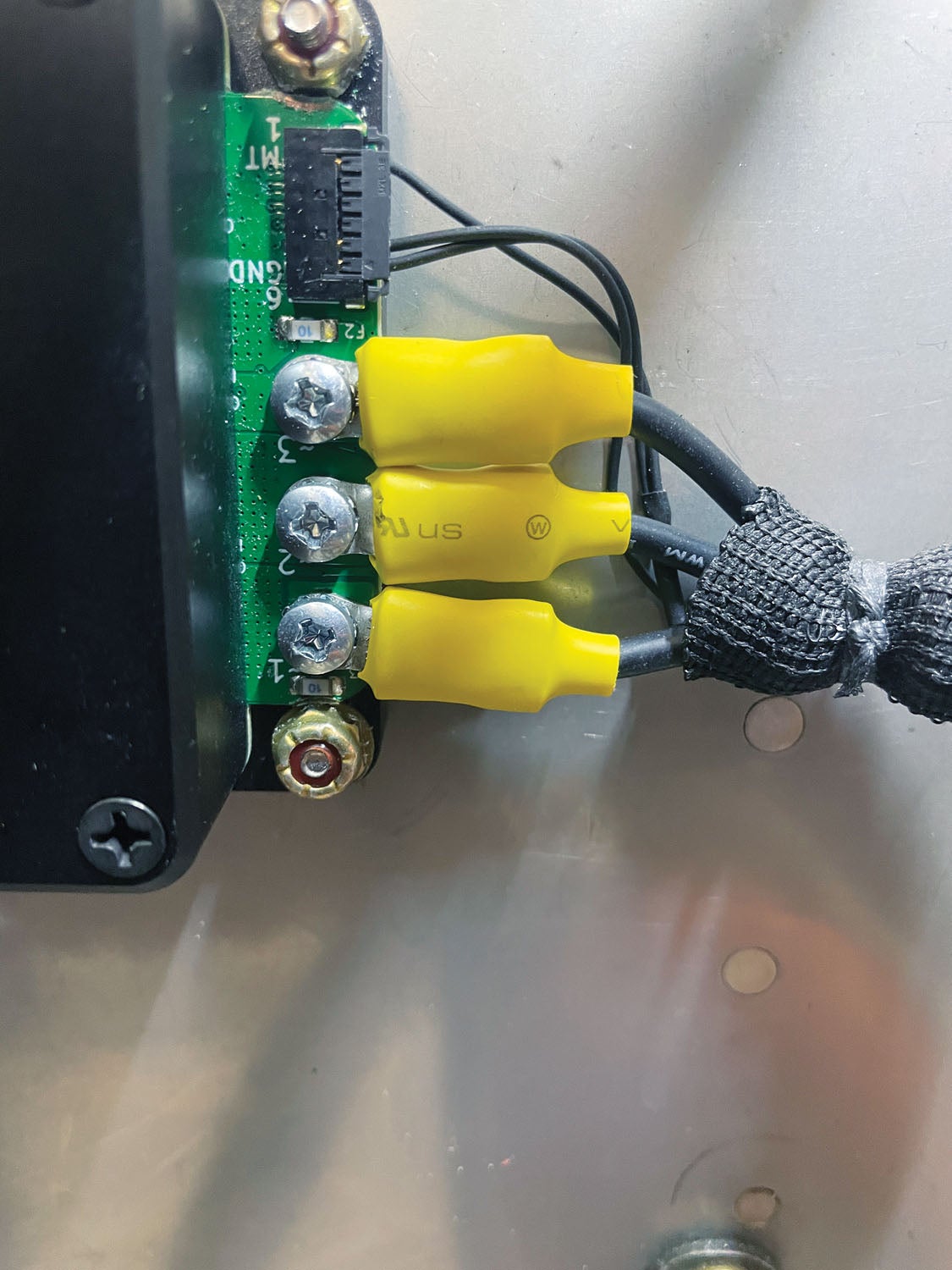

With the units mounted, I slipped some snakeskin over the wires between the generator and regulator to make the job neat, did a little securing with wire ties and lacing cord and crimped the ends onto the three power wires from the generator. They then screwed directly to the inputs on the regulator. The control wires from the generator were already terminated in a micro-connector that simply plugged into the receptacle on the regulator’s board, right next to the power inputs.

The micro connector on the ship’s side of the controller is for the control switch—the two outer wires go through a simple switch. We spliced them to our ship’s wiring with solder sleeves.

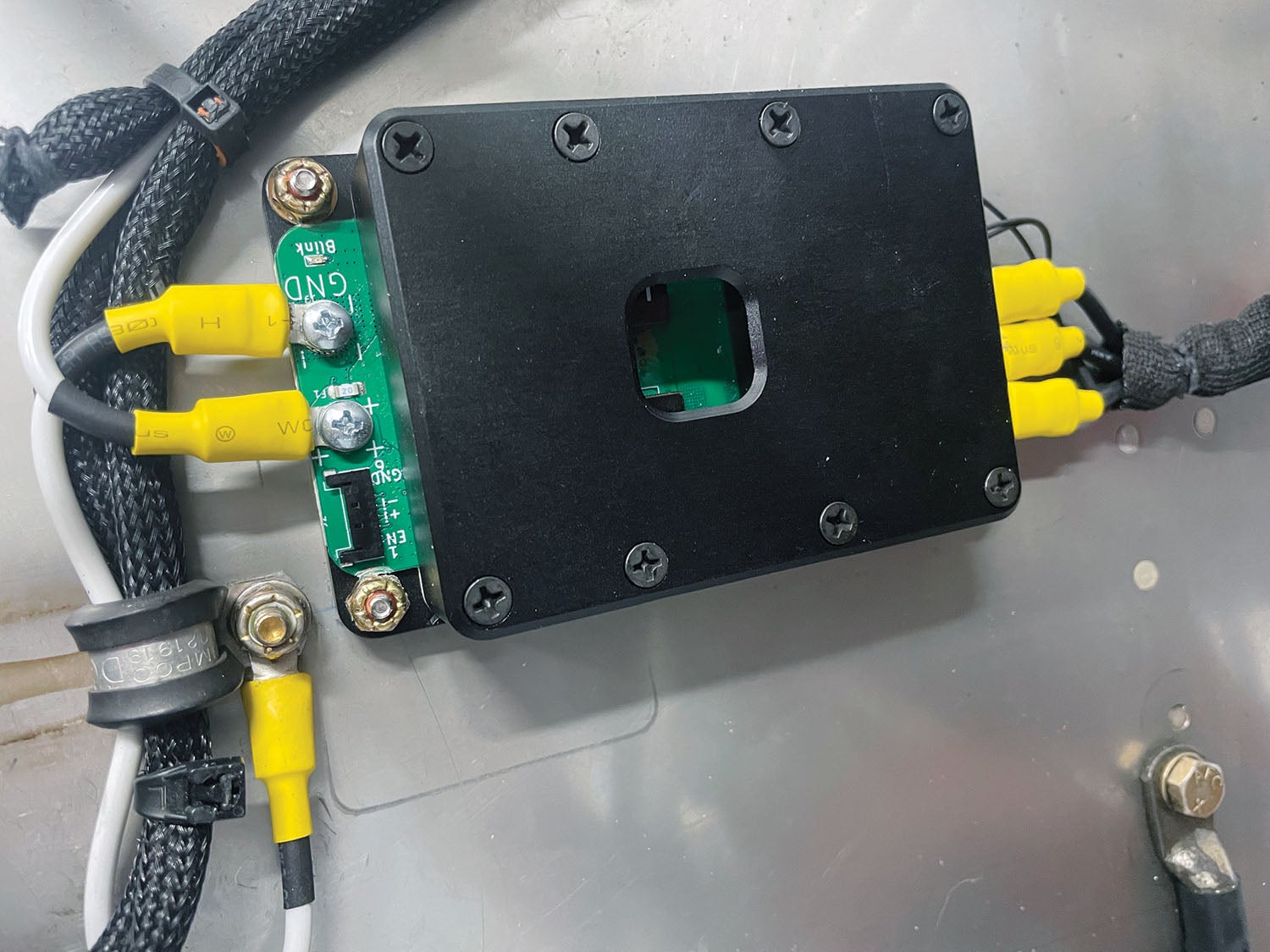

On the other side of the regulator, I attached a #10 wire to the ground terminal, then ran it to a firewall ground. I then attached the feed to the main bus (that I had detached from the old regulator) and attached it to the output terminal of the new regulator. Finally, I took the two wires from the control switch in the cockpit and spliced them to the micro-connector that plugs into the control side of the regulator—and it was done! (Note that I already had circuit protection downstream of the SD-8, but that’s not strictly necessary with the MZ-30L, which is fused on both input and output sides.)
There was only one decision to make, and that was if I wanted the new system to be in parallel with the main alternator, with the voltage set at about the same value, or if I wanted the -30L to run as a backup, with its voltage set about half a volt lower. In this configuration, it “sits” on the bus in standby mode until the bus sags (due to an alternator failure) and then comes online. The voltage configuration is done by cutting a wire jumper on the control plug—and I decided to leave it intact and simply parallel the generator with the alternator, based on advice from Judge.

On the output side of the controller, there are two large connectors—one for ground, the other for voltage out to the ship’s bus.

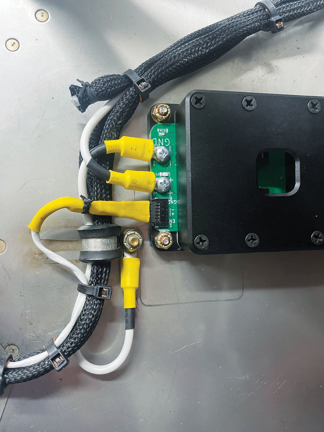

The ground, power out and control micro connectors on the controller.

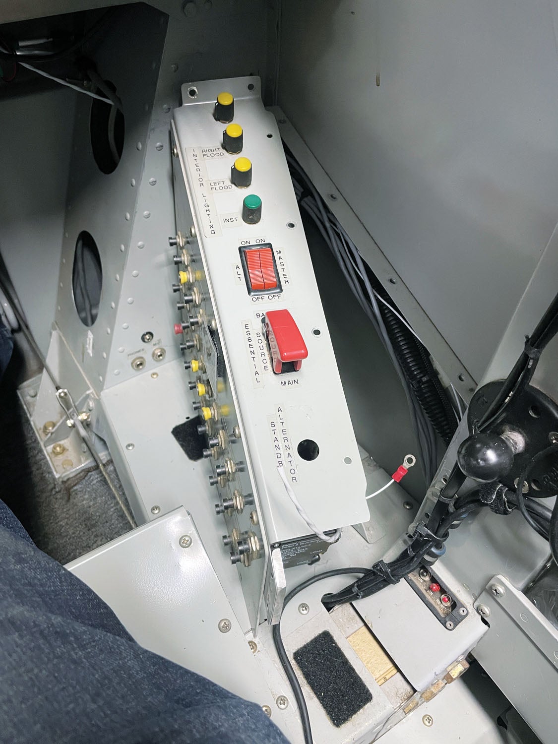

Our power panel had to be opened up to connect the new switch wiring, but everything else was unchanged.
