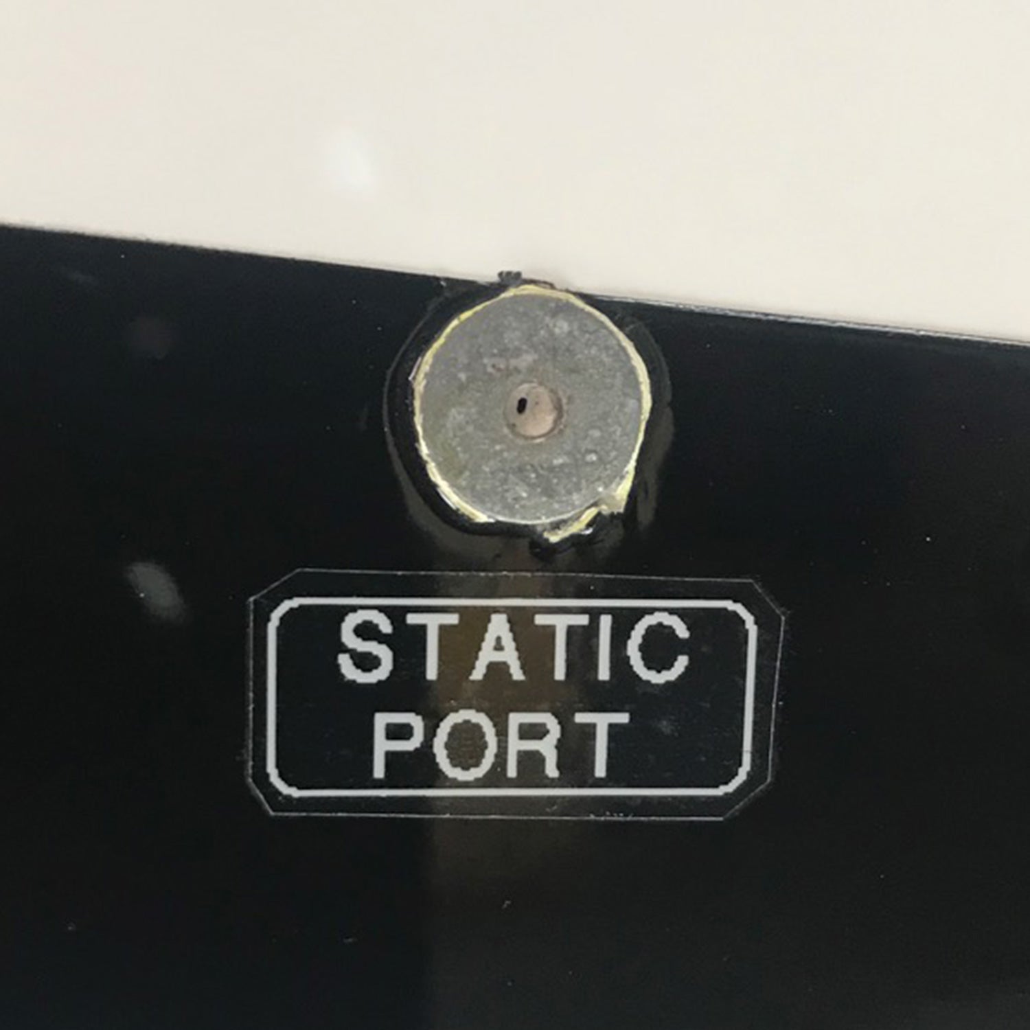

See that gunk in the static port? Waxing is good for your paint, but not for the accuracy of your flight instruments!

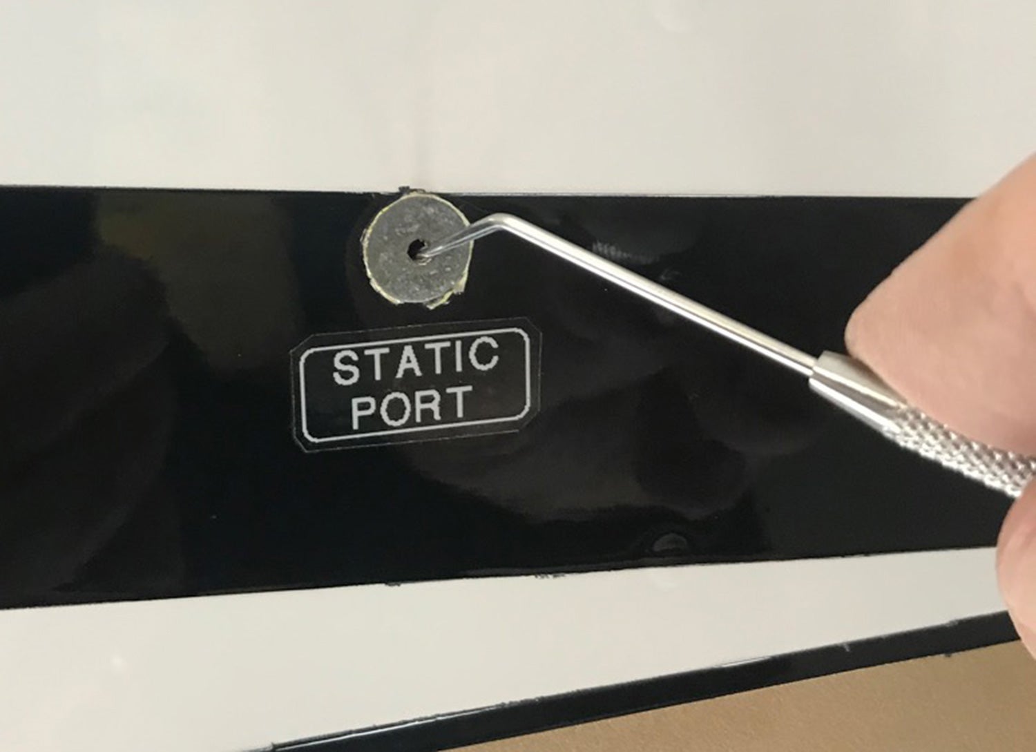

Always keep a few dental picks around – they are perfect for cleaning up a little mess like this.
I was thinking about this awhile back as I was giving my almost fifteen-year-old RV-8’s paint job a good going over with a dual-action polisher/waxer. Yeah, if I had some Aviation Explorers around, I’d let them earn a little money for flying expenses… but we don’t so I got to do it myself. A few drops of polish on the pad, go over a couple square feet until it shines, wipe down, and repeat – over and over. But I still needed to pay attention! Take, for instance, that little static port. Van’s design uses a pop rivet glued in the hole, so you’ve got this tiny little #50(ish) port, just waiting to pick up a little wax. Going around is tough, so over you go, and yes, it’s now full of wax.
Not a problem so long as you know you’ve done it—a dental pick fixes the problem. But what if you weren’t paying attention, or maybe you were helping out some kids at the local airport by giving them a chance to earn a little money by washing and waxing your plane. Remember, any time someone else works on or even touches your plane, it’s time for the most thorough preflight that you’ve ever done. You just never know where something will turn up.
