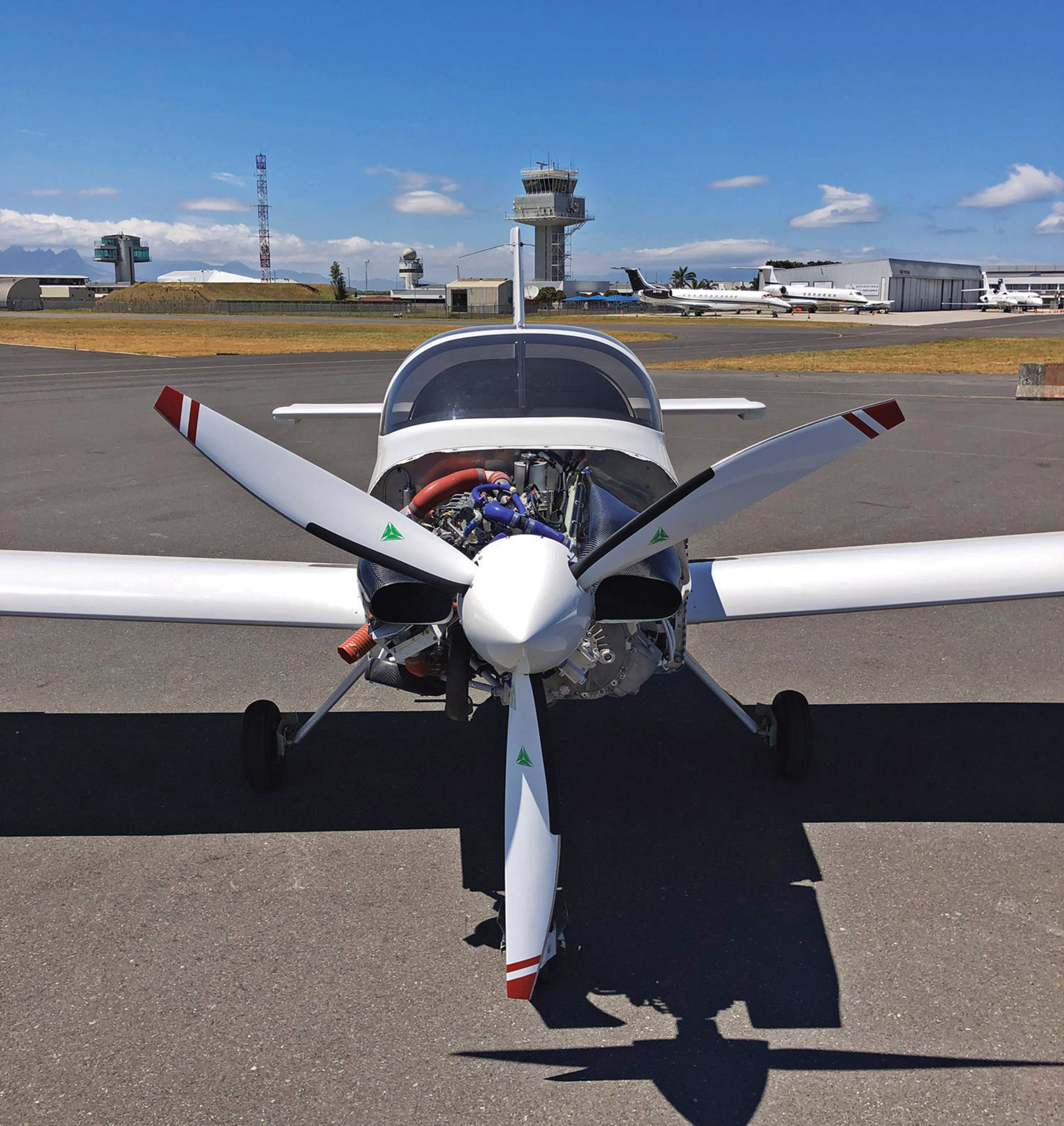

In one word, weight. The diesel is 85 pounds heavier than the Lycoming O-320. The engine position on the firewall means that CG remains well within limits. The cowl is similar to a Lycoming cowl, so we are using a modified RV-14 cowl. The battery and some avionics were moved from the firewall or panel to behind the aft bulkhead. As a result, no additional weight has been introduced—we are only dealing with the increased engine weight.

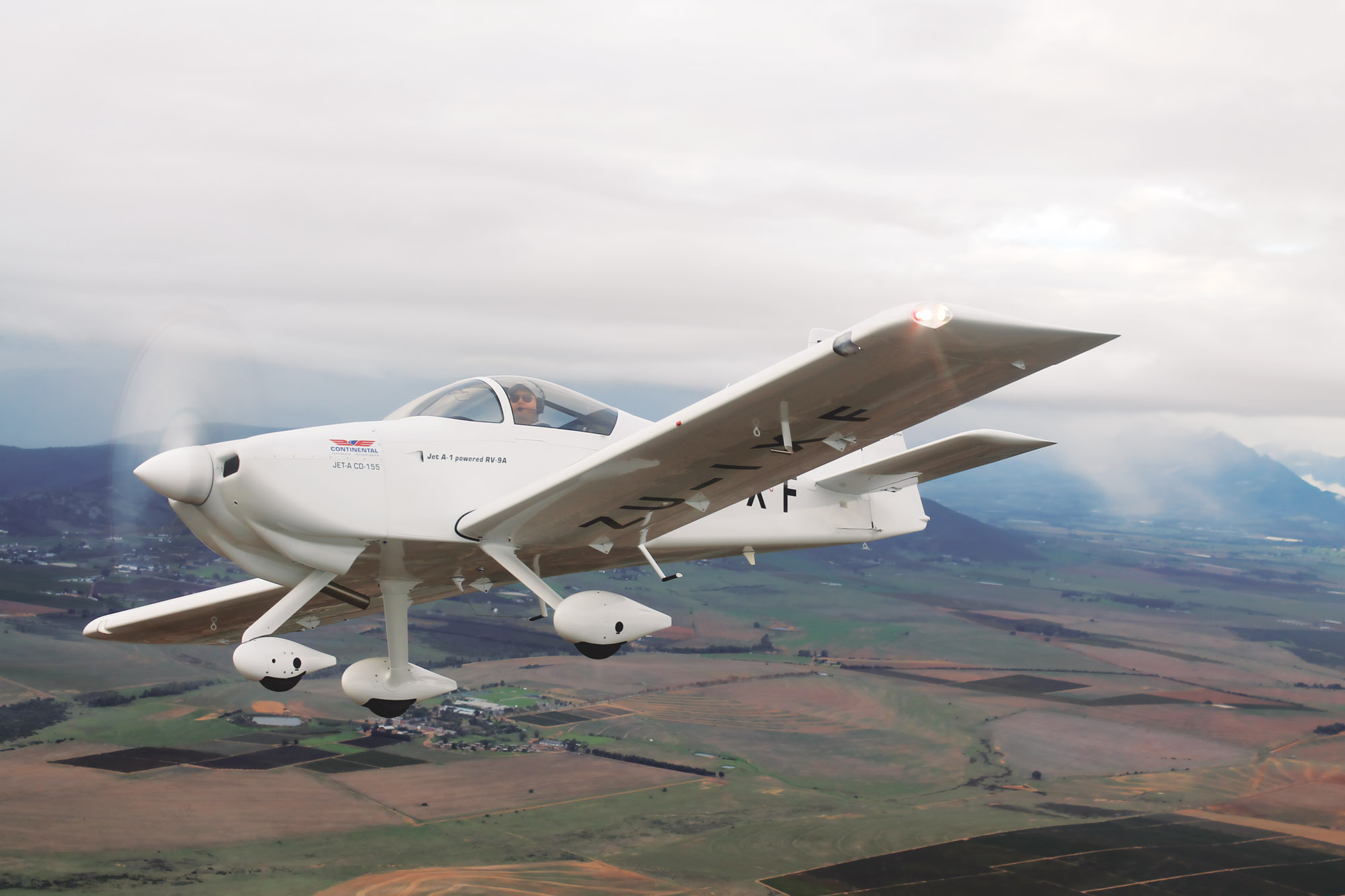

However you look at it, the airplane we call an RV-9D has been well worth the wait. Ease of operation, smoothness, Van’s RV efficiency and performance. We climb at 1400 fpm and true out at 163 knots at 10,000 feet using 7.8 gallons per hour. Pull the engine back to 75% power and we are seeing 154 knots at 6 gph.
Functionally, it’s a win. Hot starts are a nonissue as is power management. A FADEC-managed single-lever power system makes this a breeze. Efficiency comes in part from the fuel injection, which has five to six injections per cylinder stroke. (Yes, you read that correctly.) The benefits of maximizing atomization are significant. Plus, being turbocharged, the CD-155 maintains full power to 10,000 feet.

Head on, the CD-powered RV-9A reveals the engine’s narrow profile.

Cruising with the CD engine reveals expected RV performance with better efficiency.
