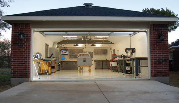

The deal was simple: She would get the outdoor kitchen of her dreams, and I would get my dedicated workshop. It was early 2008 when we finally decided to leave our hometown of Fresno, California, and pursue a better life for ourselves in the Promised Land known as Texas. Like most kit aircraft builders, I dreamed of living on an airpark. We had looked at many in the San Antonio area, but none of them really fit our taste. The challenge before me was the same one that faces many of my fellow builders: How could I create an effective working space at my residence for building my plane without the luxury of a dedicated hangar space?

The shop I wanted to build would have to be no larger than 20 feet by 40 feet. These are not the optimal dimensions for building my plane, but it’s what fit on our one-third-acre lot and what matched the style of our home and neighborhood the best. I knew I could overcome many of the size limitations by building my spaces smarter.

The goal was to be organized and use the vertical space of the shop rather than floor space when possible—after all, in a 20×40 shop, you won’t have a lot of floor space to give away. I knew in order to compensate for the deficiencies of width I needed to vault the ceiling, but I also knew I must not waste all my vertical space with a vaulted ceiling. We finally decided that I would make a third of the workshop with an enclosed attic for storage. I put the vaulted section over the primary workspace to make it feel bigger and more open, and the attic section toward the front of the shop where an 8-foot ceiling would not feel so closed in because it is next to the large garage door.
My wife, Melissa, is an aspiring interior designer, and she helped me plan the space. We wanted to go for a clean, industrial look by adding aesthetic interest on the ceiling such as exposed beams, rigid metal electrical conduit, metal ceiling fans and commercial spiral ducting. However, for everything below the ceiling line we wanted it clean and sterile: white walls, white floor, electrical inside the walls, lens covers on lighting and no exposed shelving.
