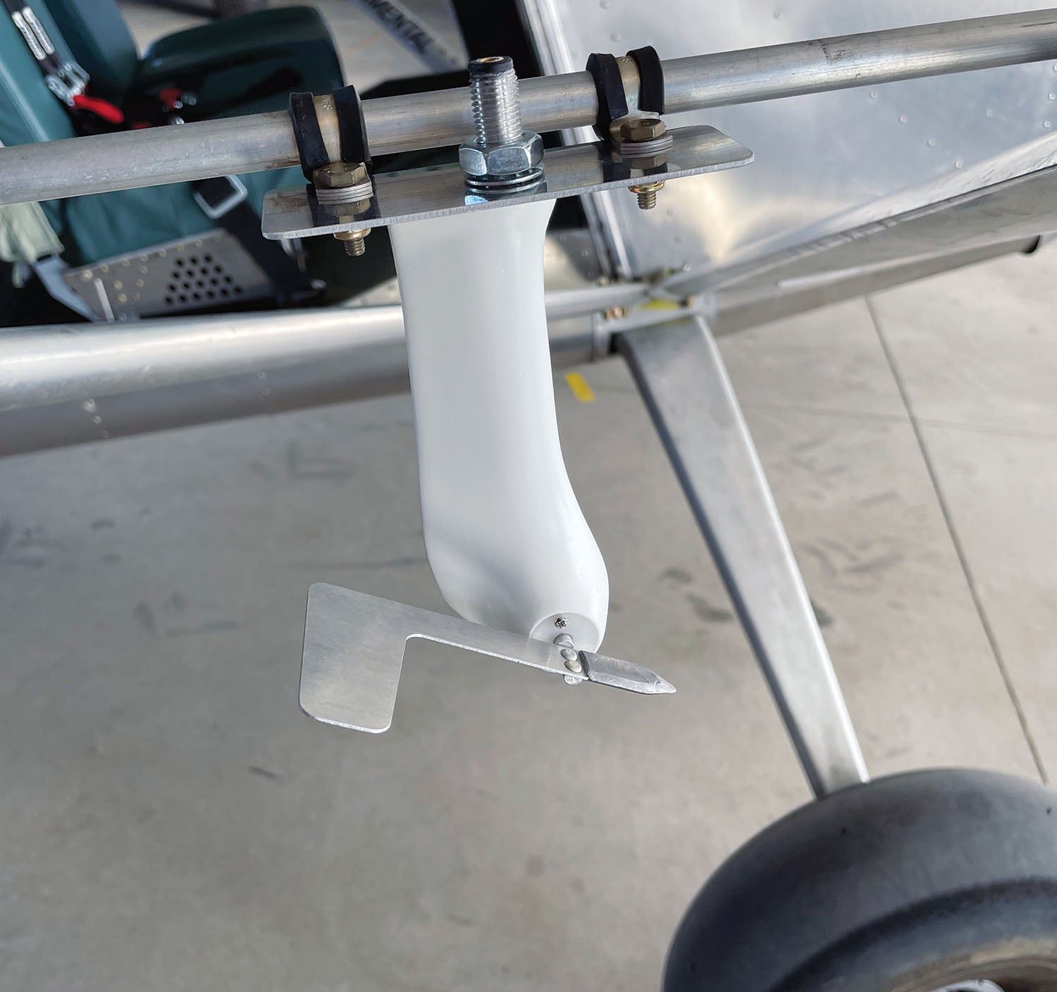

The AoA sensor was mounted to the horizontal jury-strut of the test aircraft, well outside the prop wash.
The vane sensor is designed to mount on an inspection cover on the bottom of a wing but could be mounted to the skin itself if you so desired—so long as it is mounted outside of the prop wash. The control head mounts in a standard 3-1/8-inch instrument hole; it needs to be connected to the AoA vane with a supplied cable and the stick grip cable, also supplied. It also needs power and ground. An audio cable is supplied, along with a jack on the back of the control head so that you can pipe sound to your audio system.

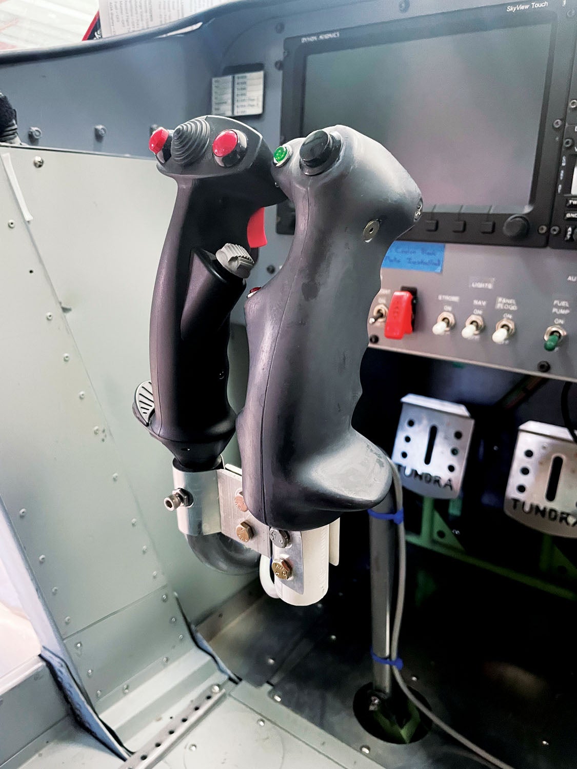

The FeelFlight grip was mounted in parallel with the aircraft’s existing grip on the pilot’s stick for testing purposes. This allowed us to test the functions of the grip without rewiring the aircraft. (Plus it was a great conversation starter!)

For this case, we built a bracket for the AoA vane sensor that rode on the horizontal jury strut, well outboard of the prop slipstream. We then taped the single wire cable from the sensor along the struts to the fuselage and over the door sill. Sensor install complete!

The grip itself was more of a challenge because replacing either one of the existing grips was going to require significant rewiring. Instead, we decided to build a bracket to place the FeelFlight grip on the same stick as the existing Tosten grip, right alongside it. We chose the left seat position because when we tried it on the right, we lost significant control movement when the temporary grip hit the sidewall of the cockpit. This was not a problem on the left since it was on the right side of the left stick. Wiring was simply cable-tied and taped to keep it secure as it was routed to the control head.
The net effect was sort of like having a yoke with a very, very short cross-bar—you could fly with either or both hands and keep your right hand comfortably on the FeelFlight grip, even while flying with the left hand.

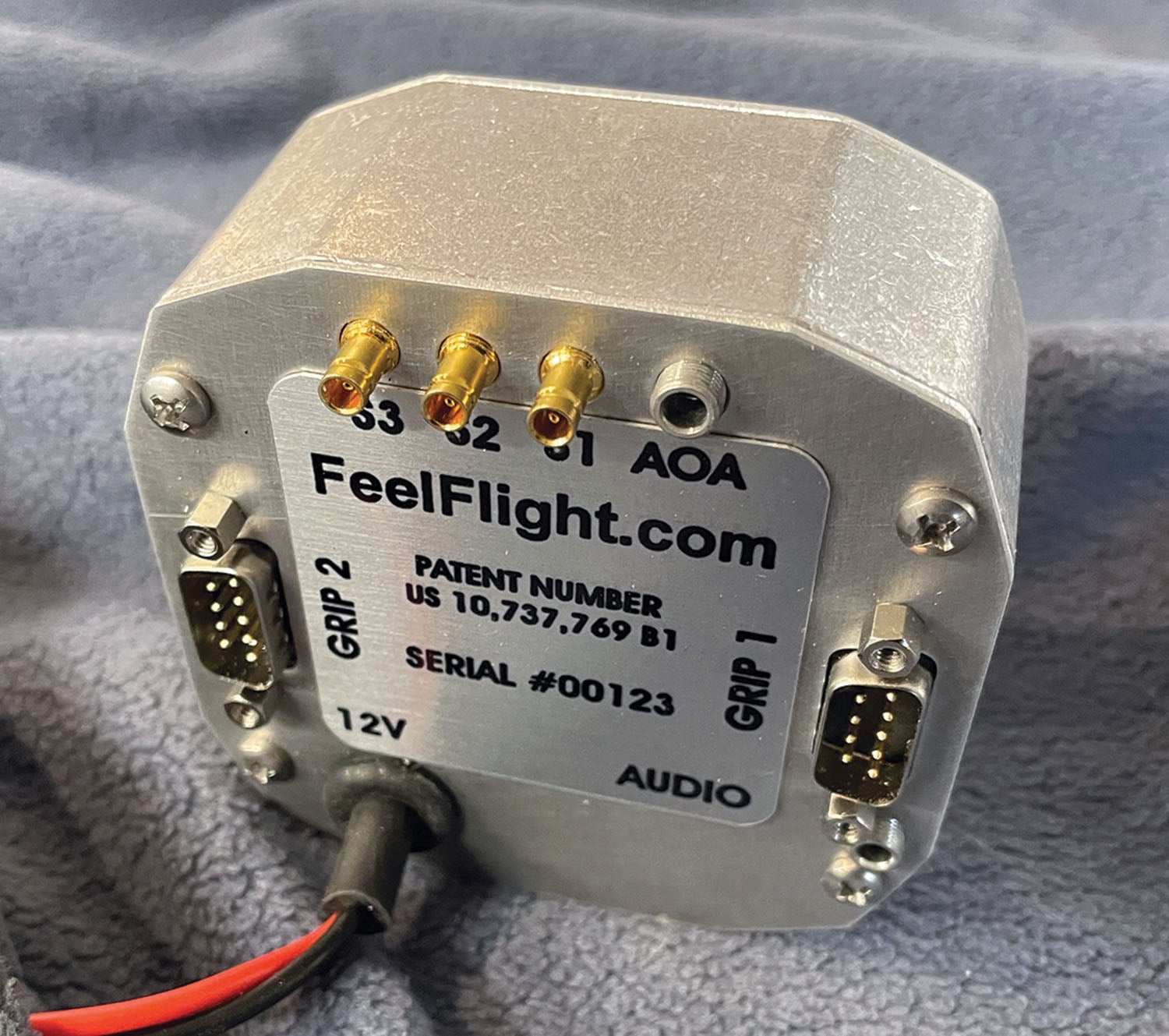

The back of the sensor unit, showing the connections for the grip(s), AoA sensor and audio (out). The three gold connections are for discrete switches from the grip to selected avionics functions.

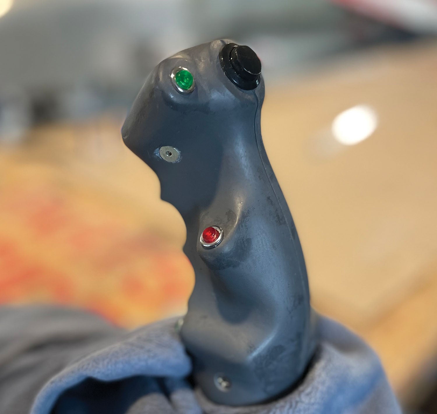

The FeelFlight grip comes with three discrete buttons (red and green here) that can be wired for PTT, autopilot or anything else the builder would like.
During all of this, the FeelFlight was also providing audio, as well as providing the lights that correspond to the thumpers inside the grip. Quite frankly, the audio was more likely to draw our attention to the display than the visual display was itself. Overall, the FeelFlight system performed exactly as it was supposed to, with accurate repetition at specific speeds and easy calibration. The fact that it worked for both flaps up and flaps down with a single calibration was a bonus.

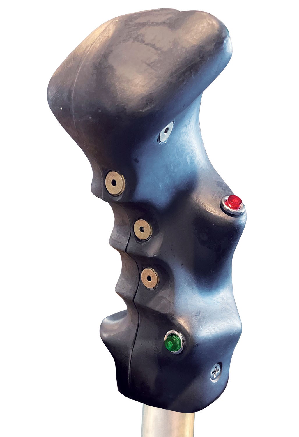

The FeelFlight grip has five “thumpers” or plungers that tap the fingers or thumb as necessary. They are the silver disks with the hole in the middle. Don’t worry—they are gentle taps and not sharp spikes!
The other thing to consider when comparing the FeelFlight to other systems is the nature of the warnings themselves. While most AoA displays or aural systems are digital representatives of analog measurements—they give a continuously variable indication of where you are in a range—the FeelFlight system is somewhat coarse, more digital in nature. If we take the old stall warning device in a certified airplane as a starting point, it is either on or off—close to the stall or not. When the horn goes off, you need to take action unless you are trying to stall. In a continuously variable system, you have a better idea of where you are in the AoA continuum, not just “close to the stall.” The FeelFlight system basically gives you three discrete points, which you can arbitrarily set wherever you want. Just before stall, Vy and Vx are the defaults. There is nothing preventing you from setting them as “stall, stall -5 knots, and stall-10 knots” if you want. But they are still fairly coarse indications of where you are in the range.
