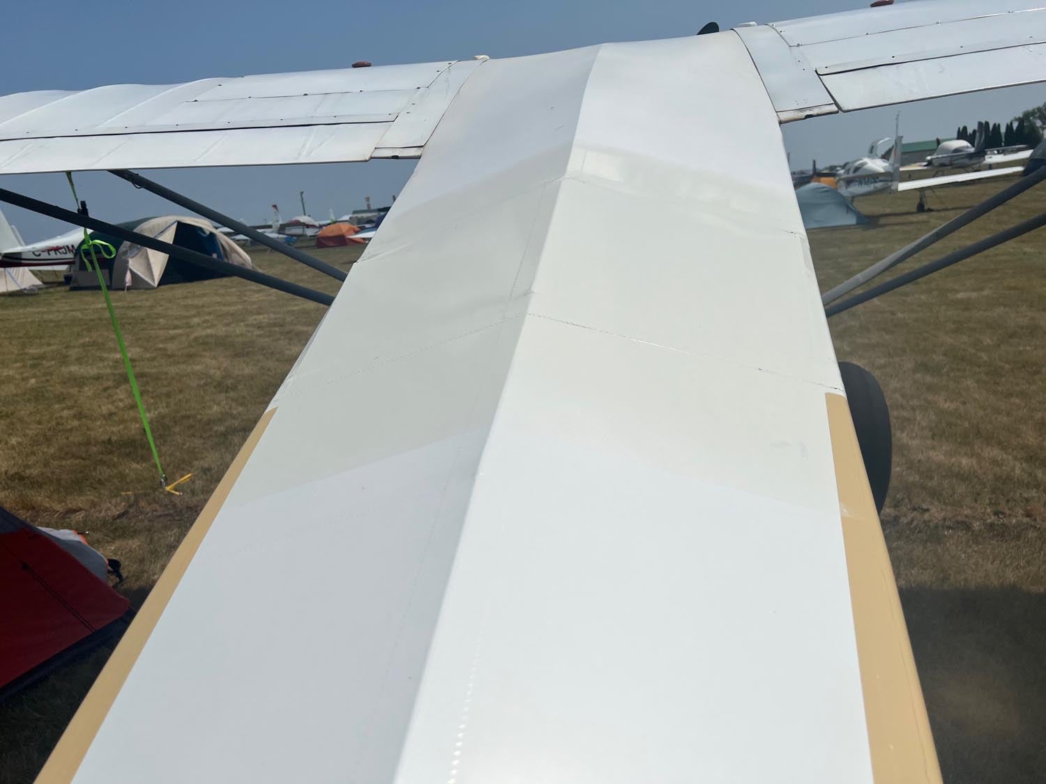

The original build had a scoop for the radiator on the top of the tailcone but was removed during the restoration. Thomas used the removed fabric to test its strength and determined that he only needed to put a patch on this one area, avoiding the expenses of re-covering and painting the plane during restoration.

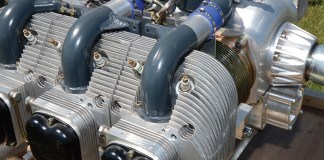

In 2019, Jim Thomas, a retired A&P about 40 miles away with a history of restoring old planes, learned about the orphaned airplane sitting in a dark hangar and became intrigued. He tracked down the family through a mutual friend and negotiated a purchase. He began the restoration by building a new engine mount and installing a Lycoming O-360 to replace the old automobile engine. The radiator came out. He also mounted a McCauley constant-speed prop. He kept the 32-foot wing span and even the original, Poly-Fiber covering and paint. One benefit of sitting in the dark for 19 years is a well-preserved fabric. The interior was stripped out and replaced with the lightest options he could find and in June 2020, the restoration was completed. After trying a couple different size wheels to replace its previous small wheels with wheel pants, he ultimately settled on 31” tundra tire. The plane now has a gross weight of 2200 lb, an empty weight of 1212 lb, and a fuel capacity of 36 gallons.
