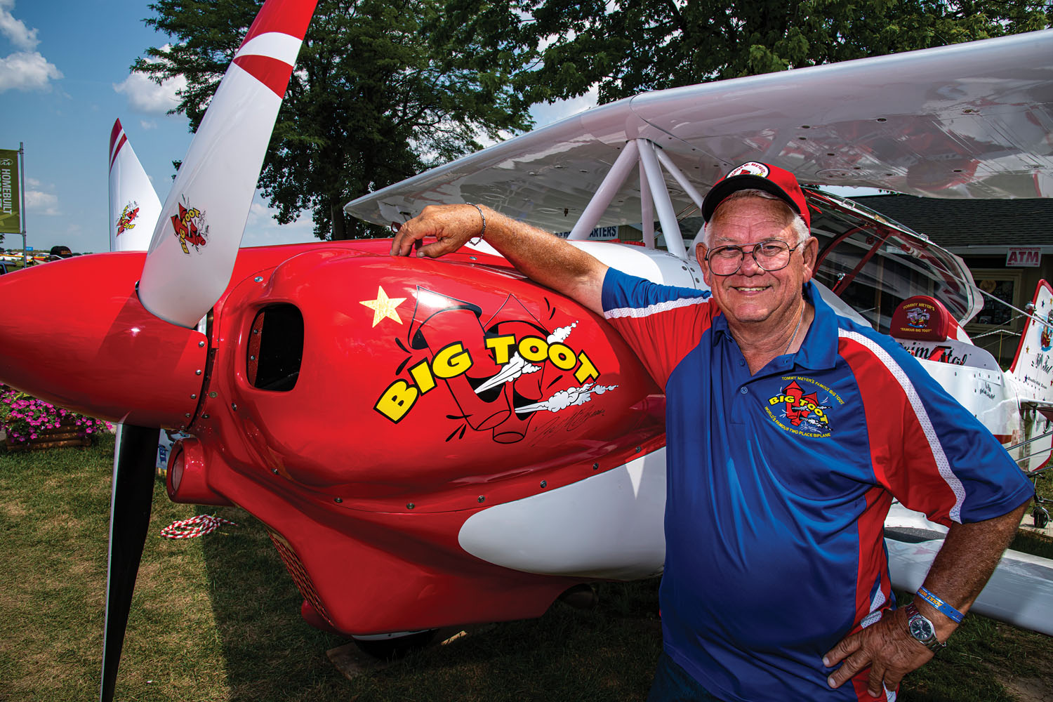

big toot N64LT 02The Big Toot Tommy Meyer‭ ‬built is not the two-seat‭ ‬biplane his father envisioned‭. ‬“It was going to be a side-by-side version of Little Toot‭, ‬with longer wings like a back-staggered Beech‭,‬”‭ ‬said Meyer‭. ‬His father‭, ‬George W‭. ‬Meyer‭, ‬“was going to use Monocoupe landing gear with the wheels turned backwards‭, ‬where the wheels were pointing forward‭, ‬and he was going to cover the wheels with GeeBee-type‭ ‬wheel pants‭. ‬He said it was going to be a Big Toot for Mom and Dad to go flying in‭.‬”‭ ‬
big toot N64LT 18
With lifelong dedication, Tommy Meyer built on his father’s legacy by adding a second seat to his father’s renowned design.

Big Toot made its first flight on June 6‭, ‬2018‭. ‬It didn’t go well‭. ‬The pilot said the‭ ‬Frise-type ailerons‭, ‬which counteract‭ ‬adverse yaw by dipping a leading edge‭ ‬into the slipstream below the wing’s‭ ‬surface‭, ‬fluttered at 130‭ ‬mph‭. ‬“I’m not going to lie to you‭,‬”‭ ‬said Meyer‭, ‬choking up‭, ‬“It just destroyed me‭. ‬I put the airplane away‭.‬”‭ ‬Kelly Swafford came over‭ ‬later‭, ‬Meyer said‭, ‬and told him‭ ‬“We’re going to fix the airplane‭.‬”‭ ‬
Having already made a number of‭ ‬parts for the airplane‭, ‬Swafford had‭ ‬many of Toot’s drawings‭, ‬Meyer said‭, ‬but not the ailerons‭. ‬“I sent him those drawings‭, ‬took the ailerons off‭, ‬and met him at his shop at 6‭ ‬o’clock the next morning to balance them in a fixture he’d made that included a sensitive scale‭.‬”‭ ‬
The aileron’s trailing edge weighed‭ ‬1.2‭ ‬pounds‭, ‬and Swafford started adding weight until they balanced‭, ‬Meyer said‭. ‬“Then Kelly did the math to figure the mass of the counterweight and CNCed a mold to cast counterweights that fit the aileron’s leading edge perfectly‭. ‬There’s 10‭ ‬pounds in each wing‭, ‬and we designed new aileron hinges to carry the load‭.‬”
After putting everything back together‭ ‬and doing another weight and balance‭, ‬Joe Flood‭, ‬who’s logged a lot of biplane‭ ‬time‭, ‬including Little Toot‭, ‬went flying‭. ‬For three days‭, ‬Flood flew‭, ‬filled‭ ‬up‭, ‬and flew again‭, ‬and the ailerons‭ ‬never wiggled‭. ‬“Talking on the radio‭, ‬I said I needed a top speed‭, ‬and Joe said I’m doing 210‭ ‬now‭, ‬and that’s where we redlined it‭.‬”‭ ‬
big toot N64LT 17
Pilot Joe Flood pulls Big Toot’s canopy closed before a test flight.
With a 40-hour Phase 1‭ ‬test time‭, ‬Gary Grubb of Hangar 10‭ ‬helped fly the tests‭, ‬said Meyer‭, ‬who doesn’t now fly for medical reasons‭. ‬Meeting at an‭ ‬outlying airport where he could fly‭ ‬some aerobatics‭, ‬Grubb said Meyer‭ ‬needed to change the redline to 230‭, ‬adding‭, ‬“This airplane is fixed‭, ‬and it’s made for hot dogging‭.‬”‭ ‬It is not a two-seat Pitts‭, ‬added Flood‭, ‬“but it has a respectable roll rate of 360°‭ ‬a second‭.‬”
With the ailerons balanced‭, ‬the‭ ‬only Phase 1‭ ‬squawks were oil pressure issue‭, ‬caused by a grounded wire‭, ‬and overly warm oil temperatures‭. ‬“Toot’s bug-eyes push a lot of air through the cowling‭, ‬and we didn’t have the oil cooler baffled right‭,‬”‭ ‬said Meyer‭. ‬“New baffles fixed that‭.‬”
Accompanied by Little Toot‭, ‬Big‭ ‬Toot‭ ‬made its EAA AirVenture Oshkosh‭ ‬debut in 2019‭. ‬Proudly parked by‭ ‬Homebuilt Headquarters‭, ‬few passersby did not stop for a closer look‭. ‬This‭ ‬included the homebuilt judges‭, ‬who‭ ‬awarded the 2018‭ ‬Meyer Special Big‭ ‬Toot‭, ‬N64LT‭, ‬an EAA Plans Champion Bronze Lindy‭.big toot N64LT 01
