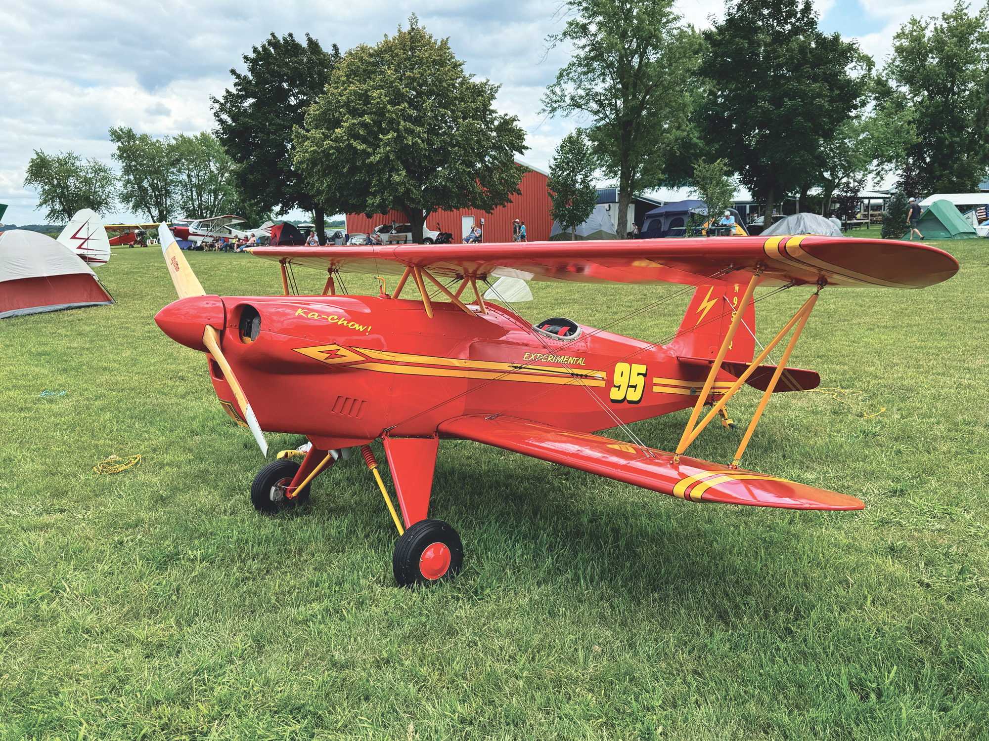

baby lakes 09
Sitting proudly, the Baby Lakes epitomizes the phrase “knee high to a grasshopper.” The scale isn’t fully evident until you’re standing beside this diminutive biplane.

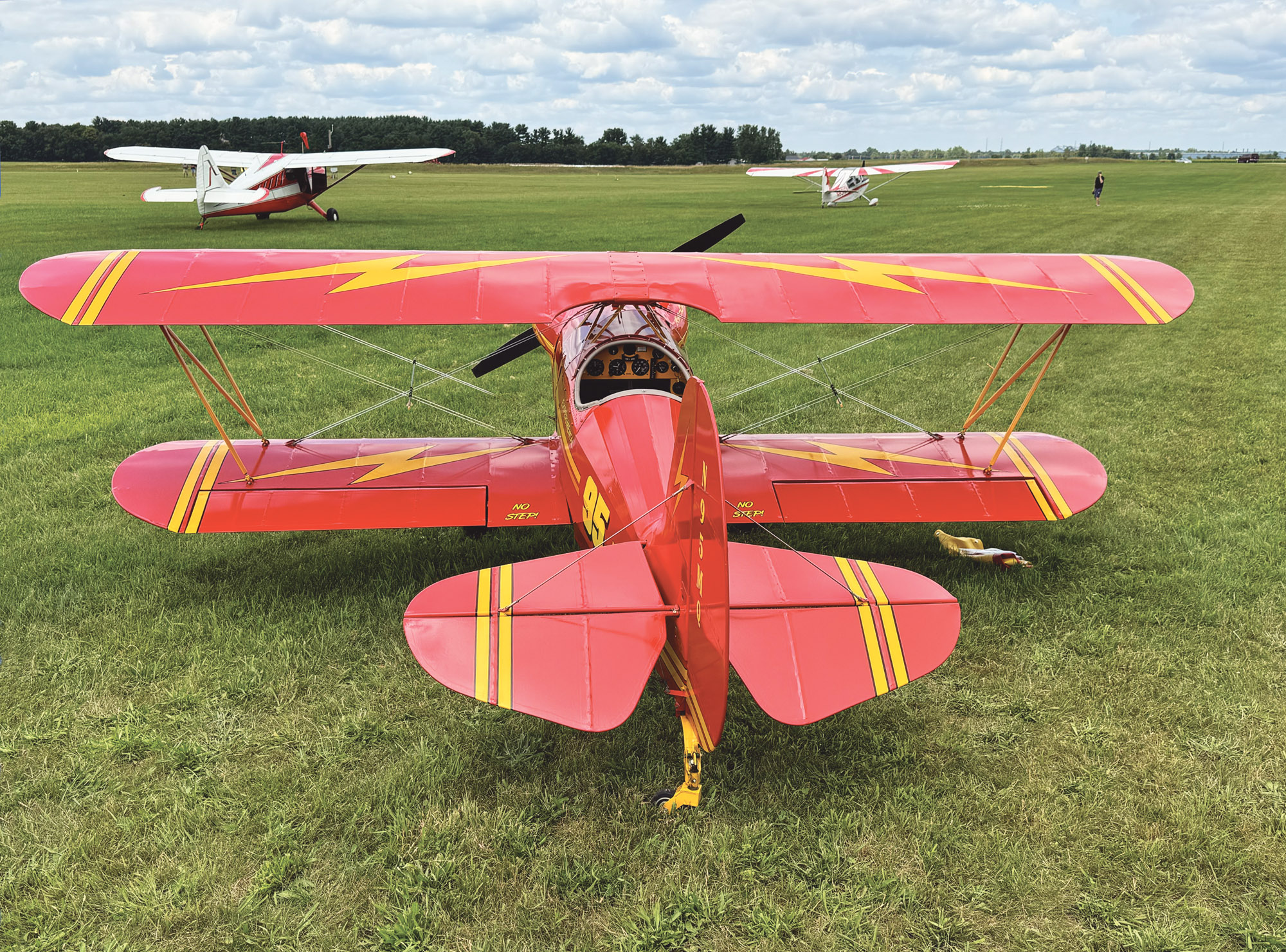

baby lakes 04
Is it an actual airplane or a large model? Depending on the angle, it can be hard to tell. Note the lower-wing-only ailerons.

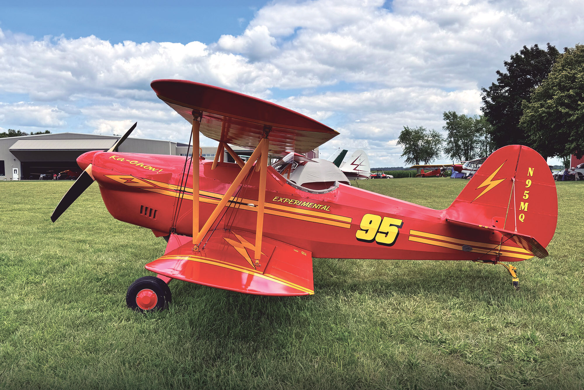

baby lakes 07
The “Ka-Chow!” Lightning McQueen theme is a big hit with children.
As the Baby Lakes got close to flying, there were questions as to how Shad should finish it. He already had some leftover red and yellow paint, which his 5-year-old son declared to be “Lightning McQueen colors,” from the Disney/Pixar movie Cars. Given its overall toy-like appearance it was a natural conclusion and the paint scheme was born. Continuing the theme were the “Ka-Chow!” and lightning-bolt accents. But the true pièce de résistance is the Sky Slicer stickers on the propeller. For those not in the know, this is a nod to the Disney/Pixar Planes movie franchise, after the villain Ripslinger’s Sky Slicer Mark V prop. Children love this diminutive “Disney characters come to life” at airshows and can’t get enough of it.

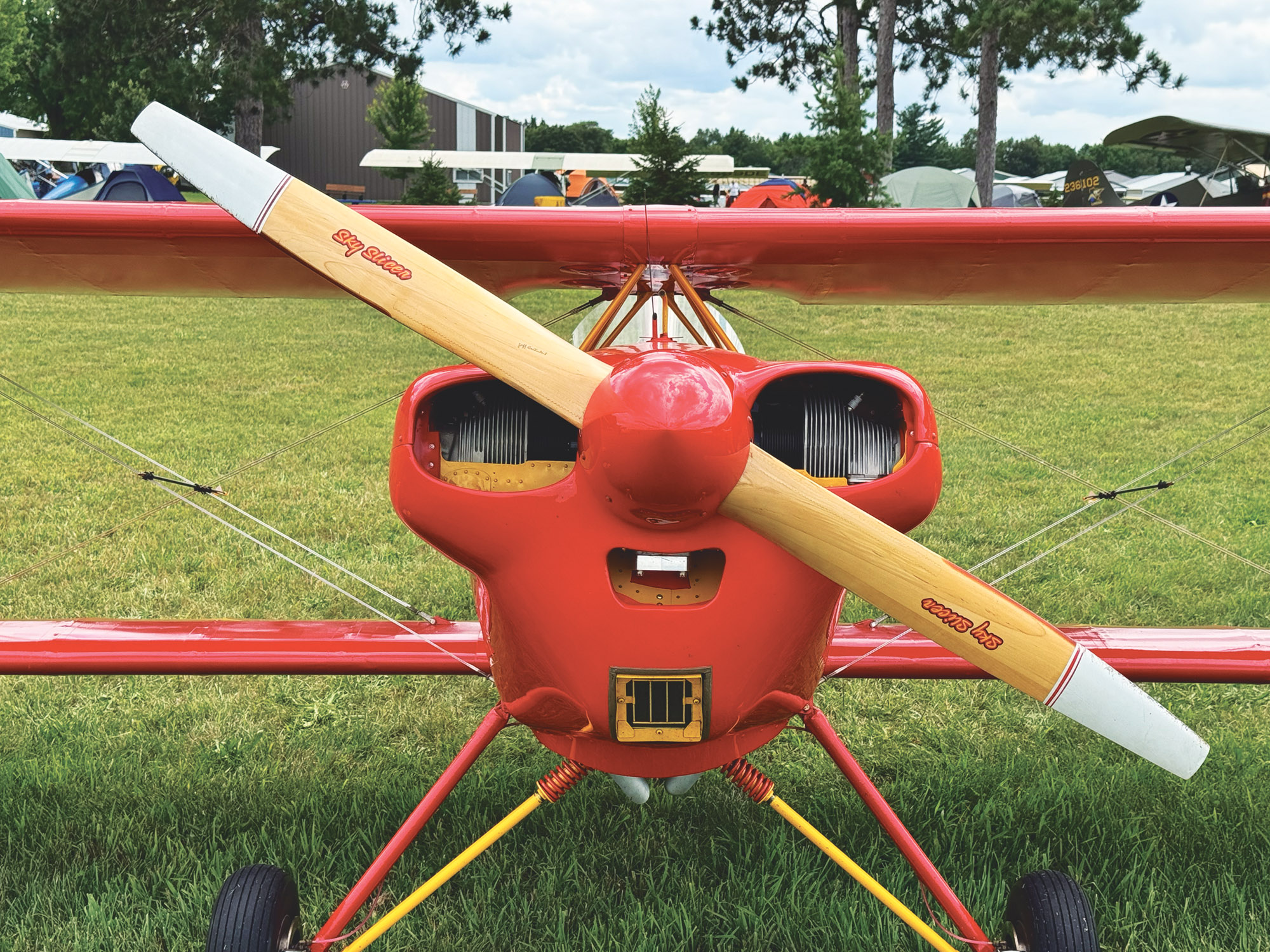

baby lakes 08 1
The “Sky Slicer” propeller completes the Disney theme. Behind it, a Continental A-85 four-banger provides good performance on not much gas.

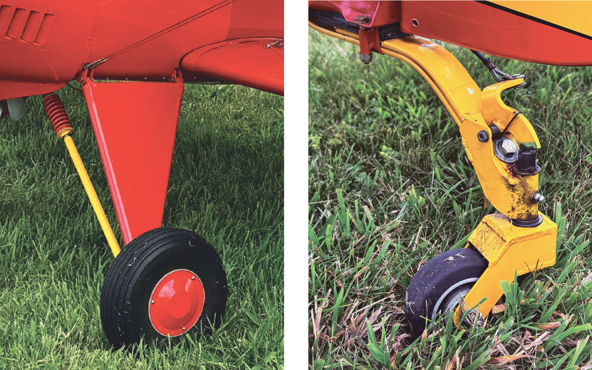

Over the last several long winters, modifications were made to extend the gear legs and Shad created a locking tailwheel. The tailwheel setup allowed for more clearance as well as improved handling. Never one to waste anything, Shad crafted the locking lever from a worn-out gear latch from a Learjet.
Originally this Baby was powered by an A-65, with 8:1 pistons, which had it cruising around at around 85 mph for its first 160 hours of flight time. The engine was then upgraded to an A-85 from another Baby Lakes, which significantly increased the performance. However, this modification revealed a previously unknown issue. The A-65 has CHT sensors on the top plugs only. With the A-85 engine, the CHT sensors were relocated to the bottom of the cylinders, which ultimately revealed a cooling issue. Of course more modifications were required and improvements in the cooling features resulted in CHT numbers dropping from 425° F down to 350°. With the larger engine, cruise speeds increased to 105-110 mph. This is about 10 mph slower than other comparable Baby Lakes.

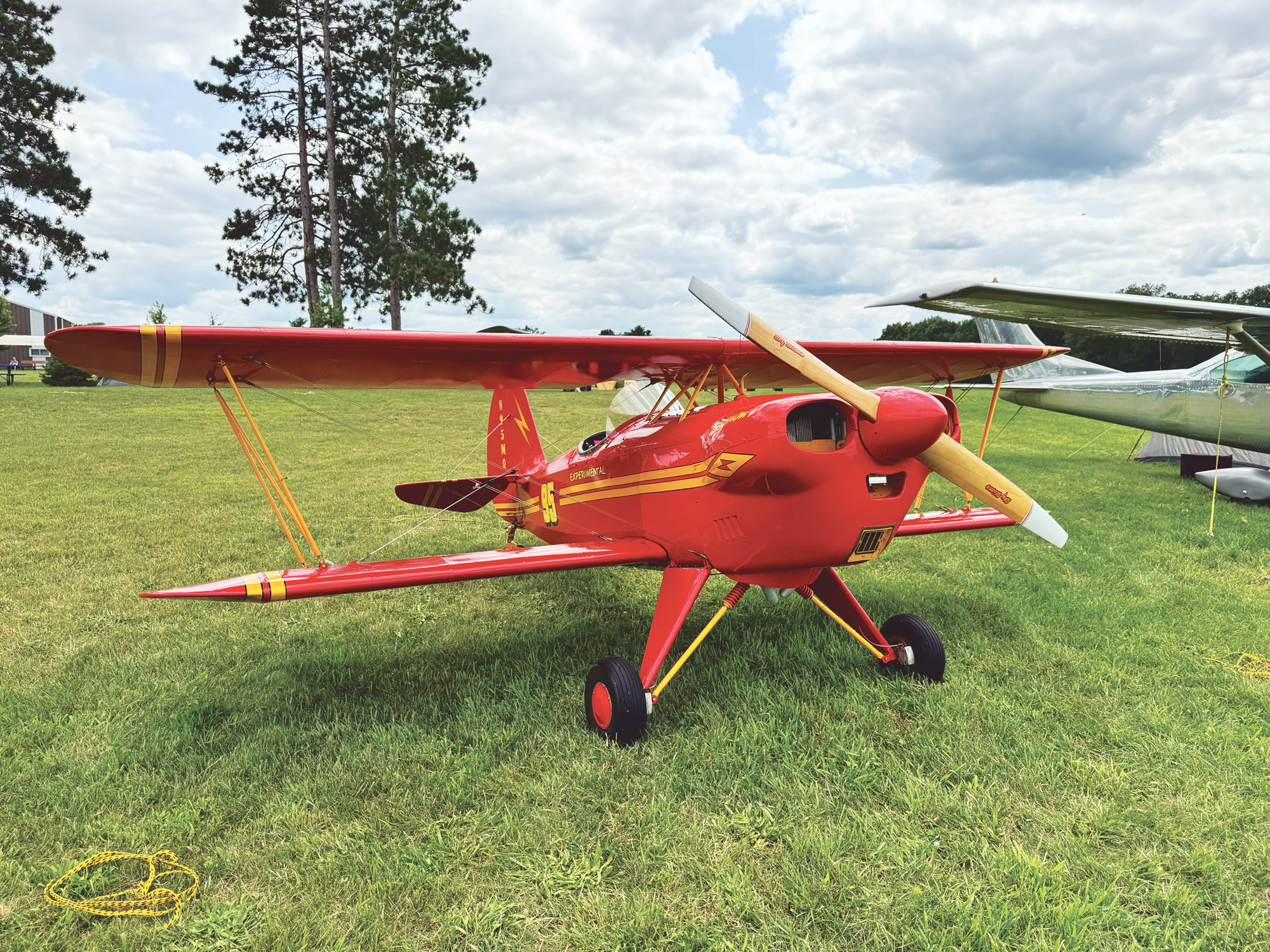

baby lakes 10
The updated landing gear and tailwheel increase the clearance and improve ground handling. Small mounds are no longer a challenge.

From a prior interview with Harvey Swack it was related that one of the reasons the airplane has such short gear is that its ground angle is several degrees short of the stall angle. So it needs to be flown onto the ground. That makes it look pretty flat on the ground unless the gear is extended, as Shad has done with this example. Improving the gear legs by adding 4 inches was done in this case purely for aesthetics. However, it brings the ground angle closer to stall and theoretically should improve landing characteristics in ground effect. Shad hasn’t really noticed much difference, though it does bounce “like a pogo stick with springs” unless he touches down smoothly.

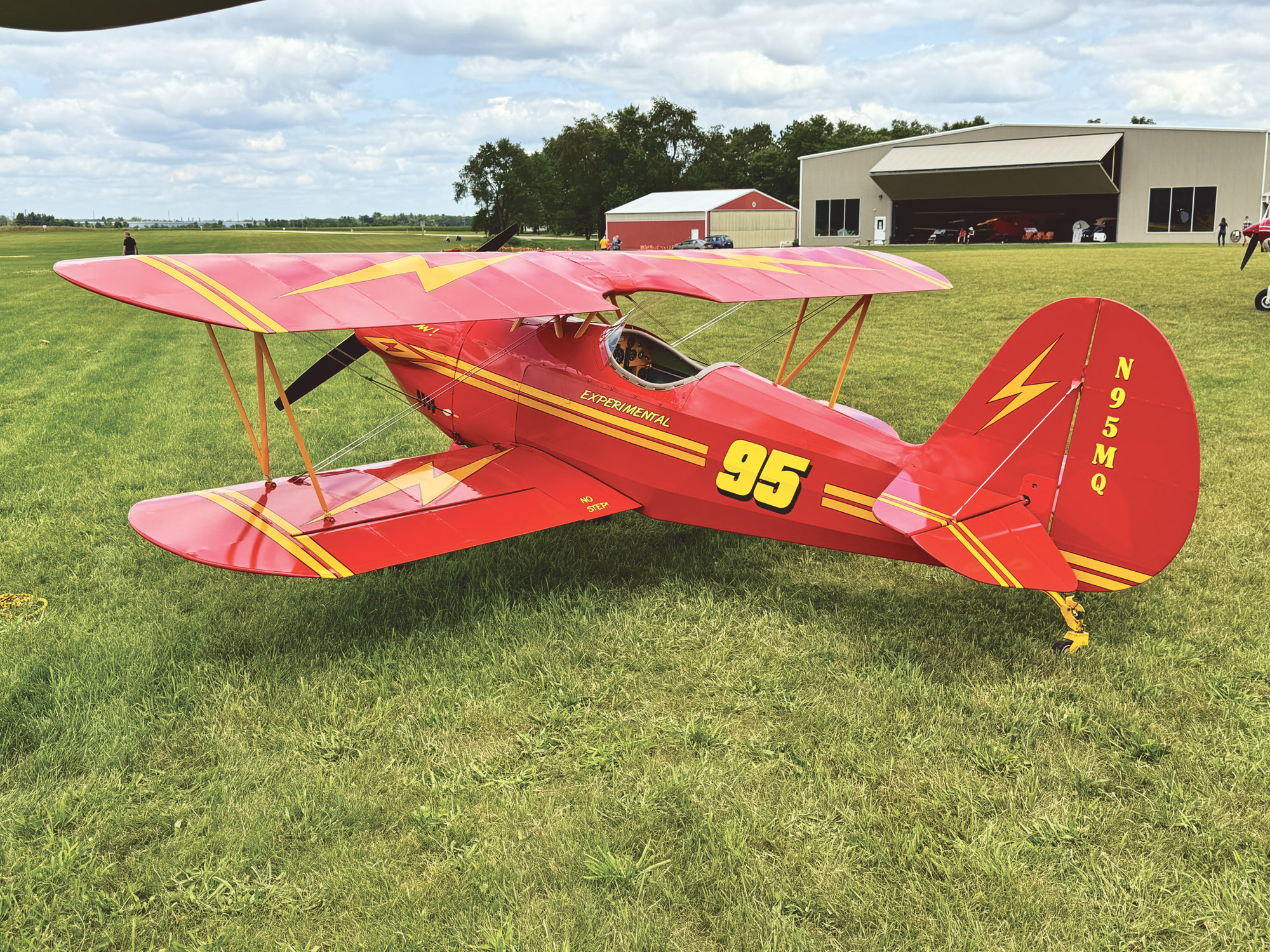

baby lakes 02
The bright red-and-yellow paint scheme makes the Baby Lakes really show off its clean lines and compact charms. Aside from scale, it’s actually a very conventional tube-and-fabric design.
