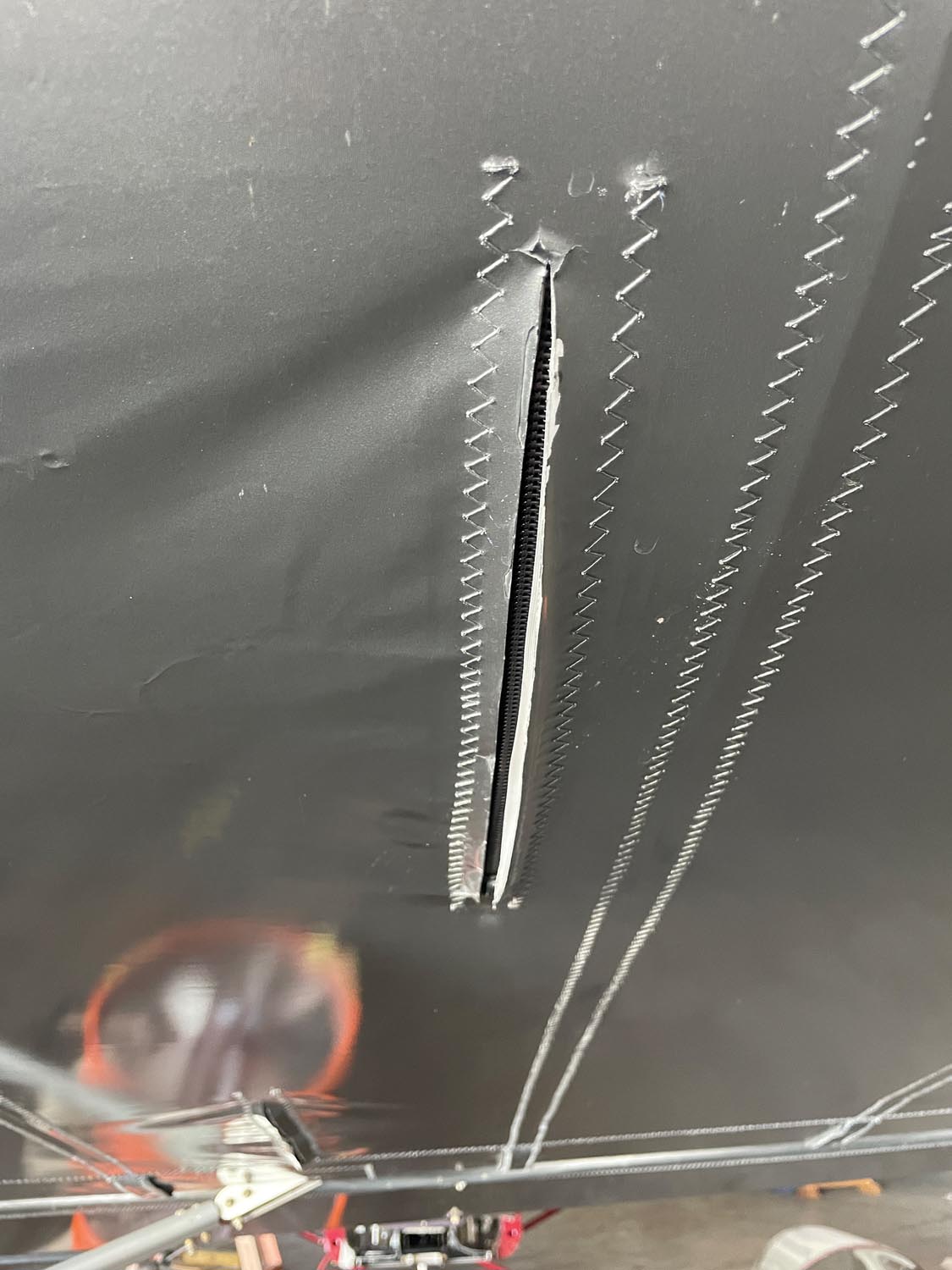

Zippers in the wing covering make inspection and assembly easy.
