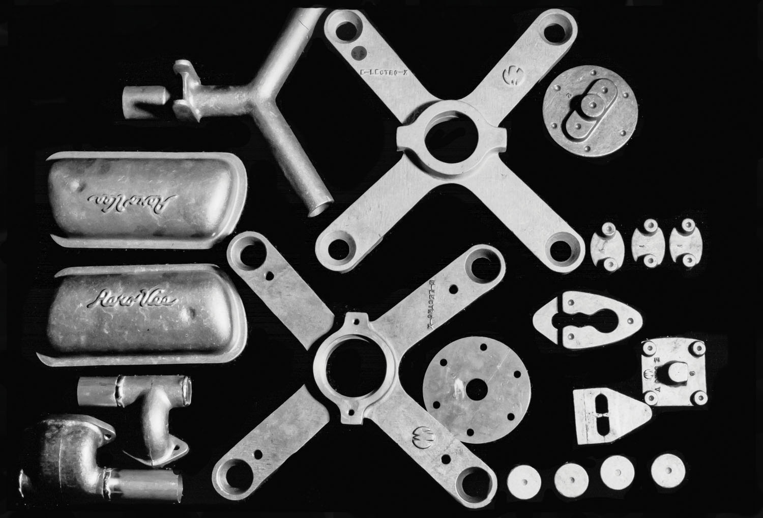

AeroVee 20 Kit
The AeroVee is only offered as a kit. It includes all of the parts necessary to assemble the engine.

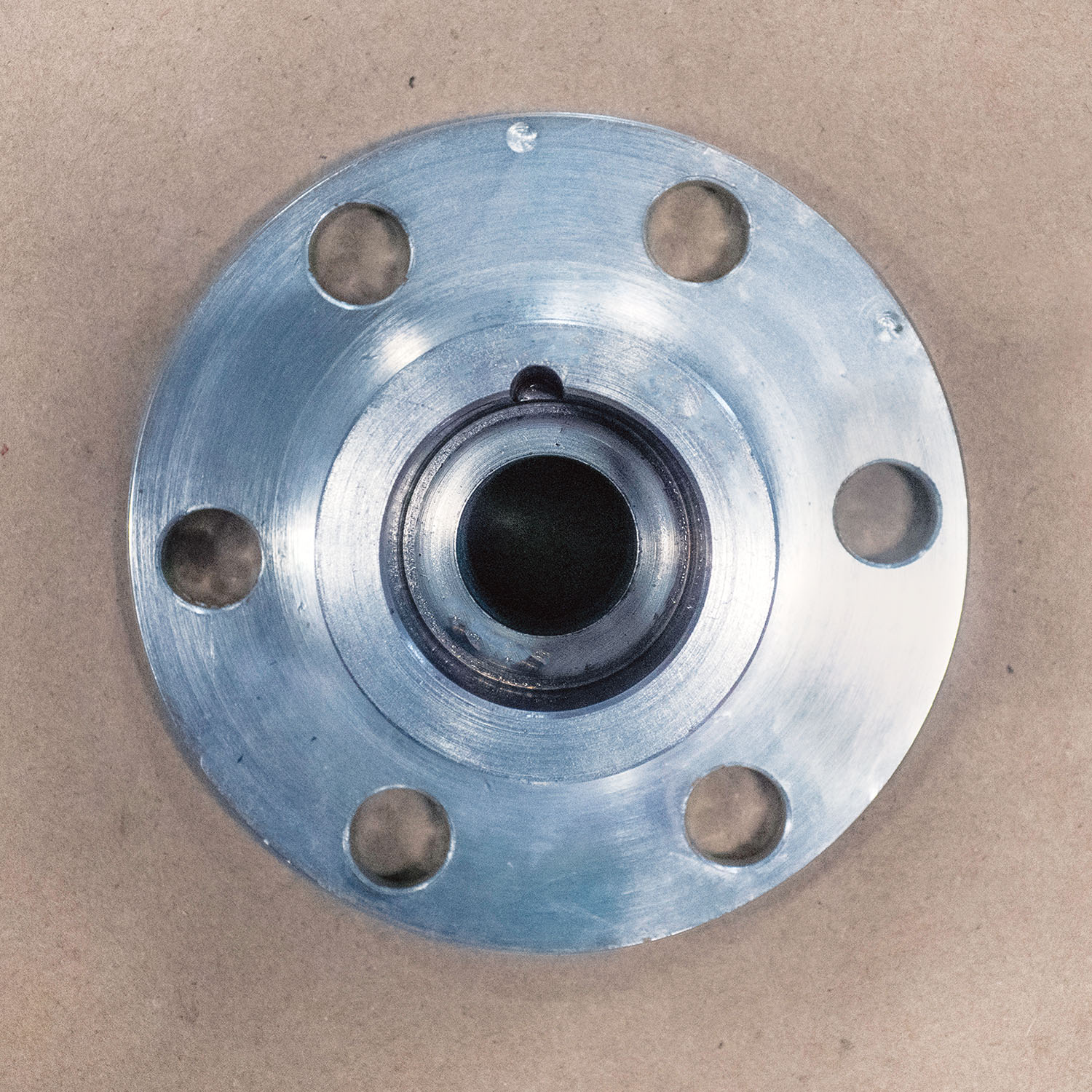

AeroVee 20 Prop Hub
The shrink-fit prop hub addressed hub cracking failures of the past with an increased wall thickness and a round keyway. Those features are common to all AeroConversions AeroVees, but the zinc-plated prop hub shown here indicates it is a 2.1 hub. Prior to the 2.1, prop hubs were black.
Crankshaft and prop hub: The crankshaft and prop hub are key to converting combustion into thrust. Here, too, Monnett employed lessons learned in the past. A shrink-fit prop hub allowed the use of an off-the-shelf crankshaft, but shrink-fit hubs of yore could crack and depart the crank, divorcing combustion from thrust with negative results. Monnett addressed this on the AeroVee 2180 by thickening the wall of the prop hub and keying it to the crank with a round, rather than square, key, thereby eliminating sharp corners in the hub’s keyway, which was the source of most prop hub failures.
Though the use of an off-the-shelf crank made sense economically, it necessitated using two vestigial Beetle parts: the distributor drive gear and racer spacer. Neither part was needed for the distributor-less AeroVee. Like the prop hub and cam timing gear, those parts had to be shrunk-fit to the crank. That proved problematic for some builders. AeroConversions announced a change in May 2008: “Thanks to burgeoning sales, the AeroVee 2.1 features a purpose-built custom crankshaft that has a larger diameter and longer prop hub interface. This new design also eliminates the distributor drive gear and the racer spacer, making for an easier assembly.” As noted in the press release, the new crankshaft/hub assembly ushered in a new engine designation, the AeroVee 2.1.
