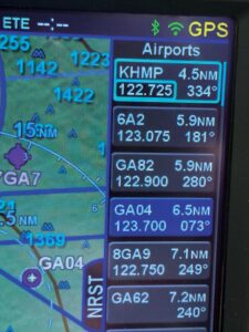

Air, fuel, spark, right? Aviate first! Having just set a course to Alexander Memorial, I knew exactly where I was, and I wasn’t real excited about it. I was pretty much equidistant from three airports, one 90 degrees off the left, one 90 degrees off the right, and home base right behind me. Griffin (6A2), off to the left, was heavily populated with shopping areas, a heavily traveled highway, and not many open fields between me and it. Henry County (KHMP), off to the right, had some open fields, including one grass runway that had been plowed under. All of my tools were, of course, at home base, and it was a very strong urge to turn back to there. However, there were stores and electrical wires very close to the final approach, making a short landing very dicey, so I stopped the right turn with Henry County on the nose and never waivered from that decision. The VSI was showing 400 fpm down, and I figured I could make it.

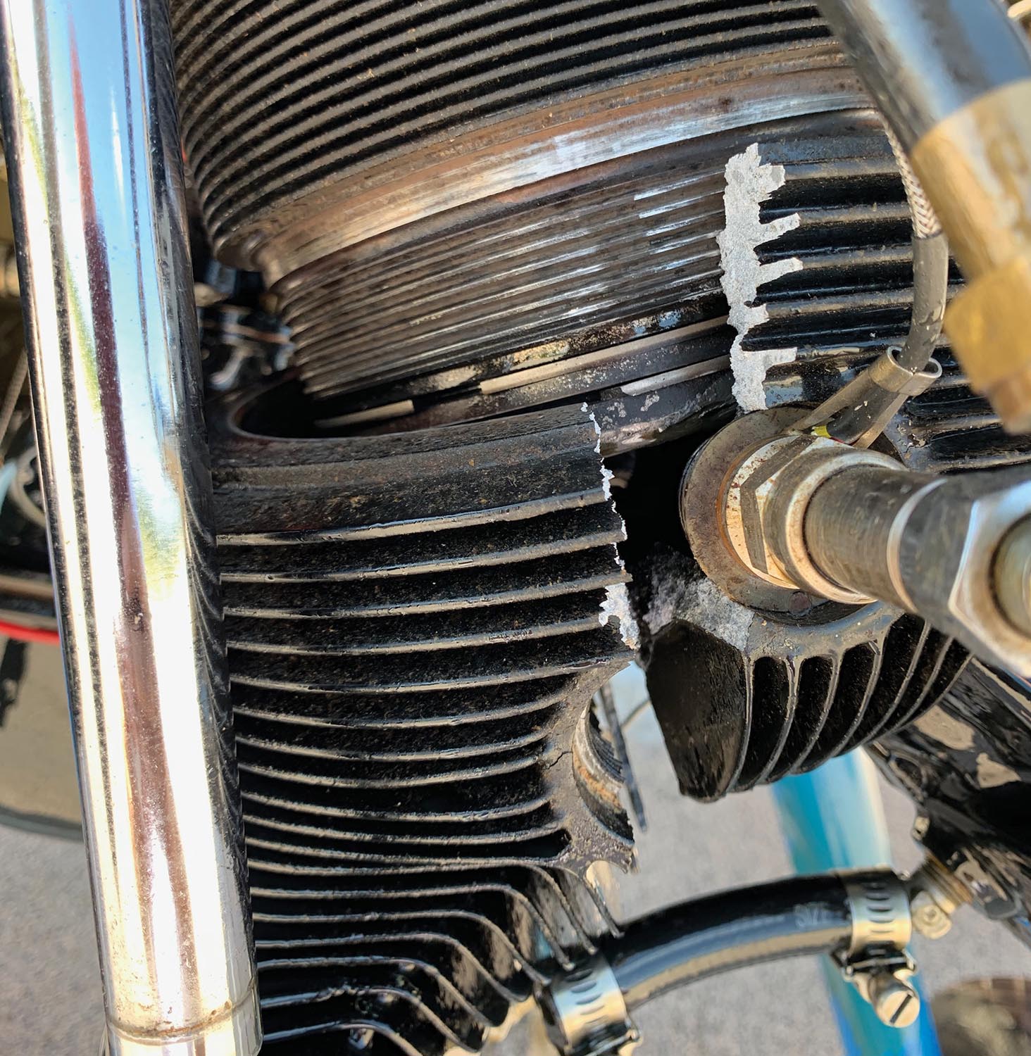

broken cylinder
Once I picked myself up and walked around to the front of the aircraft, I noticed the broken cylinder head on number 5 cylinder.
The Stearman is a very high-drag airplane. It has 15 more hp than my RV-10, weighs almost 800 pounds less at gross weight, yet it flies about 65 knots slower. There is a joke about throwing a brick out of the Stearman if you have an engine failure to help locate your landing spot. I wasn’t quite in dire straits yet, as the engine was making some power, so I concentrated on managing airspeed and keeping the VSI at 400 fpm. I estimated the airport at 4 miles, and some quick head math told me I should make it if the engine didn’t seize. I assure you the oil pressure was constantly in my scan until short final.

Once I removed the engine, Carol and I drove it to Air Repair in Mississippi, where the airplane and engine were built by Pete Jones and his team. Pete also holds the STC for the Jacobs engine and was just as curious as I was as to what precipitated the failure, and he even said I could watch the teardown. Boy that teardown was a revelation! None of the cylinders could be removed, and finally one was cut off with a torch. The connecting rod for number 5 cylinder looked mangled beyond belief, and the internal damage to the engine from all of the pieces floundering around pretty much destroyed the engine. There is some speculation that in the past (I am the third owner) there was a hydraulic lock on cylinder 5. Jacobs engines have been known to go to TBO with bent connecting rods. I’m upset with myself for not having this engine on an oil analysis program, as it probably would have caught it. I’ve always had my RVs on oil analysis programs, but somehow hadn’t considered the Stearman. You can bet the new engine will be on the program.
