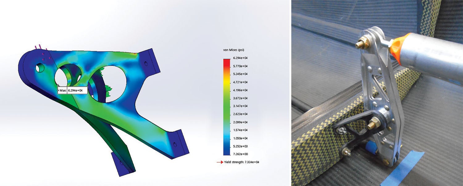

Traditionally, homebuilders have used basic hand calculations, along with a healthy margin of safety, to design airplane structures. These days we have access to user-friendly finite element analysis software such as that found in SolidWorks (available free to EAA members) to simulate stresses in parts. But without testing, you won’t know if these analyses are accurate for anything but the simplest of parts. So empirical testing helps validate your design methodology—whether it be hand calcs or FEA—and thus helps you optimize current parts as well as guide future design methodology.
fea
Simplified FEA analysis of the prototype bracket using SolidWorks Simulation, which is available free with your EAA membership (above). FEA is very much subject to GIGO (garbage in, garbage out). Here it is simply being used to identify potential stress risers in the preliminary design. The carbon bracket temporarily installed in the SR-1 (right).
