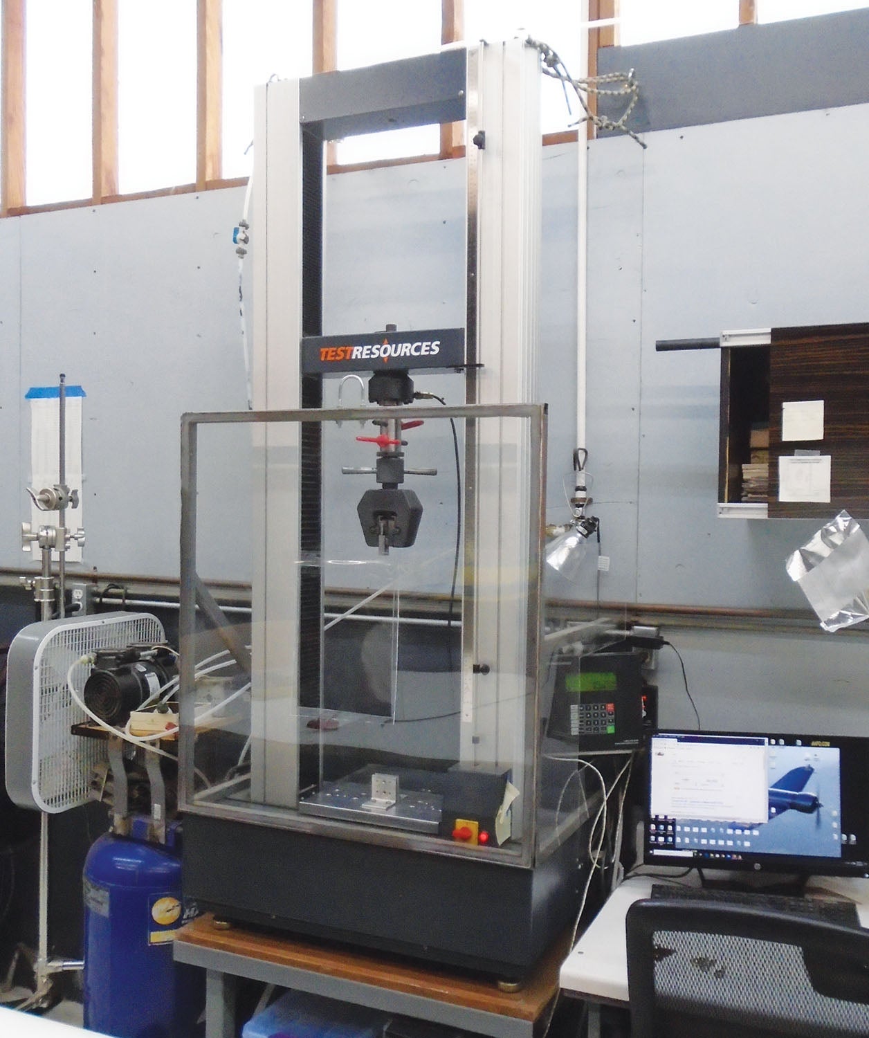

A UTM is a mechanical device that imparts a tensile or compressive load from a crossbar that is raised and lowered by a pair of hydraulic or electromechanical jackscrews. This crossbar is fitted with a load cell, a device that measures force—there’s one inside every digital scale in your shop or house. The UTM software then records this load, as well as the position of the crossbar and the time. Fancier machines may also keep track of things like the number of cycles and elongation of the test piece, known as strain. A variety of parameters can be set when performing a test, such as the rate of speed of the crossbar, maximum allowable load, data acquisition rate and the ability to perform cyclic testing.
material testing 01
The UTM used for the SR-1 Project (above). Note the Plexiglas blast shield around the test area—tests to failure can result in carbon fiber splinters embedding themselves in objects many feet away!
There are a number of companies that make UTMs, but Instron is probably the most well-known, and so you will sometimes hear UTMs eponymously called “Instrons” even though they were manufactured by someone else. Prices are similar to that of a new car. Which new car you ask? Well, you can find new cars for $15,000, and you can find new cars for a heckuva lot more. UTMs are similar, and the more features and higher load capability they have, the more expensive they are. Used units can also be found on eBay and Craigslist, although be sure to find out if the software is still supported.

In addition to the UTM, fixtures are required as an interface between the UTM and the coupon or part to be tested. There are literally thousands of test configurations used by engineers to qualify materials, components and finished parts, ranging from metal and plastics to composites and concrete. However, the four basic tests are tensile, compressive, shear and bending strength.
material testing 05
A pair of grips are used to apply tensile force to a bolt (left). A fixture for testing compressive strength (center). The compression fixture disassembled (right). A coupon is placed between the halves on the textured surface, which grips the coupon when the halves are tightened together. The top and bottom halves of the fixture slide freely up and down the steel rods on linear bearings to allow compression.
Tensile tests are the easiest to conduct since they basically boil down to grabbing onto something and pulling it apart. Accurate results require that the grips not induce any kind of side loads on the test piece. This is achieved by using some form of universal joint—for example a rod end—at each end of the test piece. Note that in the photo above, the fixture used to hold the bolt does not allow the bolt to do this, so this test, while “quick and dirty,” had limited applicability. In my experience, the greatest amount of time conducting tests is usually spent creating fixtures and setups that ensure the correct application of the load.
Compression tests, on the other hand, are generally the most difficult as the load must be applied perfectly along the axis of the coupon. Unfortunately, both the coupon and the fixtures have a tendency to want to buckle or shift sideways under any appreciable load. As can be seen in the photo of the compression test fixture above, a number of pins, bolts and rods are required to ensure the utmost stability in all axes as load is applied. Still, the coupon itself has a tendency to fail not in pure compression, but rather in non-compressive failure modes like buckling or shearing. For this reason, compression testing is less common.
