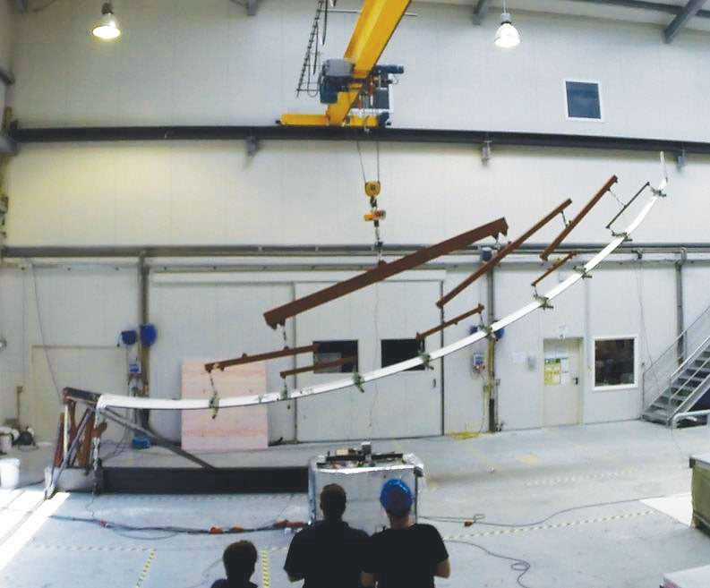

Jonker Sailplanes used a whiffle tree to certify this sailplane wing. (Photo: Courtesy of Jonker Sailplanes)

The goal of static wing testing is to apply a load equal to the wing design limit load to ensure that the wing structure is strong enough to handle these loads in actual flight (see sidebar for explanation on load terminology). The load is usually applied in increasing increments of 1 G. This allows the designer to know the actual load at failure if the wing fails before reaching limit load and to modify the design accordingly.
Aerospace companies often use a device called a whiffle tree, which allows the load to be distributed evenly over the entire wing, with force applied through one or more cables at the base of the inverted tree; synchronized hydraulic actuators are also used. For homebuilders, it’s easier to simply use bags of sand or concrete to simulate the load.
