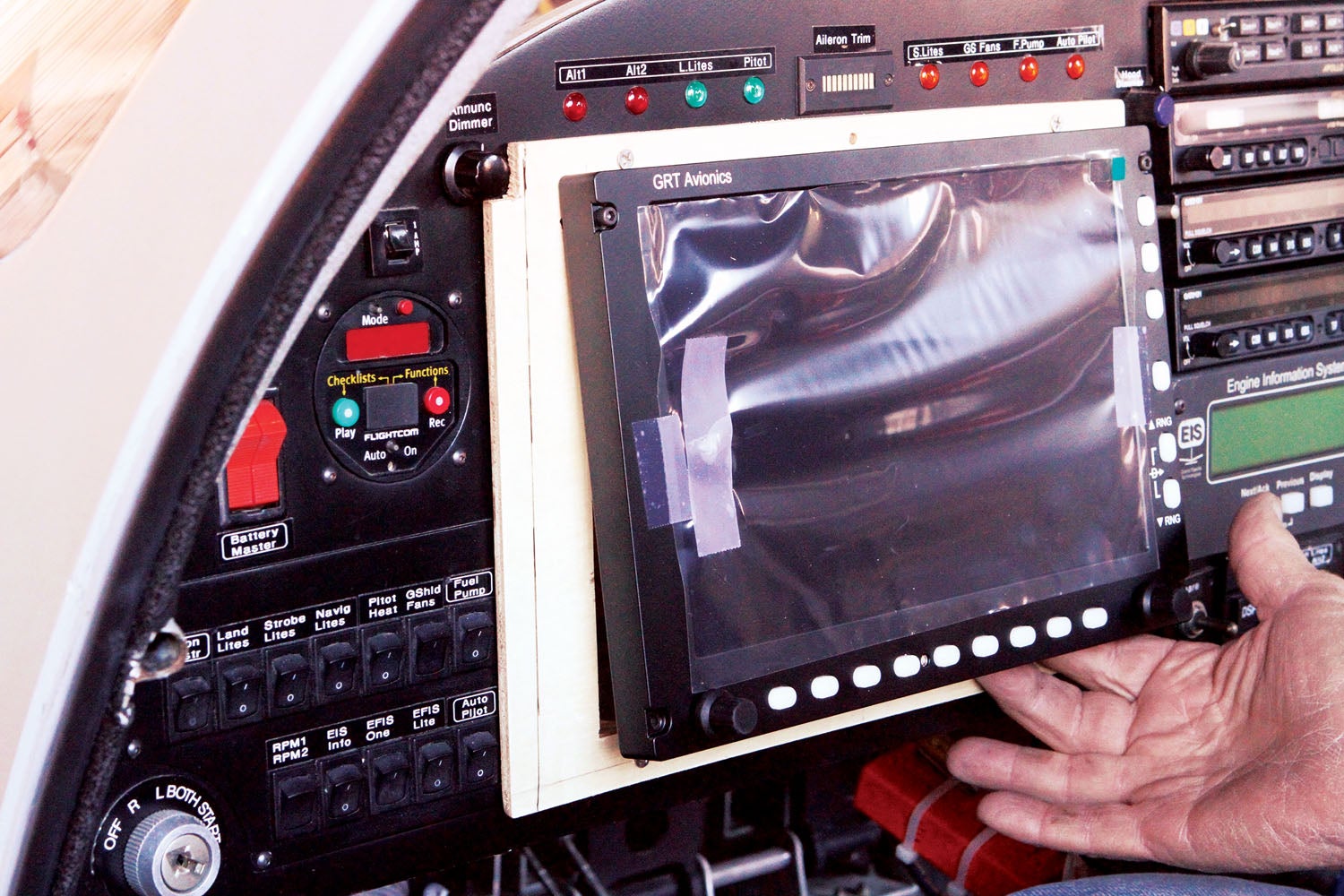

With the top of the GRT Avionics Horizon display loosely attached to the plywood mock-up, Kevin varied the spacing at the bottom to determine the “just right” angle for viewing.

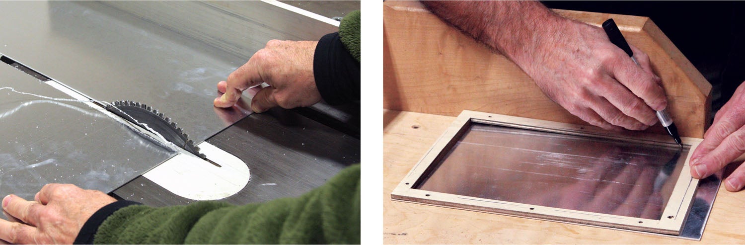

A table saw with a Tenryu Alumi-Cut blade was used to trim the 0.062-inch-thick aluminum sheet to size (left). A fine-tip Markal paint marker was used to transfer the plywood pattern to the aluminum (right).

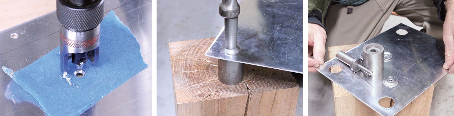

A micro-stop countersink with a 90° cutter and 0.150-inch pilot was used to countersink the mounting holes (left). A piece of scrap from the same material as the workpiece was used to fine tune the counterbore depth. A knockout punch (center) was used to make holes at the corners of the opening to facilitate sawing (right).

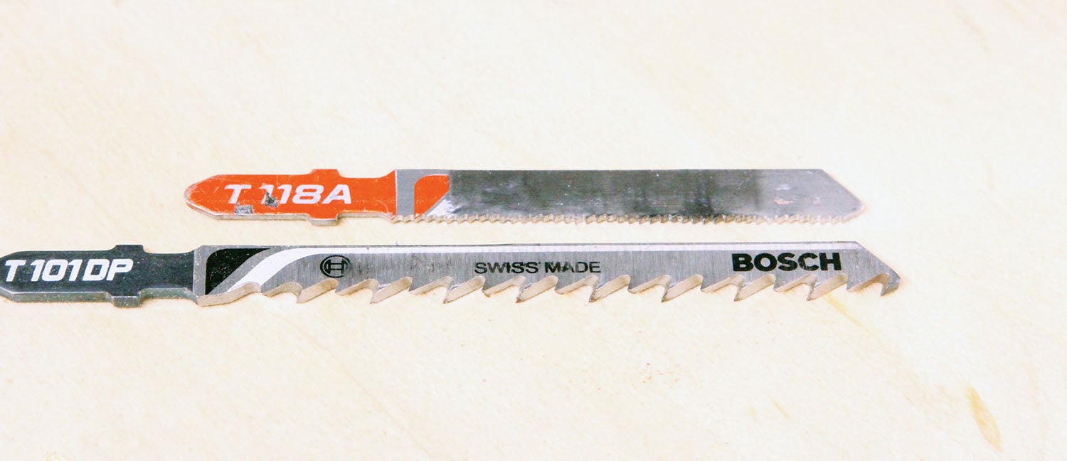

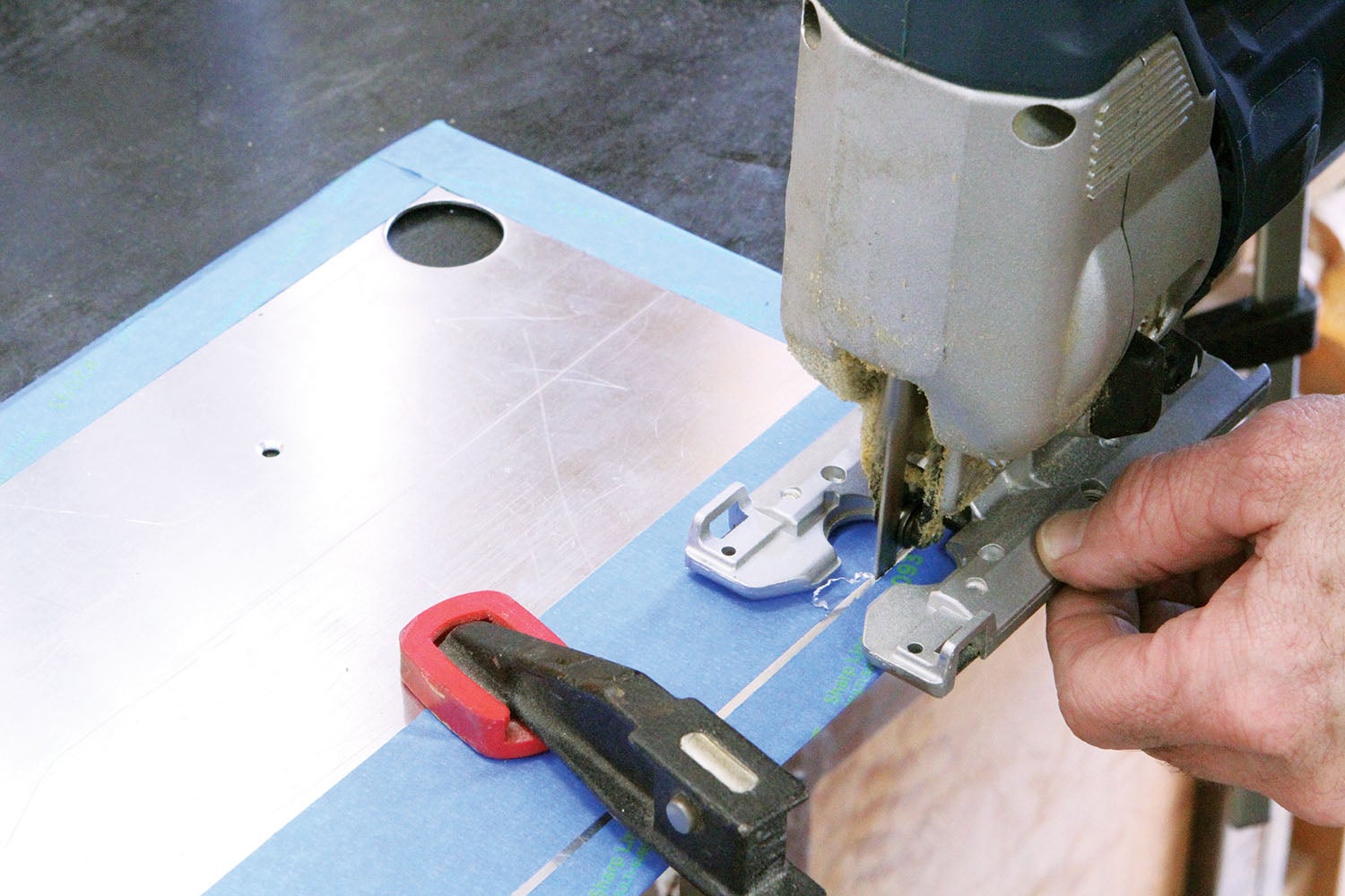

Using a jigsaw on thin aluminum requires a fine-tooth blade. The top example is a 24 teeth per inch (TPI) metal-cutting blade. The bottom is a 6 TPI blade for wood.
screen angle wedge 03
With the edge overhanging the bench, a jigsaw with a fine-tooth metal-cutting blade zipped through the aluminum like butter.

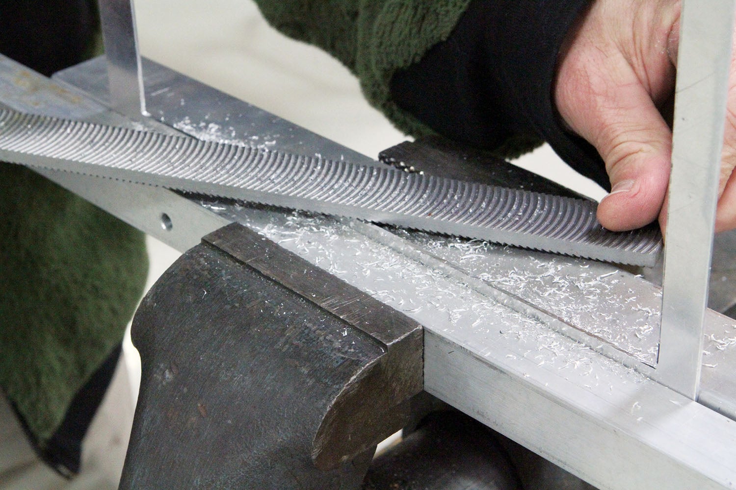

A curved-tooth mill file was used to true up the rough-sawn edge. Note the display frame was sandwiched between two longer pieces of aluminum to extend the vise and protect the aluminum workpiece.
The twist to this story was that Kevin wanted the display to be angled up slightly to his line of sight. To determine that angle, we used some extra-long 6-32 screws to loosely hold the display onto the plywood mock-up while Kevin varied the angle until it was just right, which turned out to be 10°. The GRT installation manual provided details on how to calibrate the gyro sensors to compensate for the display being mounted at various angles, so we were good to go.

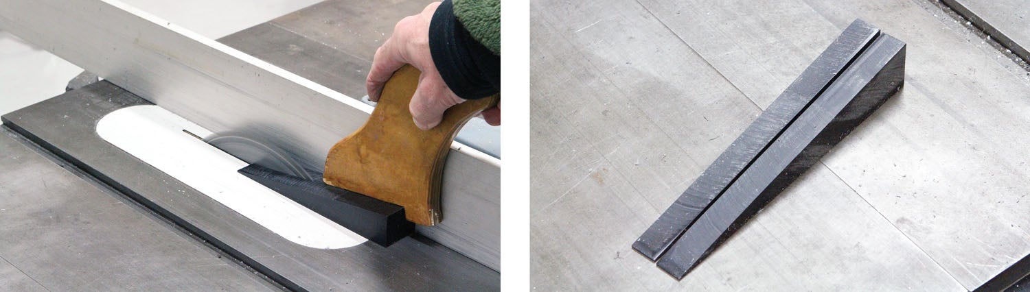

Identical wedges were created by splitting the blank on the table saw. Note the use of the push block.

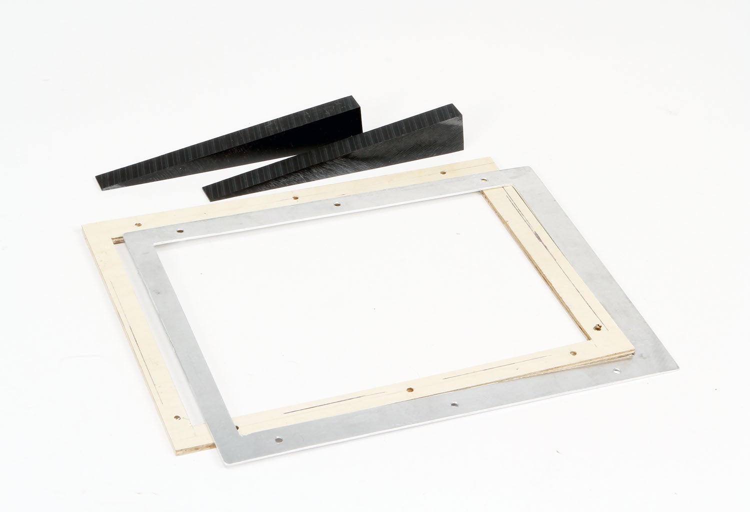

Back at the shop, I used the plywood mock-up to lay out the outline, the opening for the display and the attachment points onto a fresh sheet of 0.063-inch aluminum. To achieve the angle Kevin wanted, I decided to make wedges out of black Delrin plastic. Delrin is a hard plastic that machines well and can be drilled and tapped for standard screw threads. I used 6-32 flat head screws to fix the wedges to the adapter and then, with the GRT display in position, used a transfer punch to mark the wedges for the GRT mounting screws.
screen angle wedge 05
The plywood mock-up begat a precise fitting aluminum adapter plate. The fixing of the wedges to the adapter and the panel to the wedges was done at the hangar during the final fit-up.
To cut the opening for the GRT display, I used a knock-out punch to make holes in each corner and then clamped the workpiece to the edge of my bench and cut the four sides for the opening using a Bosch jigsaw with a fine-tooth metal-cutting blade. The resulting edge was a bit ragged but cleaned up quickly and easily using a mill file with a curved-tooth profile. Using a jigsaw and a hand file may seem a bit low-tech. I could have used the milling machine, but the thin material and large size made it a good candidate for simply clamping it to the bench and getting after it with the jigsaw.

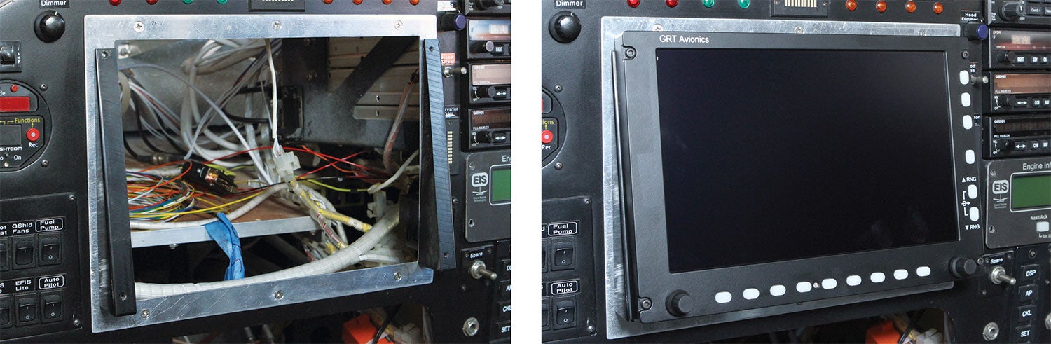

So far, so good. Note the outside edges of the wedges were rounded over to remove the sharp corners (left). The adapter framed the new GRT display very nicely (right). The final touch will be a coat of semi-gloss black paint to match the original panel.
