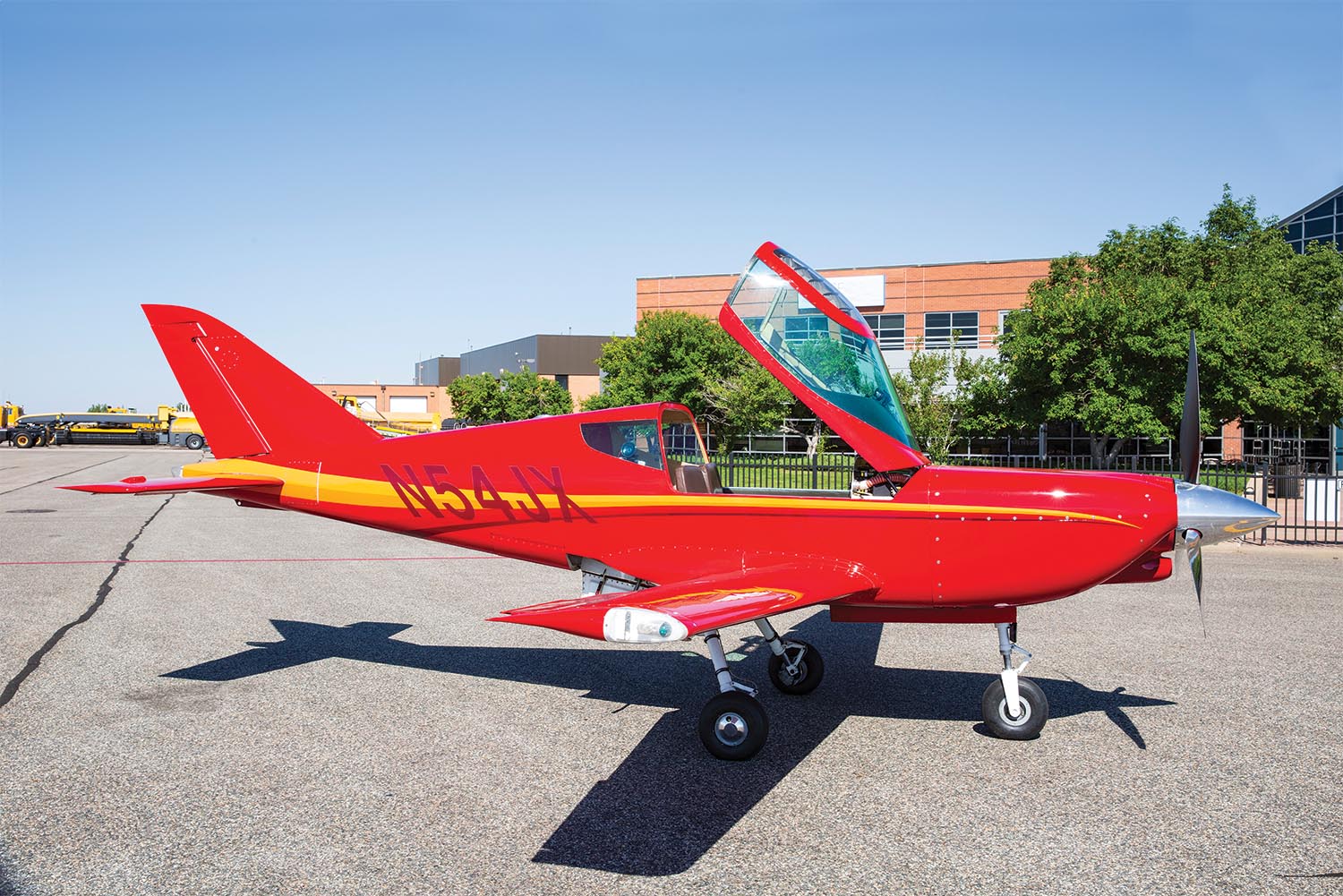

N54JX
N54JX is the sexy red SX300 featured in this article. It was the second SX300 built by Bill Johns and was registered in 1999 as a Johns SA29, as a nod to the Swearingen company’s original designation. He sold it in 2009 to Florida-based Swiss airline pilot Heinz Peier, who upgraded the avionics and panel and then proceeded to have a number of adventures flying it around the world between 2012 and 2015.
Heinz added a 26-gallon auxiliary tank in the baggage compartment, as well as a 45-gallon tank in the passenger seat. With just himself and his folding bicycle, he visited something like 40 countries in North and South America, Europe, Africa, the Middle East, Asia and Australia. He also holds a unique distinction of being forced to land by the Malaysian air force a month after Malaysia Airlines Flight 370 went missing in 2014. They felt he didn’t have the proper paperwork to overfly their territory on his way between Sri Lanka and Singapore.
Needless to say, at that time the Malays were very sensitive about their airspace. Heinz had to withdraw the maximum daily amount from ATMs for over a week to accumulate the necessary cash to pay a fine before he could continue on his journey. For those who are interested, the Kathryn’s Report of this incident makes for entertaining reading. In 2016, Heinz was unfortunately struck by a drunk driver, curtailing his traveling. Although he recovered, he realized his globe-trotting days were over.
In 2021, Heinz put his SX300 up for sale. After serious consideration, Doug Eastman of Colorado wound up purchasing it in February 2022. A fellow airline pilot, Doug had been racing his Hiperbipe in the annual AirVenture Cup Race but was looking for something faster. He was considering a Glasair III or a Lancair Legacy to scratch the itch.
After talking with fellow AirVenture Cup pilots, Doug started eyeing the SX300. Doug isn’t exactly short at 6 feet 3 inches tall, and the interior dimensions of the fast-glass planes were downright snug for him. Conversely, the interior of the Swearingen allowed for more open space forward of the spar, making it comfortable for someone his size. After striking a deal and signing the papers for N54JX, the flight home to Denver from Florida took only 6.9 hours, cruising at around 260 knots. It took much longer than the flight home to get the smile off Doug’s face. Since its arrival to his hangar in Denver, he’s been exploring the envelope and getting used to it.
N54JX originally had traditional square air inlets but was eventually modified to round “LoPresti style” inlets and RAM air intake. It has a direct air inlet, where the ram air bypasses the inline K&N filter and adds another 1.5 inches of manifold pressure. This provides filtered air on the ground or when desired (such as flying in smoke), but with unfiltered air the plane gets 75% power up to around 9500 feet.
With a Vne of 280 knots, it is a fast cruiser. Flying from Denver to Oshkosh for AirVenture, Doug made the 774 nautical-mile trip in just 3 hours and 15 minutes, including a fuel stop! “Door-to-door, it’s faster than the airlines for trips under 1000 miles,” says Doug. Conversely, it slows down nicely when you use the big three-blade Hartzell prop up front as a speed brake. “I can come into the airspace at 240 knots, slow to gear extension speed by downwind and be turning final with 90 knots over the fence with no issues.”
With 66 gallons of usable fuel on board and a fuel burn of 20 gallons per hour, it has a very comfortable 700- to 800-mile range. Slowing to economy cruise, it burns 14–15 gallons per hour while still maintaining around 250 mph. We can only image how many pilots would love to have those “economy” cruise numbers. While these are turboprop performance numbers, remember it still is a piston airplane and doesn’t need to fly in the flight levels. On the way home from Oshkosh, Doug had the advantage of being able to stay low and avoid the headwinds while traveling west. So much so that he beat a friend’s Cessna Citation traveling the same route by an hour.
