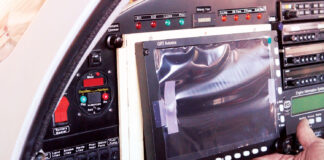

The Avilution EFIS is developmental and while not fully functional at the time we flew it, will eventually control radios and transponder using edge buttons and knobs.

The next thing you are likely to notice is the unusual instrument panel configuration. As we’ve already mentioned, it doesn’t have one. Instead of the usual panel, there is empty space all the way to the firewall. This empty space is home only to an articulated arm assembly supporting a single, large-screen EFIS panel. The factory prototype is fitted with the Avilution EFIS, but it probably won’t be very difficult to build the same concept with your choice of EFIS. Basically, you will be building a simple box in which the screen(s) mount, with a few wires running down the articulating arm, and all the avionics mounted remotely.

The articulation of the screen allows you to place it wherever you want—in front of either front-seat occupant, with the height adjustable to where you like it. Remember the throw-over control yokes in older Bonanzas? Just think of this as a throw-over panel. If the panel is in the way, you can also push it forward and down, so that the view is uncluttered. And speaking of the view—with the solid instrument panel gone, the windshield continues down the sides of the aircraft where there would normally be skin. The effect is almost like flying an old bubble-cockpit Bell 47 helicopter. Zenith visibility out the bubble-windowed doors has always been good, and now it is even better.
