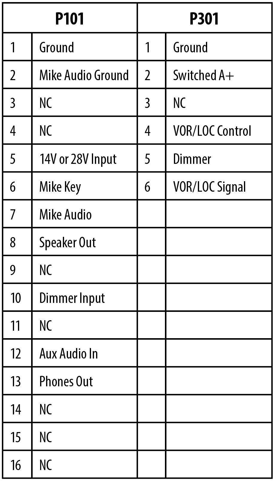

Let’s take the simplest case of a monophonic (single) audio output that we want to listen to on the “aux audio input” of our com radio or simple audio panel. Refer to Figure 1.
Internal to the com radio, the “aux audio input” is shown with a 600-ohm internal matching resistor. There are a dozen ways to do this, but for our purposes it can be represented by a “real” resistor of 600 ohms. Almost all aux audio inputs I’ve ever come across are rated for 1-volt input for full headphone output. And, almost universally, the internal power supply of the radio means that the output will go from zero (ground) to +10 volts peak. That means that we would like to drop the input down to no more than ground to 1-volt peak, or a 10:1 volt reduction.
