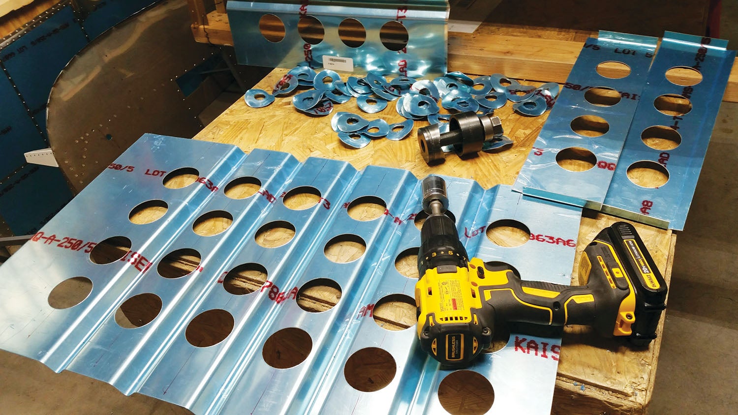

Lightening the seat backs was a modification not worth the time and effort it took to create the holes.

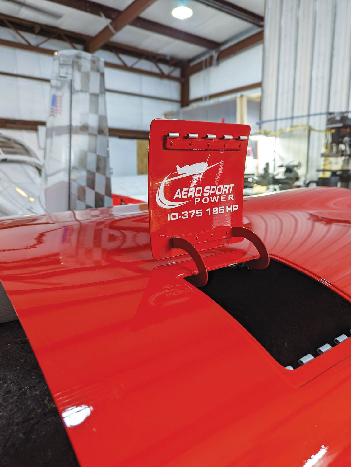

Using an RV-10 mount, Kirk placed his oil cooler on the firewall and added a cockpit-controlled butterfly that adjusts the amount of cooling air and regulates the oil temperature. Kirk also made a spring-loaded dipstick door on the cowling. Painted on its underside is the powerplant, “Aero Sport Power IO-375 195 HP.”
This engine was another episode of serendipity. “I got it secondhand from Arizona Aircraft Salvage. It came off of a ground-looped Murphy Rebel; according to the logbook, it had 25 hours on it. I would have liked to have a constant-speed, but the engine has a solid crankshaft,” so it turns a fixed-pitch Sensenich metal prop. “On the other hand, I saved 40 more pounds and $10,000 by not buying a constant-speed prop and governor.”
Hanging this engine is the subject of another YouTube video. “I hear so many people talking about how many people and how long it takes to hang the engine,” Kirk said. “We hung it in about 12 minutes and had all four bolts tightened up. If you don’t have a 13-year-old granddaughter helping you, it might take a little longer.”

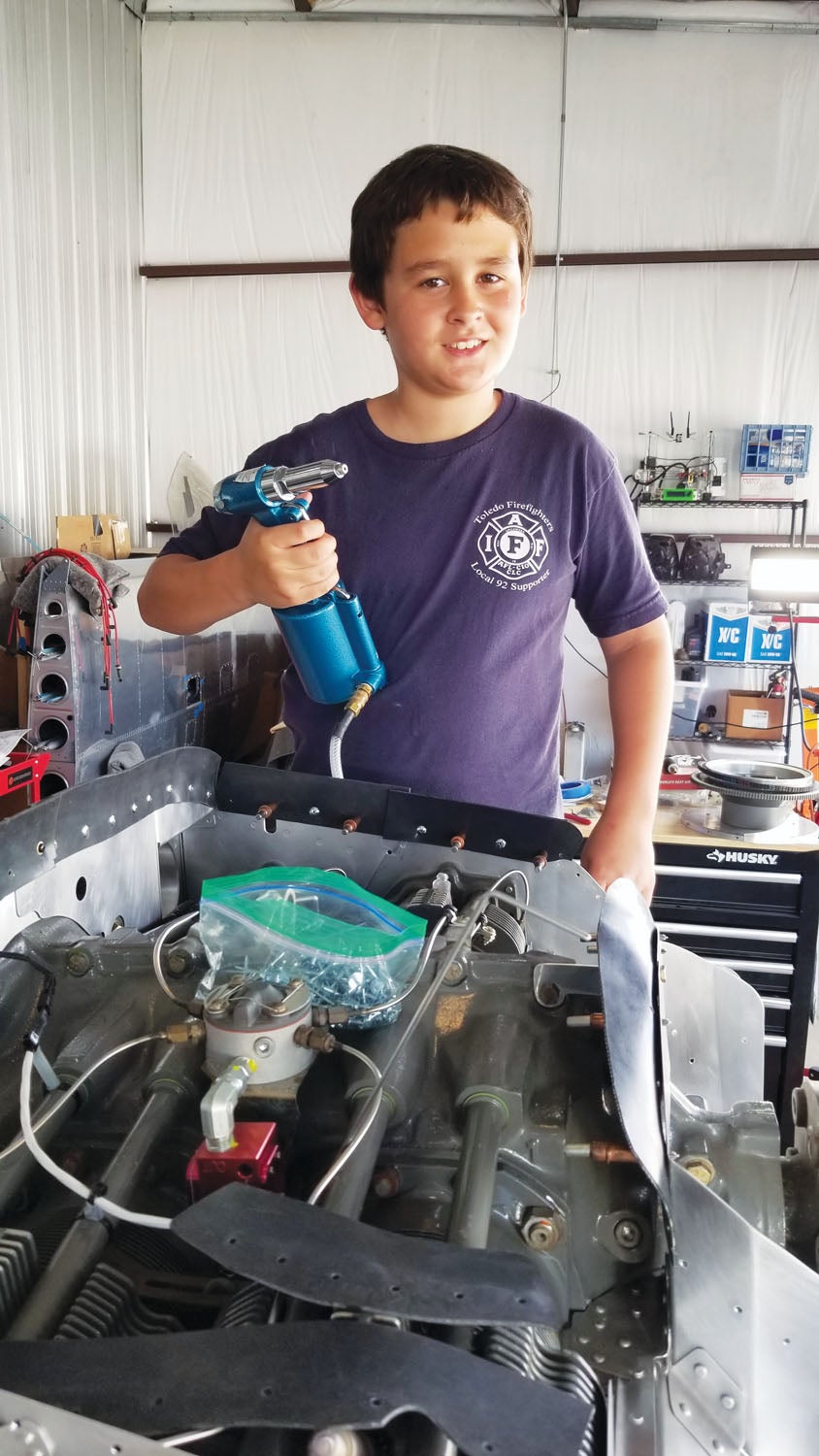

Kirk’s 11-year-old grandson, Oliver, rivets the cowl baffle seals.

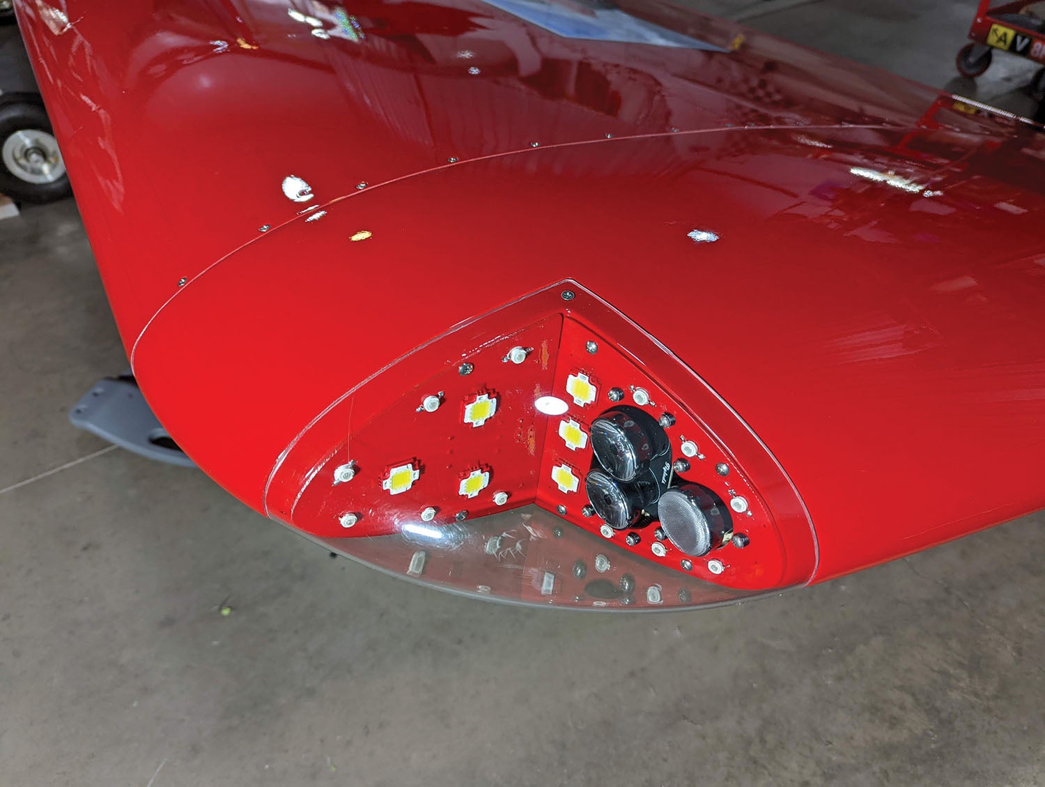

The Flyled light kits announce the RV’s position after dark.
In those boxes were a Garmin G3X Touch, a G5, GTR 200 com, GMC 307 autopilot, GDL 52 portable SiriusXM/ADS-B receiver and an EI Commander, which interfaces with the engine’s dual P-MAG system. “I sold a couple of the items in the suite and bought a Garmin GTN 625 GPS-only navigator. With one com radio and no ILS, the -7 is basic IFR; I’m not instrument rated, but I’d like to be, and I love the autopilot.”

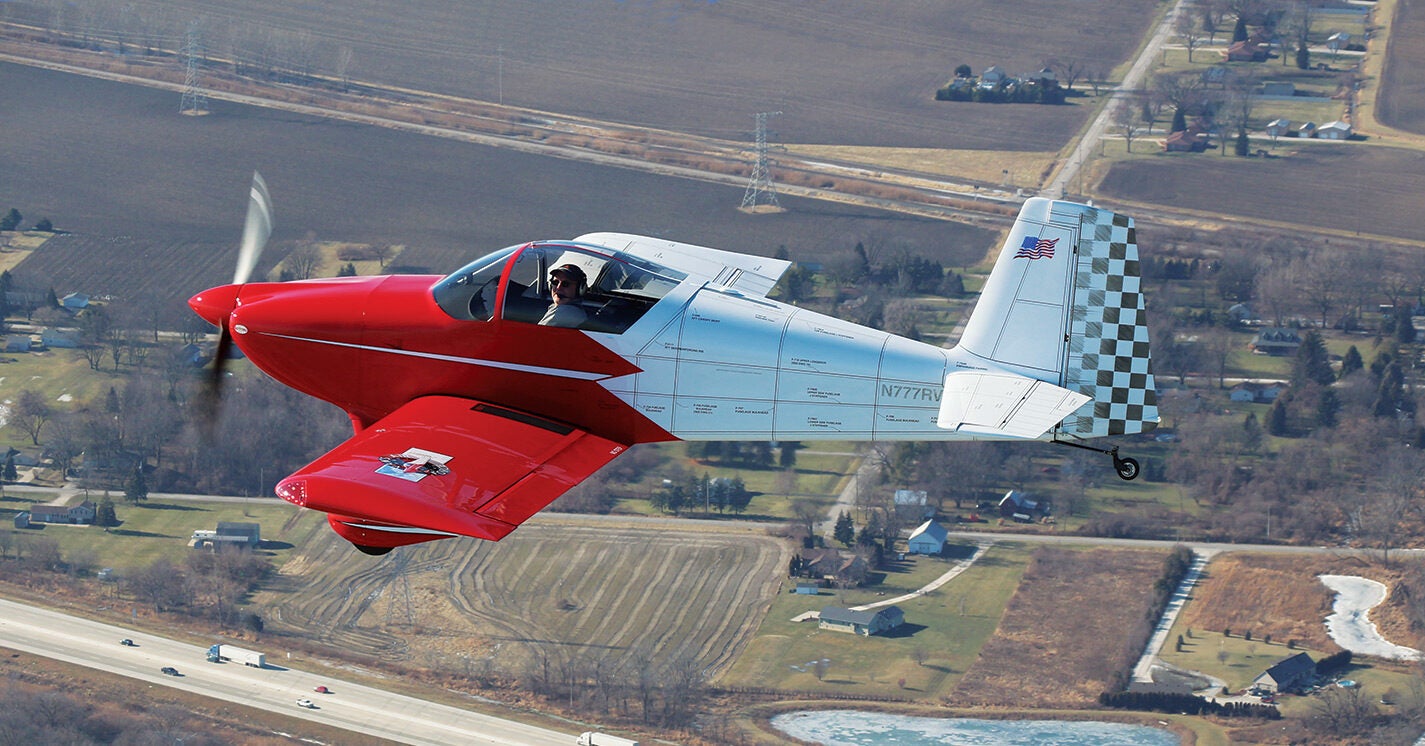

From any angle, Tony Kirk’s RV-7 conveys every homebuilder’s journey from construction to relishing the airborne rewards.
