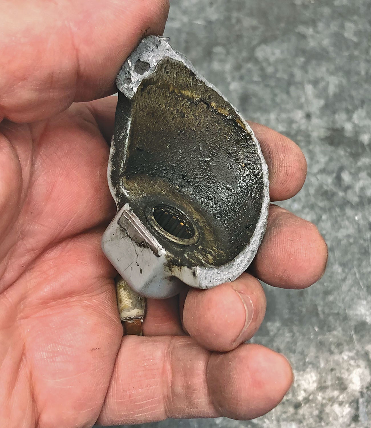

This piece of aluminum used to be connected to the front of Richard’s starter. Needless to say, without it the starter would not work.
I have no idea if he had a kickback at any recent point or if this is just metal fatigue from 13 years of starting

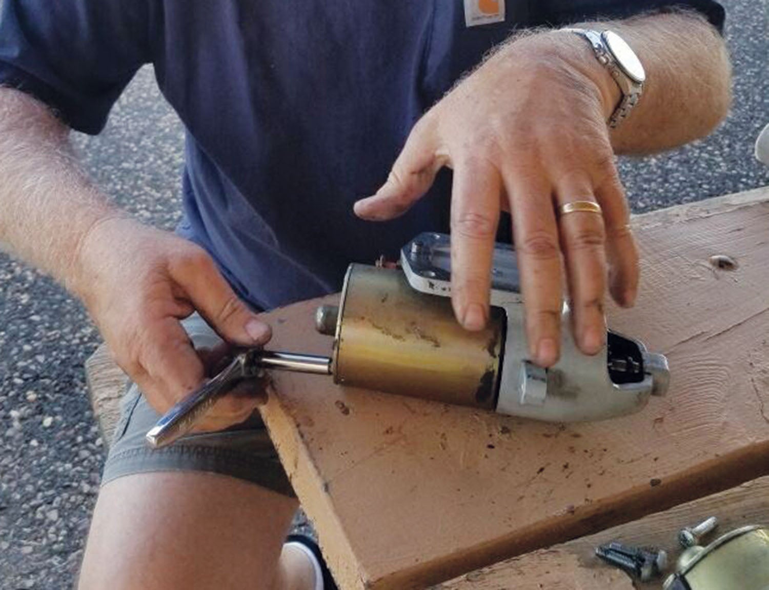

There wasn’t much diagnosing to do in this case. The starter was clearly broken. The question now was, where are we going to get another starter in Winslow? As it turned out I had a second starter with me, but it was a different configuration that would require major surgery to Richard’s baffles to make it fit. I just didn’t have the tools for the work that it would entail. Since it was now 100 degrees and we were both pretty frazzled, we decided to get a hotel room and see if Aircraft Spruce could overnight us a new starter.
When we got up the next morning and checked the tracking on the starter, we found out that there is no morning delivery in Winslow with FedEx or anyone else. It wasn’t coming until 4:30 p.m. and there was weather heading our way. With the clarity of the new morning we started thinking. What if I took the case from my bad starter and inserted the guts of Richard’s starter into it? His starter was turning over even if broken, and mine had a good case.  It could work, so off to the airport we went to make one good starter out of the parts of two broken starters. By 10:30 that morning we had two planes that would start.
starter trouble img 0084
The guts of two starters made one good starter, at least for the time being. The real frustration was that I didn’t think of this solution until the next morning. My excuse is that my brain had been fried by the Arizona sun.

Your author assembling a parts starter for Richard so we could get home before the weather moved in.

After 13 years, Richard and I were not so much disappointed in the lifespans of our starters as we were unhappy about the exact timing and location of the failures. These were both Sky-Tec 149-12LS starters, which is what I used to replace the starter in my Sportsman, mainly because I wanted something that I knew would drop right into the spot formerly occupied by the old starter. Richard can now decide how long he wants to fly with his parts starter and what to use as a replacement. In my GlaStar project now under construction, I am switching to a Sky-Tec 149-NL starter that is 1.6 pounds heavier but considerably more rugged. I can save that much weight somewhere else. What you do depends on how important weight, especially forward weight, is to you.

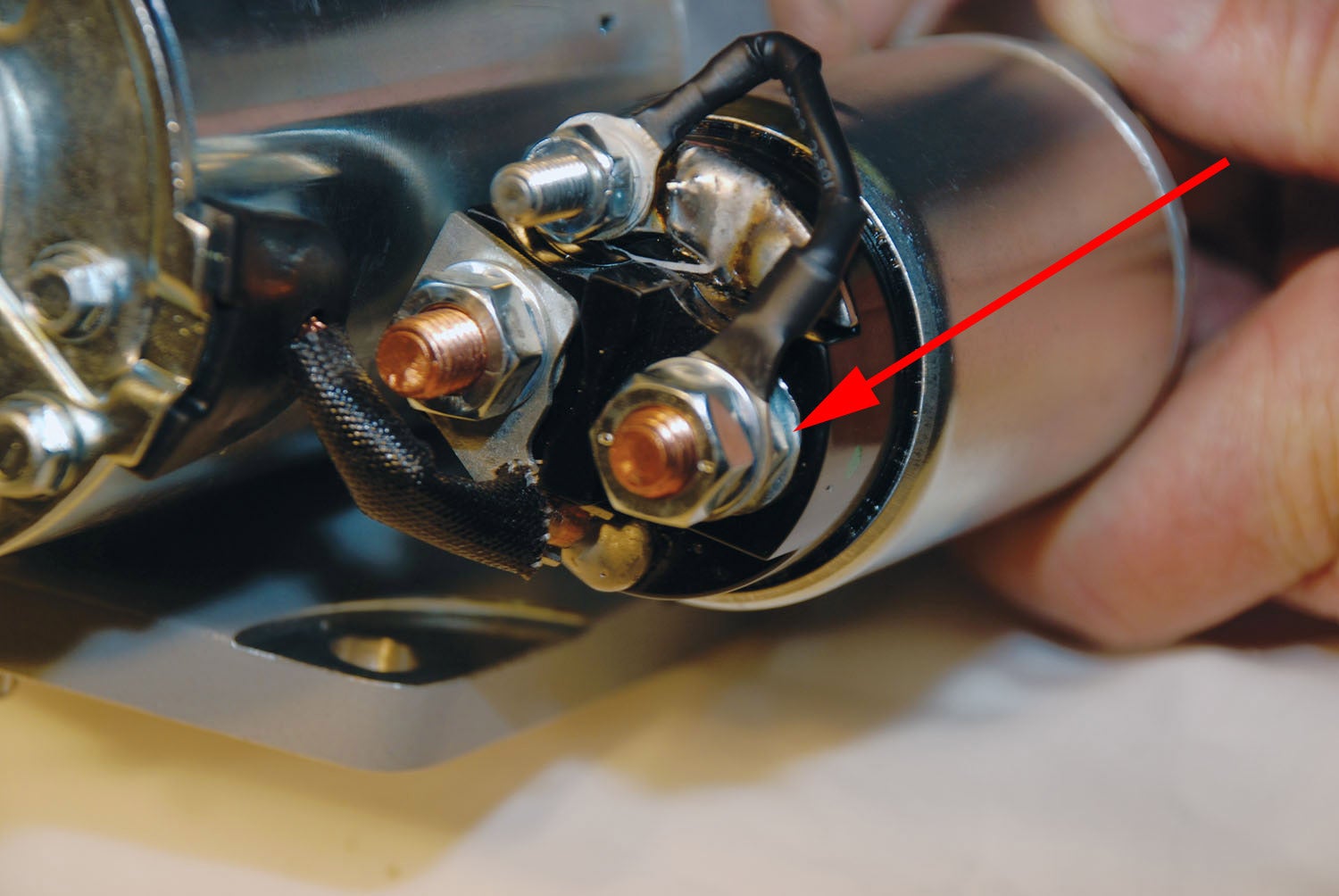

When you connect the power to a starter, be sure to use the correct terminal as shown by the arrow. If you use the other terminal, the motor will spin but the starter will not engage the ring gear. By the way, those nuts have metric 8-mm threads, not SAE 5/16-18 threads. Be sure not to lose them.
When Sky-Tec made our starters, they decided that the best way to get weight down and to protect the engine from harm from kickbacks was to sacrifice the starter. As long as the engine didn’t kick back during the starting process that was a good strategy. The problems came when engines did kick back and the casting part of the starters broke. No one thanked Sky-Tec for protecting their engines, they were just mad about having to buy new starters. Eventually Sky-Tec got tired of getting those phone calls, so they beefed up their lightweight starters and came out with some new starters with a different type of kickback protection. This added weight but increased durability. Today you have a choice.

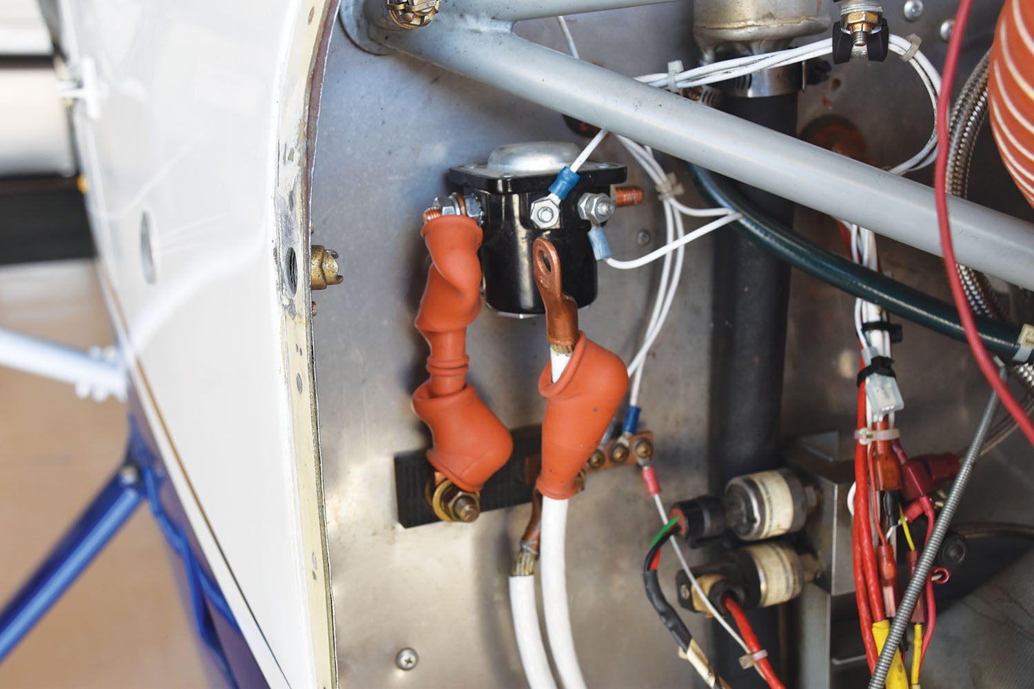

If the battery checks out, then the next place to look for trouble is in the relays and wire connections of your starting system. Start with the battery and check voltage at each connection. Check both sides of the master relay and starter relay. Disconnect the cable from the relay to the starter before you try to check the starter relay. You don’t want to accidentally spin the prop while you are checking the relay. Ideally you should not have more than a 0.1-volt drop across either relay and not more than a 0.2-volt drop across the entire starting system. If you have more than that, you may have a loose or corroded connection somewhere, or a bad relay. The first time I began trying to solve my starting problem I found a loose connection where the cable attached to the starter. After tightening that I thought I had my problem solved. It did help for a while but ultimately the problem proved to be something else.
Another indicator of a problem is a big voltage drop when you crank the engine. My voltage was dropping down to around 8 volts. That will not do. You should expect to see a cranking voltage closer to 11 volts, or hopefully a little more.

    In the photo of the firewall, showing the starter contactor; it is mounted incorrectly. It should be mounted 180 deg from as shown, with the cap at the bottom. When energized the solenoid should pull the armature upward..
    As shown , a hard landing could cause the armature to move downward, closing the contacts and energizing the starter…a bad situation and a short life from the starter and ring gear..!
