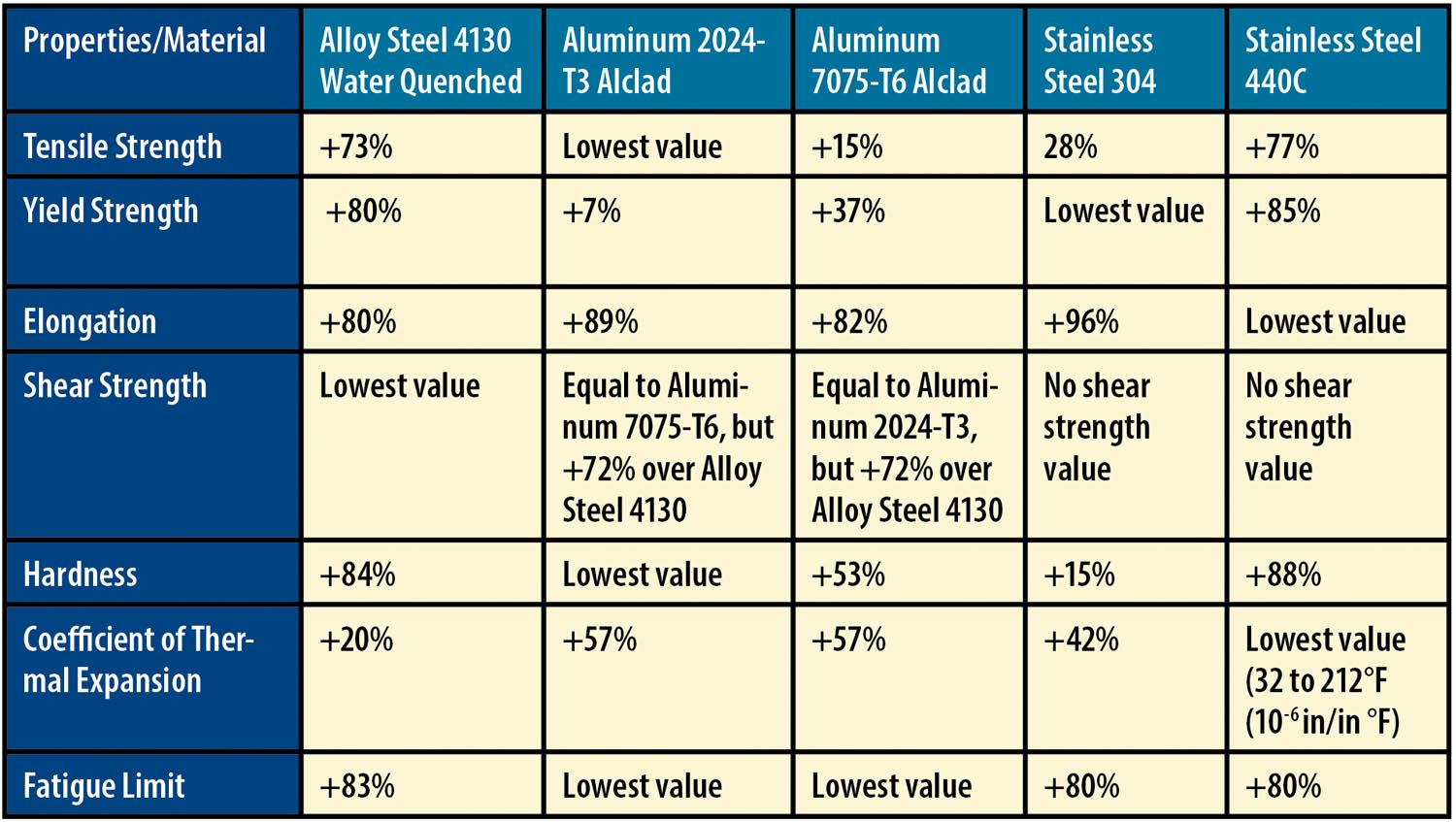

Analysis of Mechanical Properties
What follows is a comparative analysis of some common materials: alloy steel 4130 water-quenched, aluminum 2024-T3 Alclad and 7075-T6 Alclad, stainless steel 304 and 440C. All are typically used in aviation.
Alloy steel and stainless steel are 66% heavier than aluminum. However, in strength-to-weight ratio comparison, stainless steel 304 has the least strength-to-weight ratio, with a 54% increase for aluminum 2024-T3, a 60% increase for aluminum 7075-T6, a 63% increase for alloy steel 4130, and a 70% increase for stainless steel 440C over stainless steel 304. Table 2 shows the comparison of each material for each property. But first, some definitions.
Tensile strength: The maximum stress that a material can endure without tearing.
Yield Strength and Elasticity: When a material bearing a load is permanently deformed, this is known as yield strength and the yield up to this point is known as elasticity. Elasticity allows the material to return to the original shape after the load is removed. Alloy and stainless steel have 63% greater elasticity than aluminum.
Elongation: When the material lengthens to a particular point before fracture occurs.
Shear Strength: The maximum load a material can endure before it splits apart; each part will slide past the other.
Hardness: The capacity of a material to oppose scratching or indention.
Coefficient of Thermal Expansion: As material is heated, the material expands. (Some material also shrinks under higher temperatures.) Nonetheless, this linear expansion is known as the Coefficient of Thermal Expansion.
As the temperature increases, the strength of the material decreases. Data on stainless steel was unavailable, but the next comparable material in the martensitic category is 416. This material loses its tensile strength by 33% when the temperature is elevated to 1000 F. Alloy steel 4130 loses its tensile strength by 49% at 1000F, and stainless steel 304 loses 78% of its tensile strength. Aluminum 2024-T3 and 7075-T6 lose as much as 92% of tensile strength when the temperature is elevated to 700 F.
Fatigue Limit: When a load is applied to a material (maximum stress) whether in a steady or unsteady state, repeatedly, without breaking, this is known as fatigue or endurance limit.

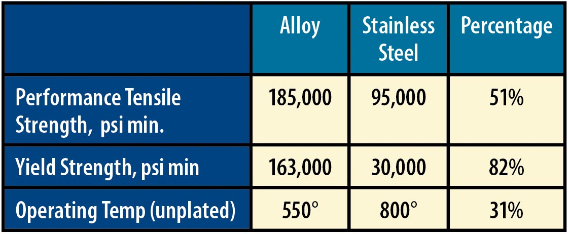

Analysis of Fasteners
Let us take this comparative analysis a step further by performing a comparison on fasteners, using a NAS 1352 socket head cap screw alloy steel ASTM A574 and a stainless steel ASTM F837.
stainless steel 05
Table 3.
Table 3 reveals that alloy steel is stronger in tensile and yield strength, whereas stainless steel is better at handling the temperature for this particular type of fastener. Shear strength is not listed because it varies with the diameter of the fastener. As an example, however, Number 10 fastener alloy steel is 3225 pounds minimum versus stainless steel at 1280 pounds minimum in single shear strength of the body, equaling less than 60% in single shear strength to alloy steel. Taking this example even further, a 10-32x.500 fastener costs 73% more in stainless steel with less strength, but with a 69% greater operating temperature. You can draw your own conclusions, but when was the last time you operated an aircraft at 550 to 800 F and walked away from it? Granted, the engine gets this hot or hotter.
