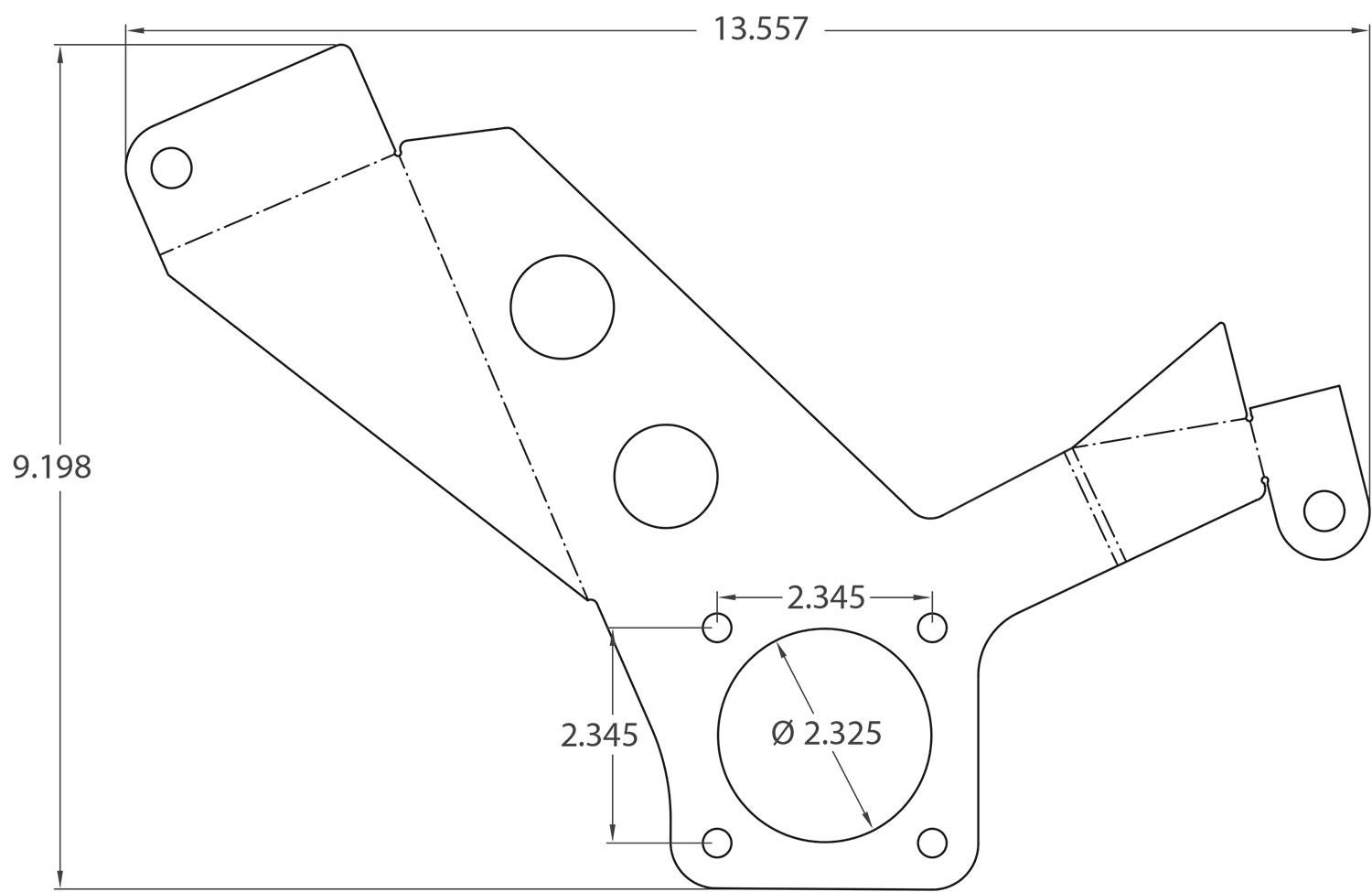

Photo 1 pdf of flat pattern
Sketch of the flat pattern for the Norquist cable bracket. This bracket required a blank 135/8 inches wide by 9¼ inches tall. The dotted lines indicate where to make the bends.
I recently helped Conrad Norquist of Riverside, California, with a custom throttle and mixture cable bracket for his RV project. The standard bracket was designed for a carburetor, but he needed a bracket that would put the cables in better alignment for a fuel injection throttle body. The factory bracket was made of 16-gauge steel sheet and powder-coated. Conrad had cut off the cable mounts and used some aluminum angle to reattach them in a more optimal location. This modified bracket was the template for making a new one.
Making the pattern from the modified bracket was a simple matter of folding paper over the original and tracing the outline. With a paper template, you can either trace that pattern (called a flat pattern) onto your sheet metal or Spray Mount it to the workpiece (I like to Spray Mount patterns whenever possible). From there it’s off to the band saw or nibbler or however you like to cut out sheet metal parts.

The RV cable bracket gets mounted between the intake and the carb—or in Conrad’s case, the throttle body. The intake port measures 2.325 inches in diameter and is surrounded by four holes for the mounting studs. These have to be precisely located. If the mounting holes are not positioned accurately relative to the intake, you could end up with a misalignment that might cause the engine to run poorly.

The size and odd shape of this bracket made it a perfect candidate for using a stage in the mill vise. I used a set of welder’s Kant-Twist clamps to firmly cinch the sheet to the stage. With the workpiece secured it was a simple matter of centering the cutter over the layout and, using a 2-1/8-inch bi-metal hole saw, making the opening for the intake. I then used the original bracket to line up and drill the holes for the mounting studs. With the holes drilled, I bolted the original to the new bracket and used a spindle sander to enlarge the intake hole to match the original.
