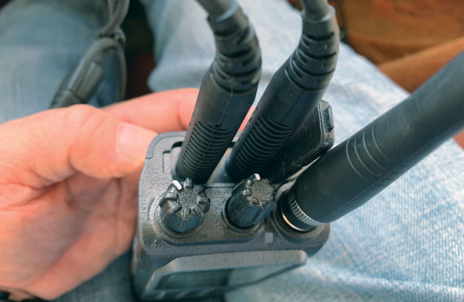

Big Jacks
direct plug in
No need for a headset adapter! The PJ2 accepts standard headset plugs directly. If you have a headset with a LEMO plug, you’ll need a LEMO-to-twin-plug adapter, which Sporty’s sells for $99.
The standard-size jacks are on top of‭ ‬the chassis behind the two knobs used for on/off/volume and squelch‭. ‬They’re equipped with rubber caps to keep the‭ ‬inevitable flight bag lint and cookie‭ ‬crumbs from tanking the radio’s guts‭. ‬
They’re accessible enough‭, ‬but it’s a tight fit because the top of the chassis is as small as it can possibly be to keep the form factor more or less standard‭. ‬I‭ ‬tried the PJ2‭ ‬in our Cub‭, ‬where a portable‮—‬an Icom IC-A6‭ ‬lately‮—‬serves‭ ‬as full-time com‭. ‬This lash-up requires‭ ‬a push-to-talk switch and the generic PTT we’ve had for five years worked both with the jacks plugged directly into the radio and through the airplane’s Avcomm AC-2EX portable intercom‭. ‬

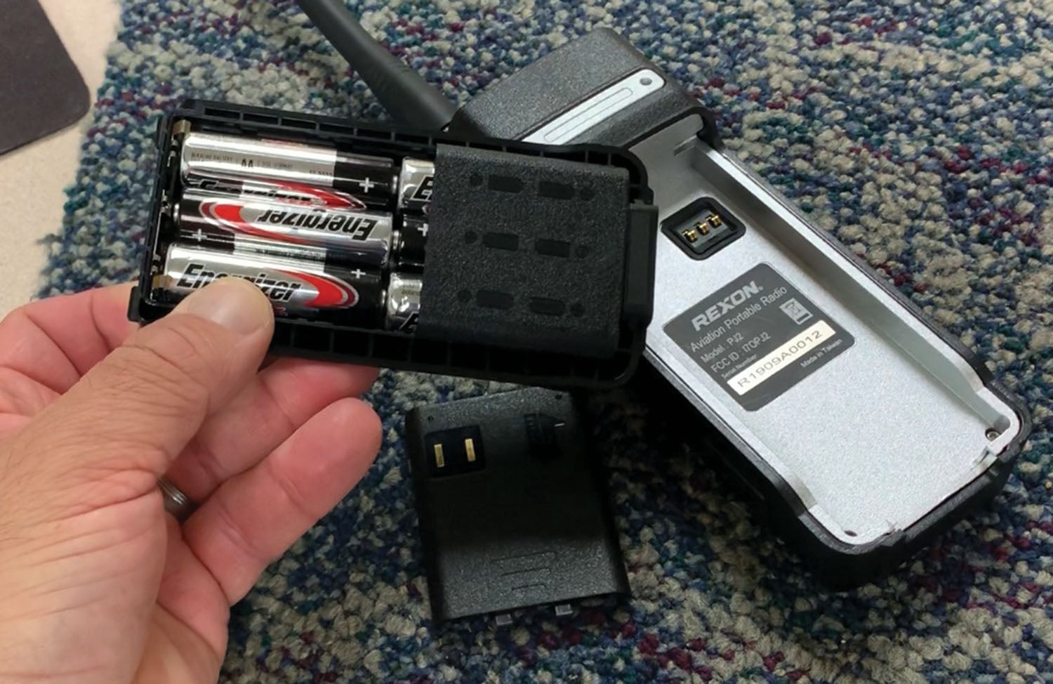

battery pack
Because the PJ2 is expected to be used as a backup device, it comes with a battery pack made up of AA cells. You can use six rechargeable AAs if you want, but alkalines will give you better shelf life. The radio can also run on USB power as long as the source is good for 2.4 watts or more.
Power is provided by six AA alkaline‭ ‬cells‭; ‬there’s no rechargeable option‭. ‬Well‭, ‬let me qualify that‭. ‬The radio ships with a USB-C cable that can be plugged into a standard 2.4-watt USB charger to run the radio‭. (‬A lower-wattage charger won’t provide enough power to transmit‭.) ‬You can also use one of the Flight Gear lithium-ion packs from Sporty’s‭.‬
