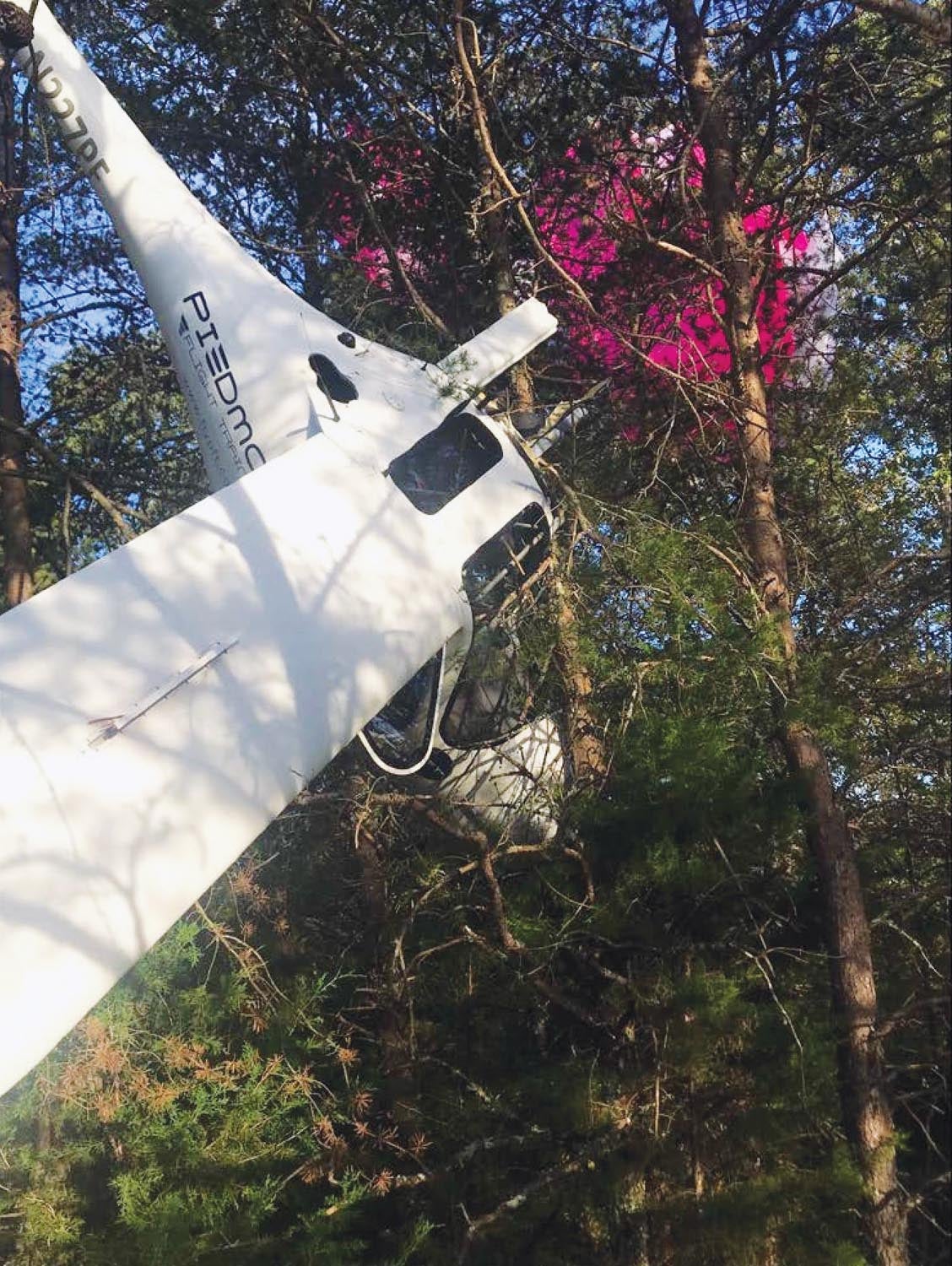

ERA21LA014 pipistrel
The pilot of this Pipistrel lost control while trying to perform maneuvers. He overstressed the wings trying to recover and was saved by timely activation of the BRS. (Photo: FAA)

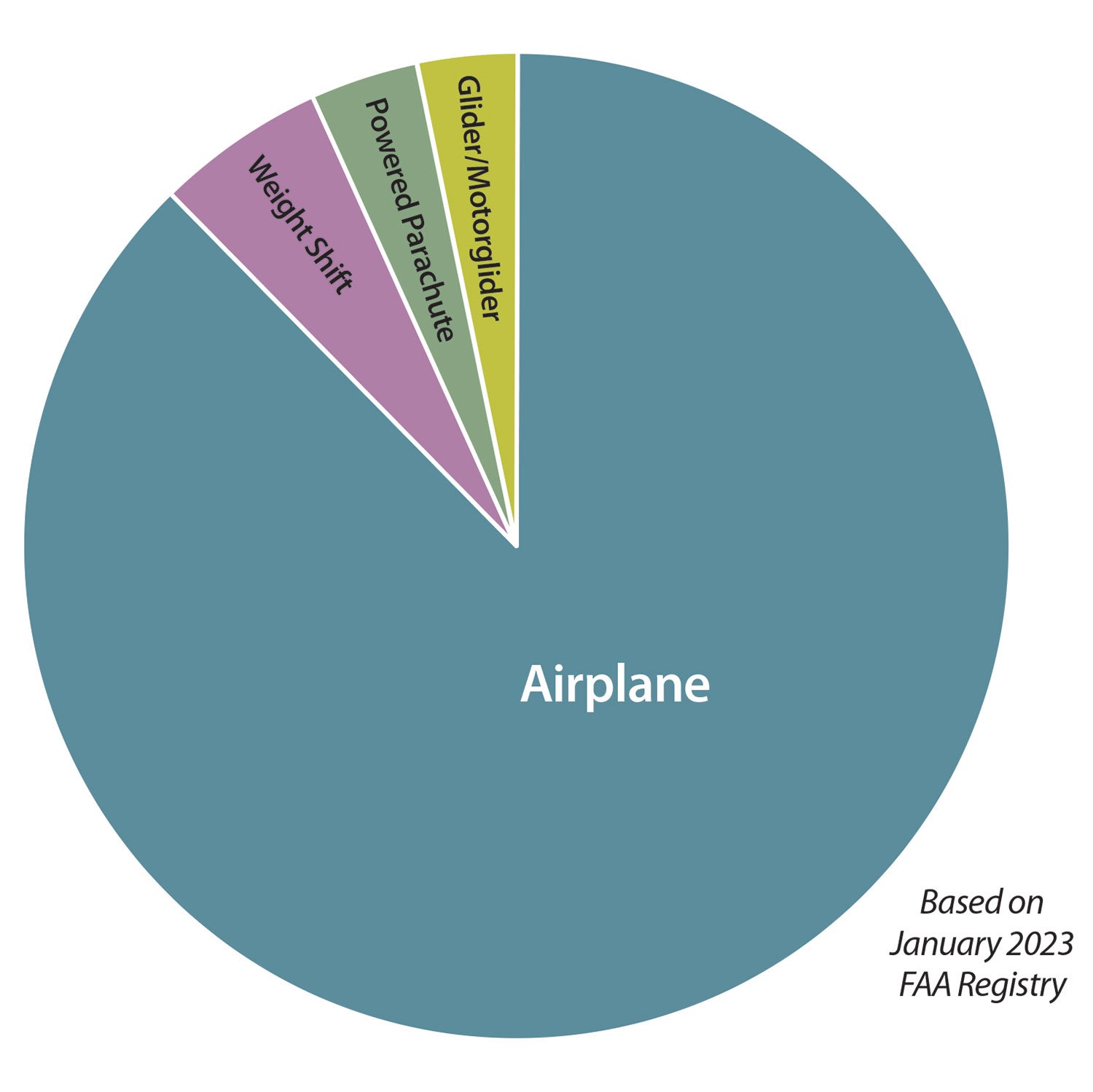

SLSA Chart6
Figure 6: While the Special Light Sport Aircraft category covers a variety of types of aircraft, almost 90% of them are conventional airplanes.
