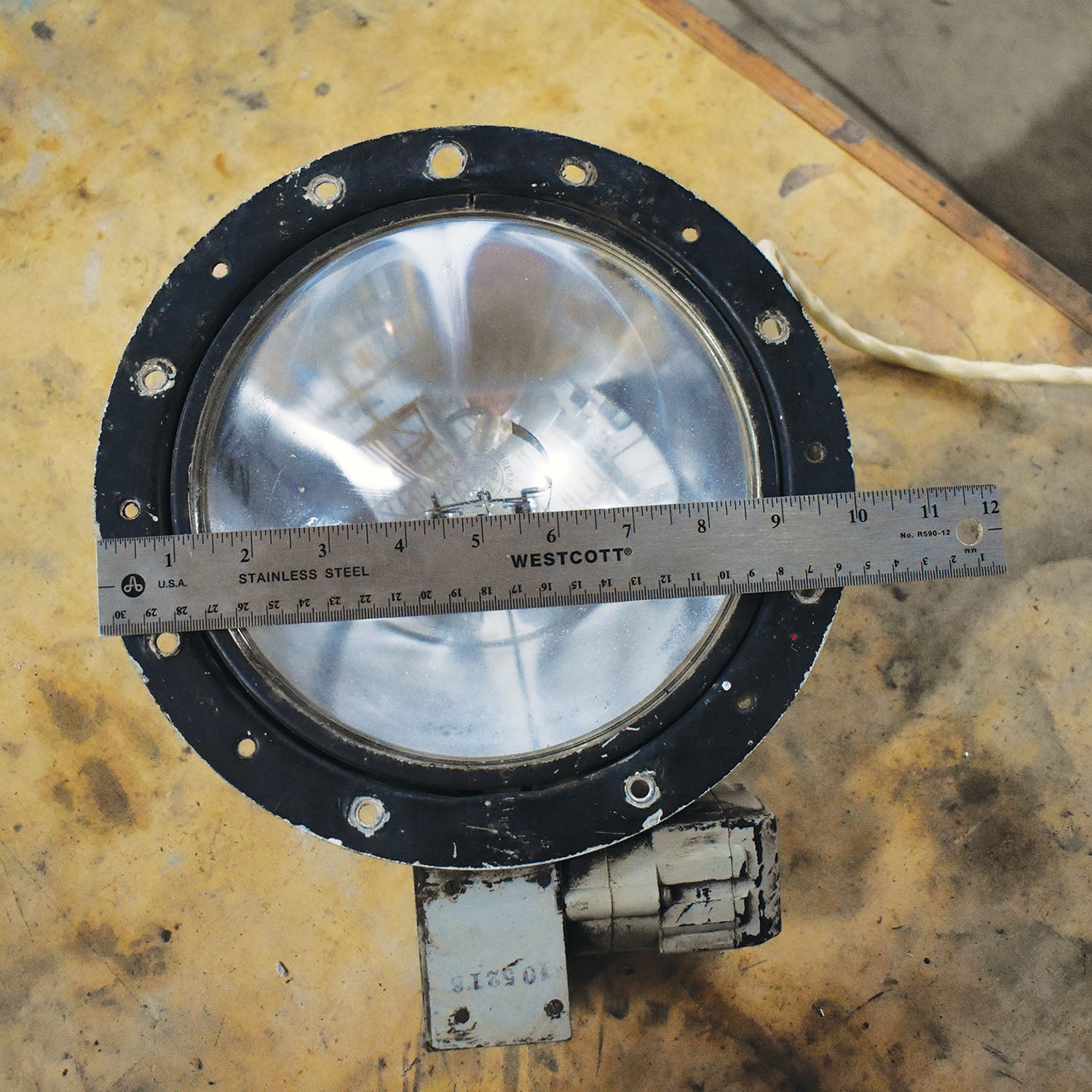

This oversized landing light is a bit large for the Spacewalker II’s wing bays.
While searching the web for instruments, I stumbled across a powered retractable landing light for a really reasonable price. A quick transaction, emphasis on “quick” (meaning I didn’t research or think), had a working retractable landing light on its way to me. However, when it arrived, I realized that the light I ordered must have come from a Super Stretched 797 nine-engine airliner with a 28-gazillion-volt AC/DC electrical system. With a retracted depth of just under five inches, the light won’t fit inside my wing, which is eight inches at the main spar and tapers down from there. Umm…not to mention, should I ever turn it on, the power draw will probably reduce the total thrust from the mighty Lycoming due to the added electrical load.
This light is going to end up as wall art in a neighbor’s hangar. Bummer. Now to look for some LED landing lights that I can hide on the plane someplace that will still look “sort of” period.

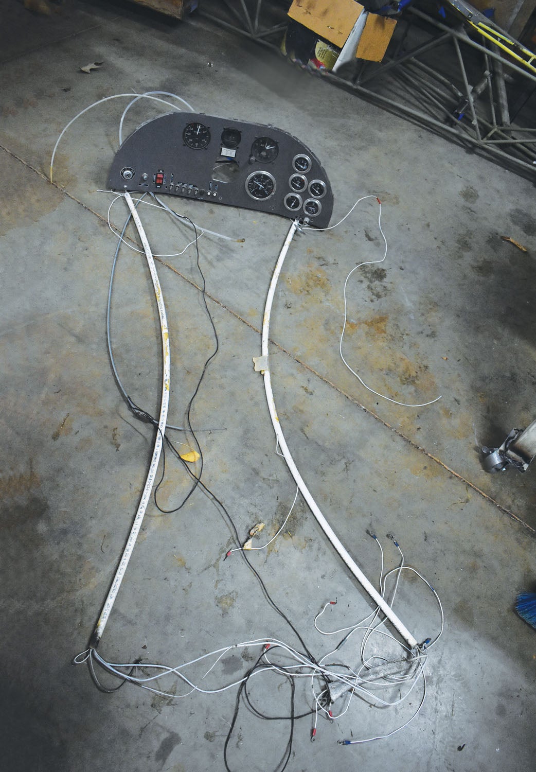

he original instrument panel, waiting to be addressed (right). Notice the PVC wiring chase in the lower right.

spacewalker rebuild 06
We can do better than PVC—much better.

One other change I will make is to remove all the PVC tubing used for wire runs.
