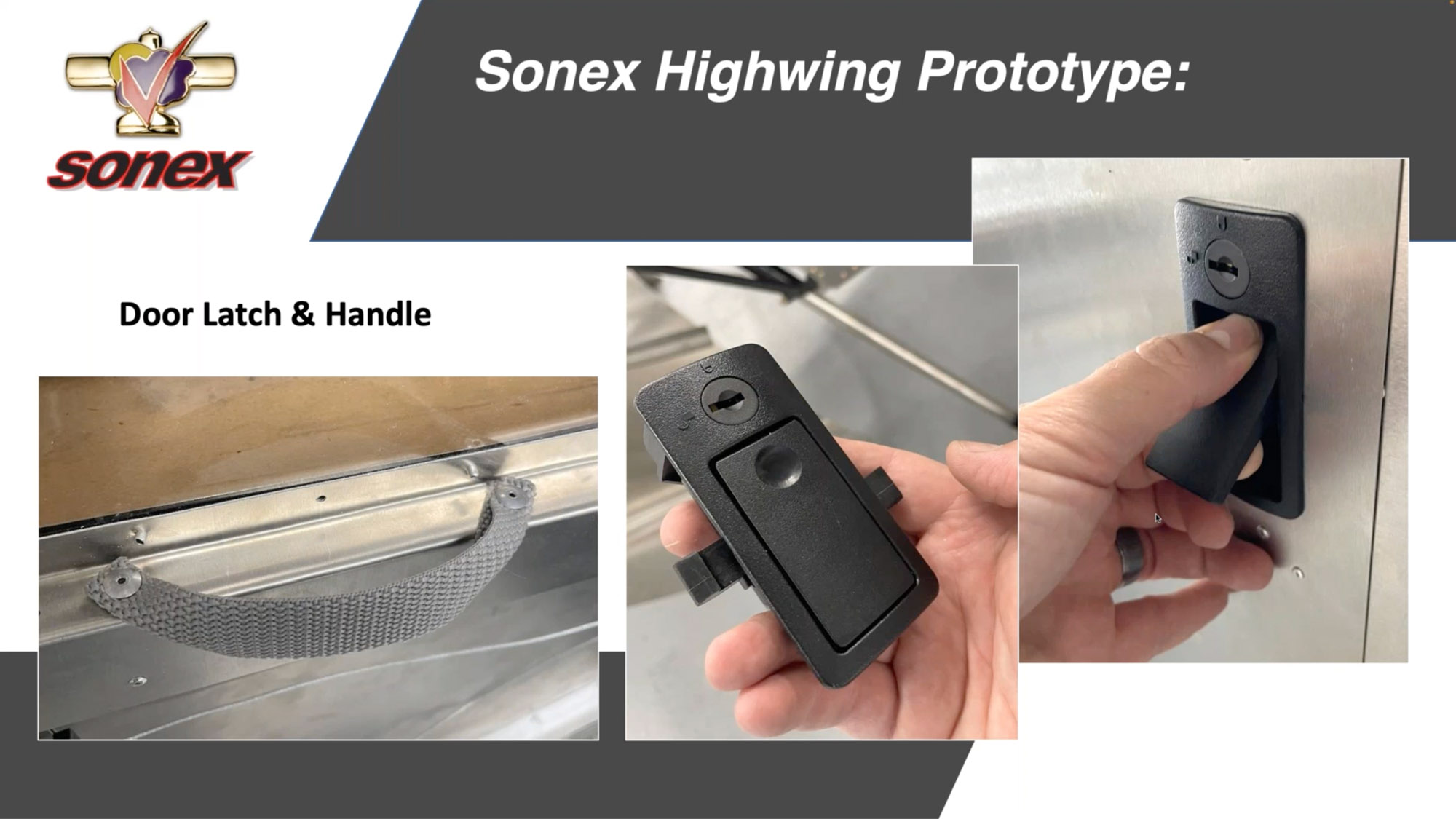

Schaible revealed some details of the doors, which will have simple strap-type hinges and open conventionally, with the trailing edge swinging out under the wing. One trick that speaks to Sonex’s desire to have the High Wing aerobatic capable is that the door hinges pivot inside the cabin, so a simple cable system will enable the pivot pins to be pulled and the doors jettisoned in flight if necessary. sonex high wing presentation January 2025 03

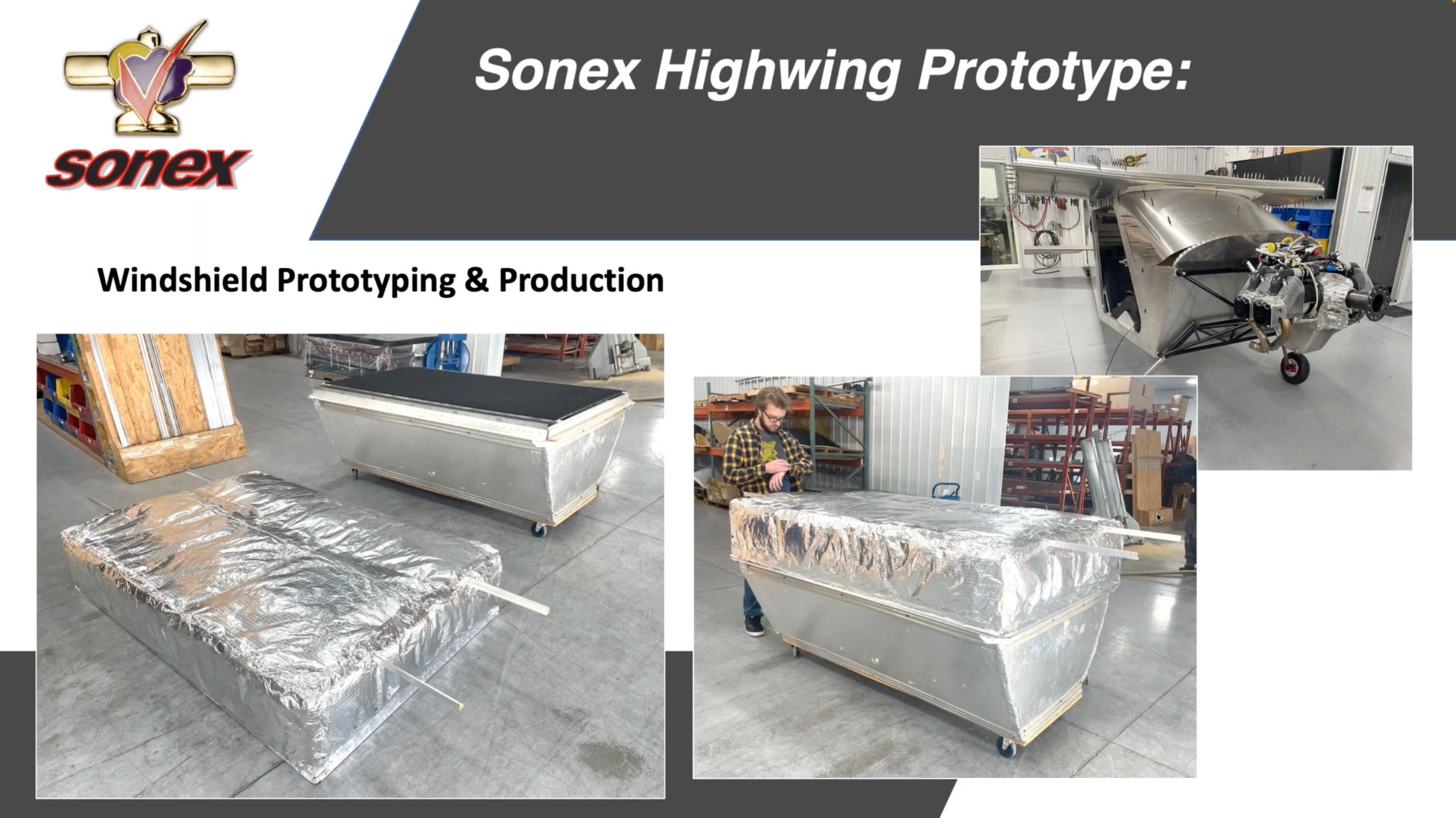

One of the slides showed the High Wing with a metal windshield mockup and Schaible confirmed that the company will be making its own curved windshield. sonex high wing presentation January 2025 06

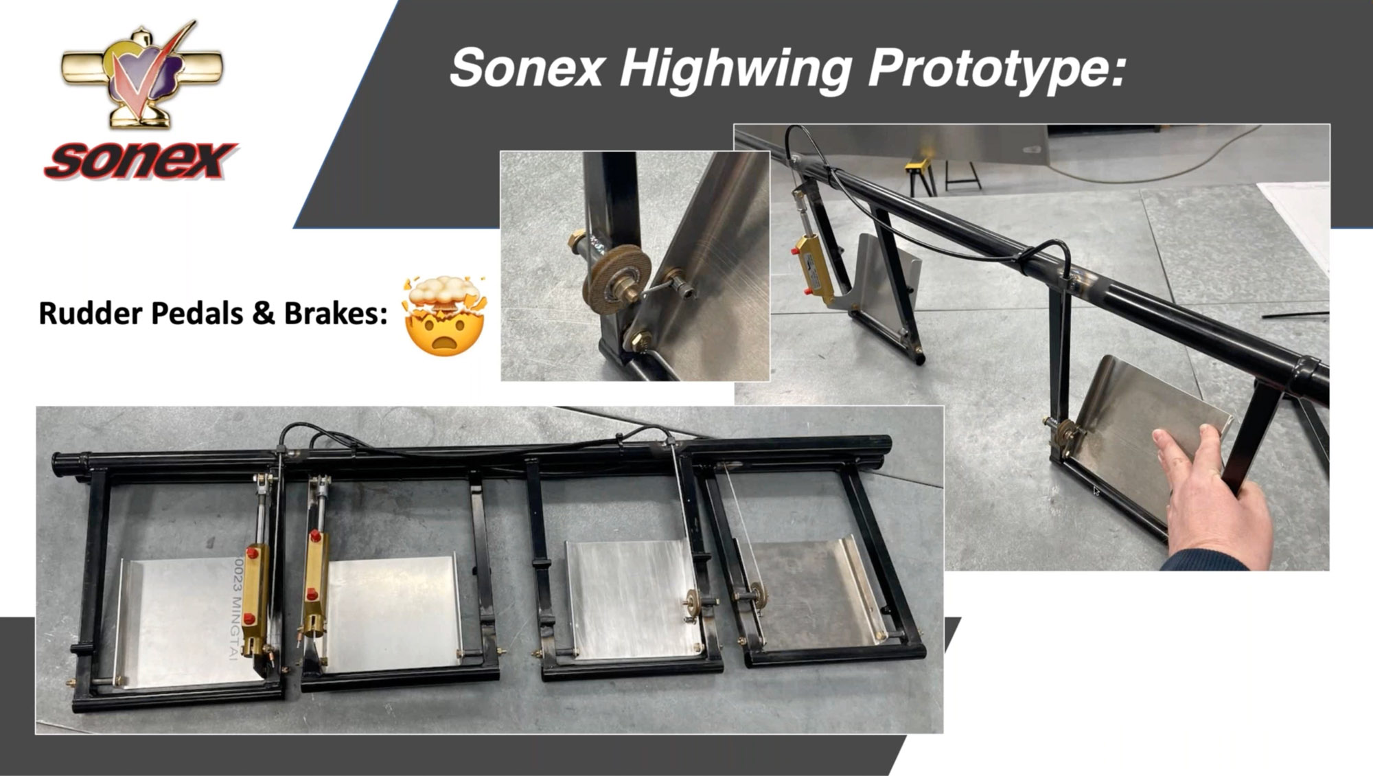

Screenshot 2025 01 30 at 1.14.25 PMStaying with the flight-control system for a bit longer, Sonex will change from its normal practice of placing the rudder cables at the outside of the cabin walls and, instead, running them down the center with a crossover. Low-friction guides will help maintain feel. But the biggest news was that Sonex is going to use toe brakes on the High Wing, a first for the company. Not only that, it’ll employ a simple cable connection from the copilot to pilot pedal set so that you can have dual brakes with only one set of master cylinders.
