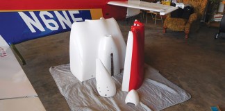

Once we dropped the airplane off, the normal paint-shop work began. The control surfaces and canopy were removed and fiberglass finishing commenced. Since most of the fiberglass parts on our -3 were built from scratch (with the exception of the wingtips and wheelpants), there was a lot to do. GLO does great fiberglass work, and they do it all the time, so they are much faster than the average builder. I let them fill pinholes and the like using the chemistry they prefer. This took them a couple of weeks, and by week three, the airplane was all-over white with a slightly blue tint to work better with the final coloration. At this point, Draper set up camp at GLO Custom and got to work.
