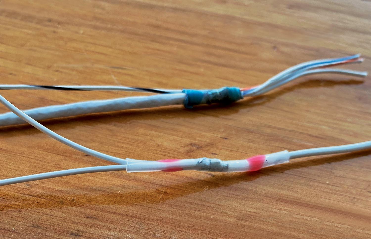

Solder sleeves are special tubes of clear heat shrink, with a band of solder in the middle and hot glue at each end. They can be used to join wires together (splicing), including attaching pigtails for ground wires to the outer braid of shielded wire without damaging the underlying insulation, using only a heat gun—no soldering required.
Traditionally, wires have been connected using solder, which is then protected with an insulating barrier of electrical tape (old school) or heat shrink (middle school). If you have done much wiring, you are probably already familiar with heat shrink; it comes in lengths of up to several feet and is cut to cover the exposed solder joint. When heat is applied, it shrinks around the joint, providing a slip-proof covering that provides abrasion resistance and electrical insulation. The hardest part about using them is remembering to slip the sleeve over one of the exposed wire ends before soldering them together (I started counting, but ran out of fingers and toes).
solder sleeves 11
Haisstronica sleeve kit as ordered online (left). A comparison of three brands of solder sleeve before shrinking. Note the difference in length, bands and material colors (right).
Heat shrink also provides benefit in the form of some strain relief of the soldered connection. The soldered portion of the wire is very inflexible, compared to the wire where it enters the solder. This provides a potential stress concentration and can lead to breakage of a wire at this point, especially if the wire is subject to vibration and/or flexing. The heat shrink helps to support the wires on each side of the joint, distributing the stress over a longer distance. Keeping the wires in properly supported bundles also helps to prevent this from becoming an issue.
solder sleeves 08
Kuject sleeve kit as ordered online.
Solder sleeves perform much like heat shrink and provide many of the same benefits. When shrunk, they provide an insulating barrier that provides some stress relief. This happens automatically as the sleeve is being shrunk; the same heat that melts the solder and glue also shrinks the sleeve, so they are a kind of one-stop service.
The glue bands in the solder sleeve act like hot glue, gripping the insulated part of the wire and providing some extra strength in holding two wires together. They also help seal the soldered area so that air, water and other contaminants cannot enter. In practice, the heat shrink part of the sleeve requires a relatively smaller amount of heat. The glue bands require a bit more and the solder requires still more before it flows out around the wires. Insufficient heat might cause the sleeve to shrink and maybe the glue bands to melt, but the solder will be left as a clearly delineated band, with little or no flow-out around the wires. On the other hand, too much heat will melt the heat shrink, eliminating its insulating properties. It can also cause charring of the sleeve, which is unsightly if not mechanically damaging—and everyone knows how important a pretty wire connection is!
Solder sleeves come in two flavors: the regular sleeve and the kind with a short pigtail inserted between the solder band and the tubing. The pigtail versions are typically used for shield grounds, with the other end of the pigtail connected to a ring terminal, which is screwed onto a backshell or other convenient grounding point. It is easy to start with a regular solder sleeve and make your own pigtails; just make sure the stripped wire end of the pigtail stays under the solder band as it is being melted.
One of the big advantages of solder sleeves is that they can be used inside the airplane with little risk of damaging adjacent components. With regular solder, there is a risk of dripping hot liquid metal onto carpets, upholstery or adjacent wires and avionics. If you have ever tried to solder something while upside down under the panel, you know that one of those adjacent components is your chest. Solder sleeves eliminate the risk of solder splattering where it could hurt. Applying solder also involves waving a soldering gun around. Wiggling out from under the panel with a hot soldering iron in hand is a pretty good way to burn holes where they aren’t wanted.
