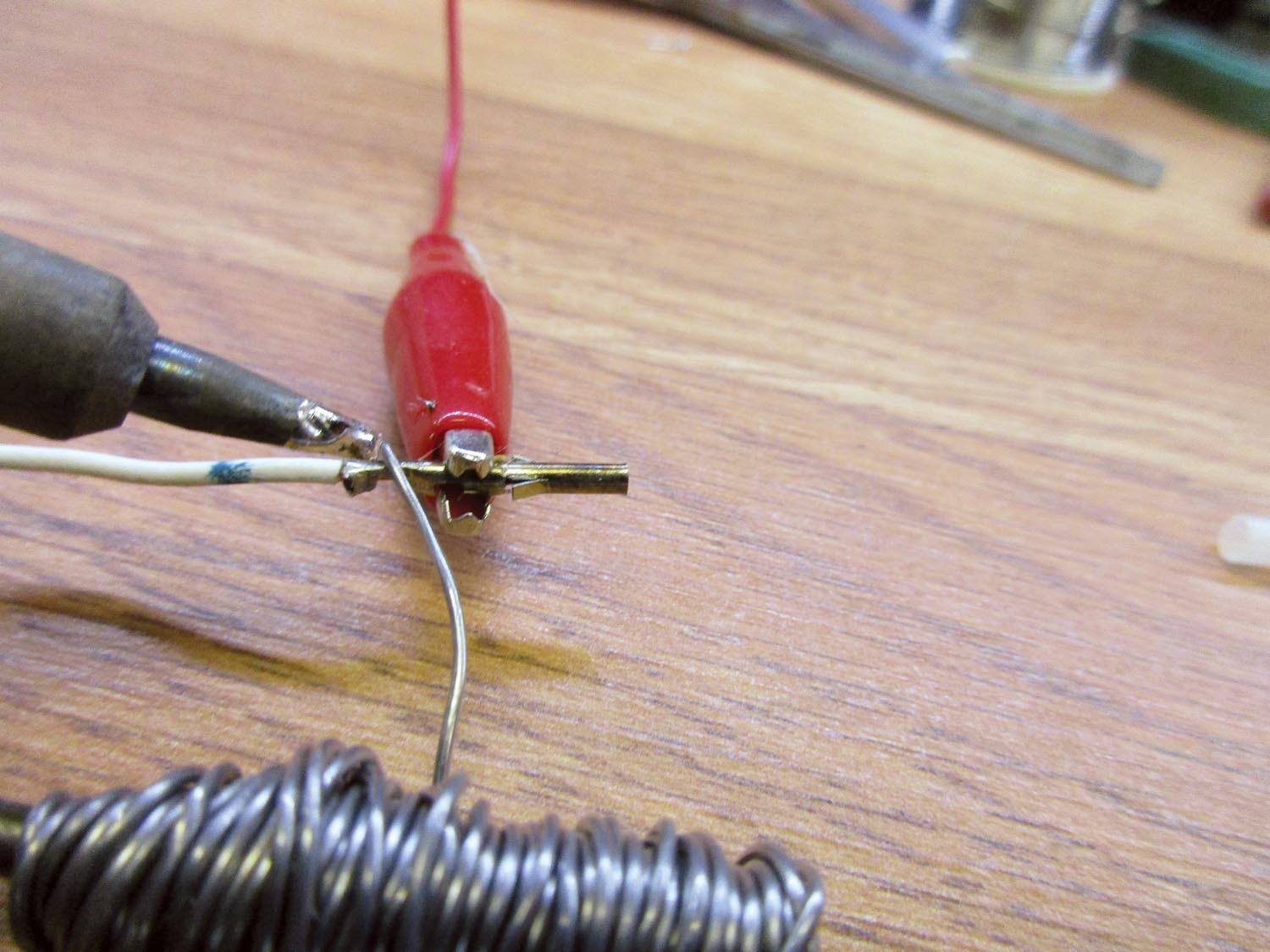

Two, when connecting a wire to a pin of a connector, some pins are meant for solder and some for crimping. Me? I like to either solder and/or crimp and then solder again (belt and suspenders). The question becomes how do you keep the solder from flowing down into the pin and rendering the pin unusable? The answer is to use the cheapest tool in the chest, a simple alligator clip. The back of the pin gets hot enough to melt the solder, but the alligator clip acts as a heat sink to keep the end of the pin from getting solder on it. Do not forget the shrink sleeving over the back of the pin or the wire will vibrate and break when you least expect it (like over the mountains, in the stuff and low on fuel).
