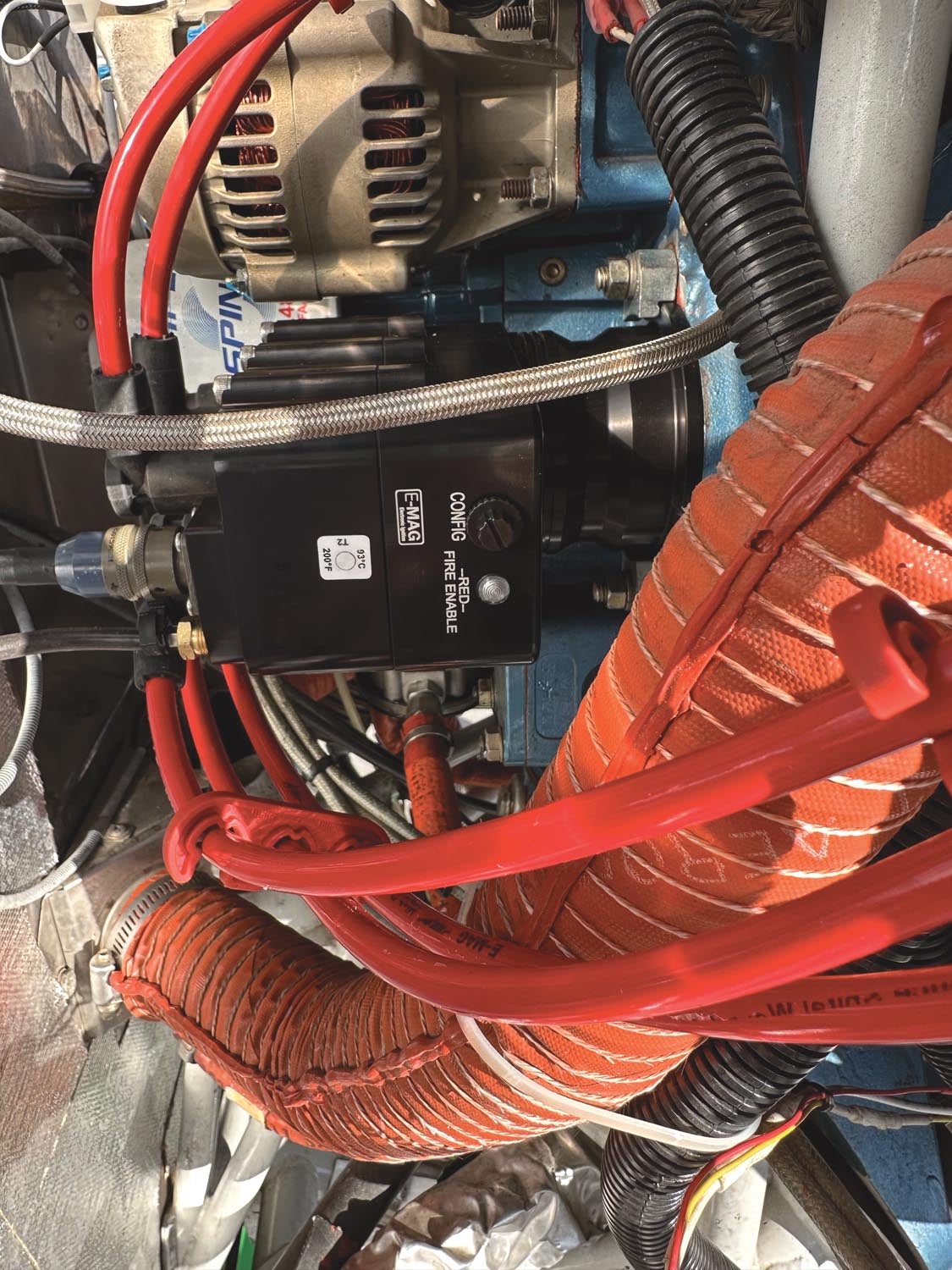

The E-MAG fits nicely in its designated space, allowing access to its harness, config button and status light.

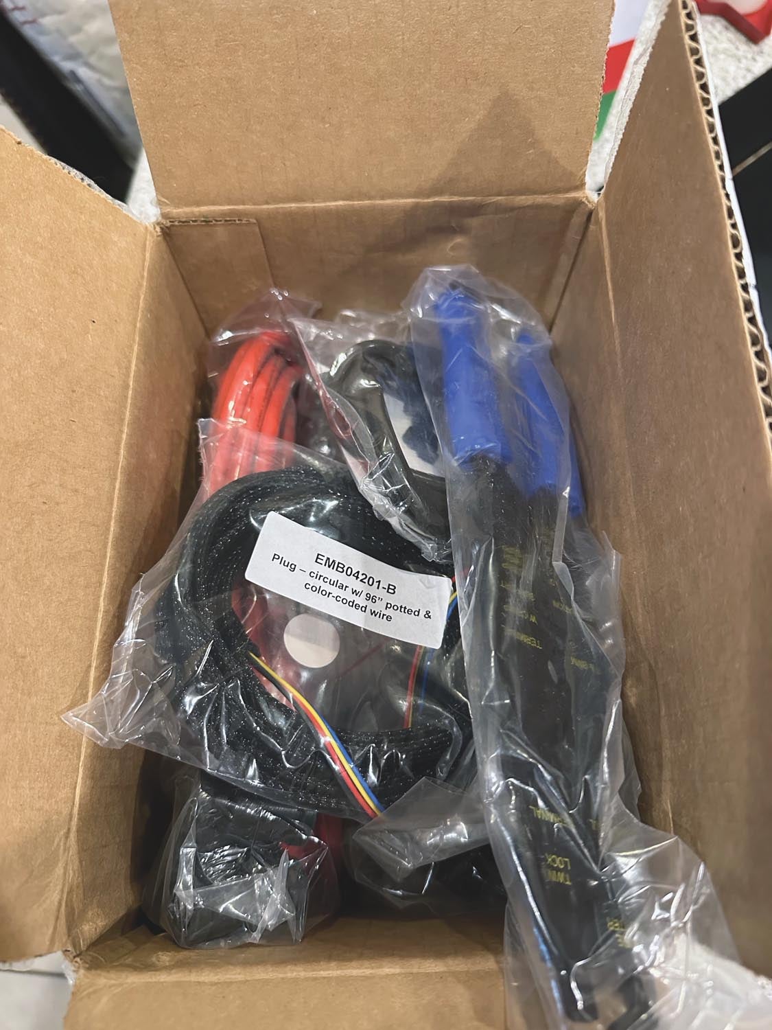

The kit comes complete, including electrical harness, plug adapters, case studs and all of the elements required
to fabricate the plug wires including the crimping tool.

Within a couple of days of ordering, the package was at my doorstep. My first impression was that everything seemed to be complete and of high quality. I anxiously gathered up everything I thought I would need for the installation. One consideration that Brad had discussed with me was that even though the E-MAG was internally powered once running, it needs electrical power for starting. They had discovered that in airplanes with long cable runs from aft batteries, like the RV-10, a dedicated 16-gauge wire from the battery to power the E-MAG is recommended. This prevents occasional power interruptions upon starter engagement. Prior to leaving to drive back up to the airpark, I picked up the wire and a 5-amp switch/breaker, which would not only protect the dedicated circuit but also provide a means to test the internal power function of the E-MAG. (More on that later.)

Even though the 28-page installation manual can be a bit intimidating at first, the installation process itself is astonishingly simple and easy. Starting with mounting the unit, if the previous mag had a spacer between the accessory case and the mag, you no longer need it, freeing up precious space. Note: If a spacer was previously installed, you will have to replace the mounting studs with shorter ones (included).
Unlike a traditional mag, the E-MAG doesn’t care what its clocking is to the accessory case mount. Just set it to where it fits the best and allows convenient access for the wire harness and a sight line to the  indicator light. I mounted mine on the right-hand position and even with my previously installed B&C backup alternator, fitment was easy.
There’s only one electrical connection to the unit. It’s a small Cannon plug that comes with a ready-made harness of four leads in a protective sheath requiring a single penetration of the firewall. (This seems to be an improvement over the terminal-strip-style connections the four-cylinder units have.) The four leads are simply power (controls start-up power to the mag’s circuitry and internal alternator), kill (controls mag output like a conventional P-lead for safe handling and run-up checks), tach (sends a tach signal to your EFIS) and ground.

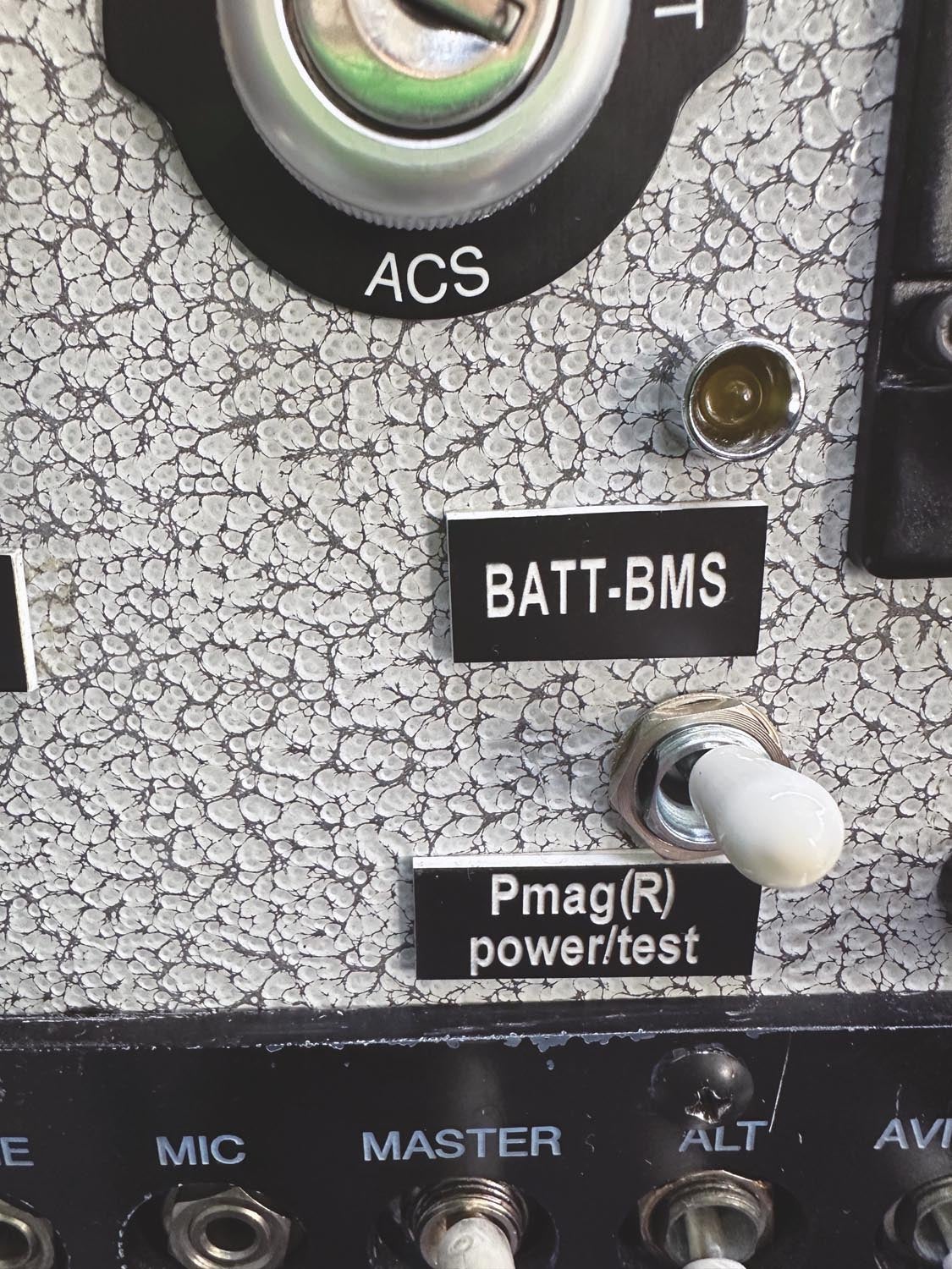

A switch/breaker on the panel provides power, circuit protection and a way to test the E-MAG’s internal power.
E-MAGs automatically use variable ignition timing of up to 9° for efficiency. For cockpit control, two switches are required for non-boosted engines (turbo or supercharged). Boosted engines require a mode switch to be able to turn off variable timing if there is a problem with the boost system (see manual). There are several ways to accomplish the electrical connections. I used the aforementioned 5-amp switch/breaker for the circuit protection and control of the power supply, plus half of the conventional ACS ignition switch for P-lead control.
The final connection for the E-MAG is a manifold pressure tap from the engine to a built-in hose barb on the ignition body. This connection is fail-safe in that it is not required for operation but does play a role in the ignition advance calculation for the unit to operate more efficiently. To that end, at a local hot-rod shop, I found a dash-4 gauge adaptor assembly that teed in perfectly at the firewall connection of my existing manifold pressure line and the Dynon interface and allowed the addition of a 1/8-inch tubing barb for a nice clean installation of the supplied pressure tubing.
